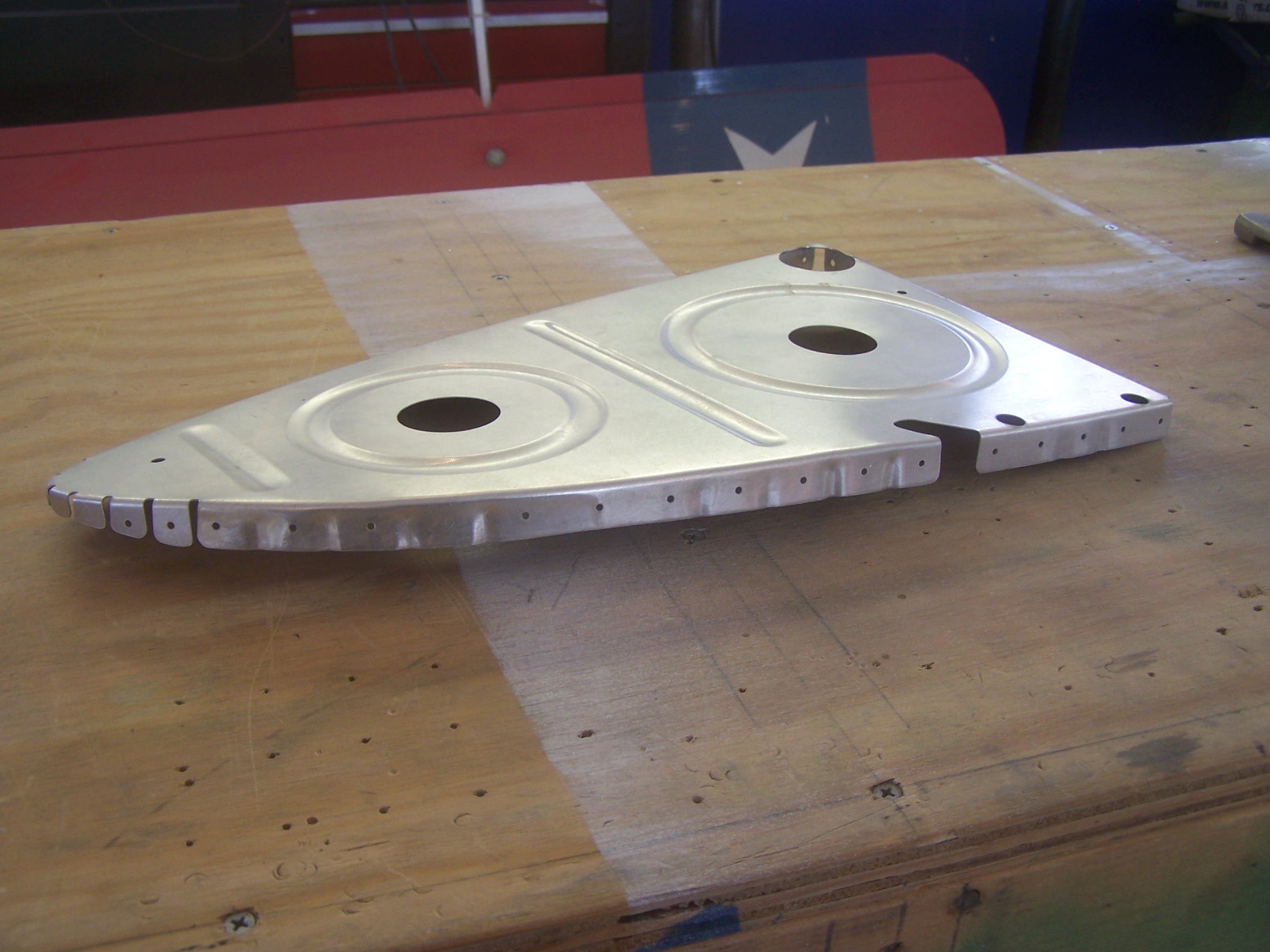

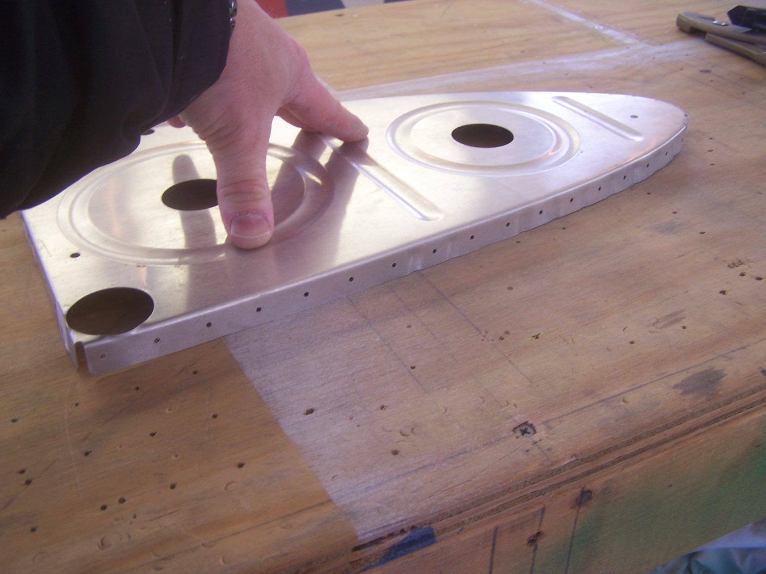

Hey everyone. I'm having an issue with fluting some ribs. Some of my ribs have a "spring" or twist to them caused by stamping them out (I assume). I cannot seem to get the "spring" out of the ribs by fluting them--no matter what I try. If I apply light pressure to the rib while on a table they lie flat but the instant I let go they spring right back so they are twisted. Am I doing something wrong??? My fluting does get the rivet holes lined up good when the ribs lie flat on the table. I've had a few in the past like this that I just installed and the clecoes very easily pull the rib into place. Is this acceptable? If not, how do I correct. I've attached a few pictures to better describe my issue.

We are in about the same spot in construction. What I did was use a straight edge down the ribs and fluted to make the rib straight and not curved like they are coming from Vans. The twist issue I do not think you can fix, but the curve can be fluted away.

If they stand up that much, I'd flute them and make them flatter.
I'm sure it could be fine if you installed them, but really,
the idea is to get that stress out of them and make them flat.
There is a technique to it, and it's easier to do or show
than speak, but once you get the hang of it, you'll have it
down. It's been a LOOONG time, but I think that the one you
have the picture of in this email probably is over-fluted,
and that's why it's bowed up. If you flute less, the length
of the bottom edge would be longer, and it would tend to
make it flatter. Picture it as a bar that you want to bend,
and if you flute one side, it bends that way. Well, you
fluted the side facing down, and when you got to a certain
point, the thing bent in a curve facing that direction.
So I'd relax the flutes and see what happens.

I found lining up a flexible 24" steel rule with the hole edges to work the best. The edge distance always varies due to the holes being punched then the rib forming. By lying them on a table you may get a straight sheetmetal edge but not a straight set of holes. The pre-punched skin holes are in a straight line so you want to have the holes in the ribs in a straight line not the edge of the metal flange. I just did a little at a time and if I overdid it just went back and took some out. After a few ribs you know just how much force to use and where.
