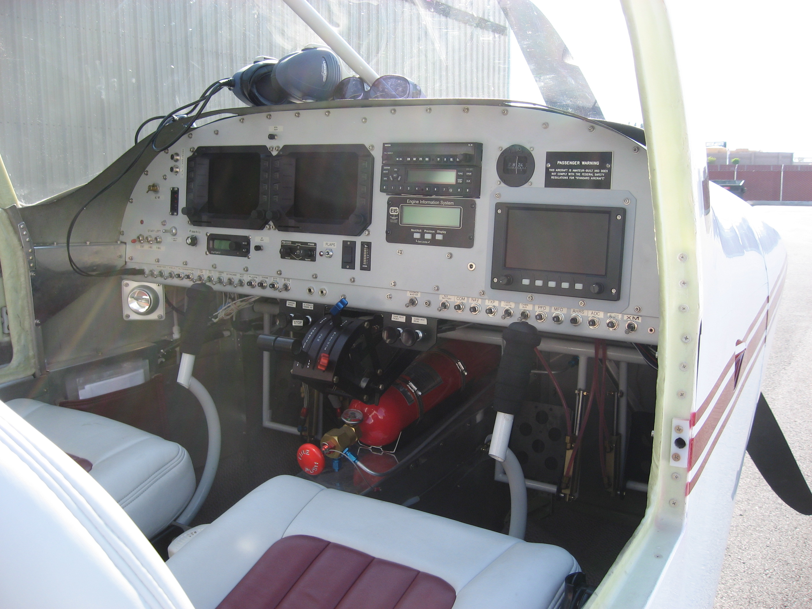

For about $500 you can also install a fire suppression system. Stroud Fire
Safety OKC
