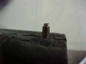

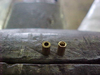

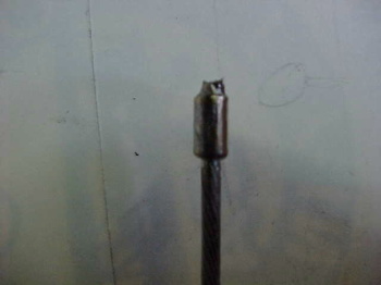

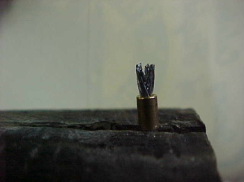

If you make up your own cables, you can easily guarantee that the cables will not pull out of the swedge. There is a countersunk end on the swedge, push the cable through so that the countersunk end is at the cable end. Push about 3/32" of cable through and then rat tail it severely with a small tool, and then pull it back in as far as it will go, it should be physically impossible to pull it through. If that is the case, then solder it.
The attached pictures ought to give you the idea.

<< Push about 3/32" of cable through and then rat tail it severely with a small tool … then solder it. >>
Jimmy –
The exact thing happened to me a few years ago, on my Mark-3. Throttle cable slipped thru the ferrule. Fortunately for me, on the 912, the carbs spring to full throttle if the cable lets go. This gave me the fortunate opportunity to fly back to my airport, enter the pattern, and shut down the engine on downwind, making for and easy deadstick pattern and landing.
Richard Pike shared the same advice with me (above) at the time , on fixing the cable/ferrule interface. It’s an excellent solution - guaranteed not to ever pull thru again. That’s how I fixed it on my Kolb.
