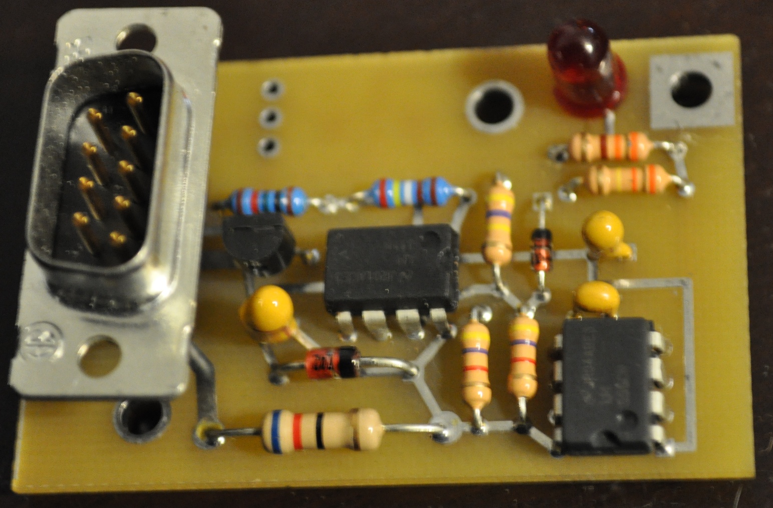

PostPosted: Tue Jan 04, 2011 4:03 pm    Post subject: Questions about the 9005 Low Voltage Module Reply with quote
Here's a picture. I think the resistors are right, but perhaps I'm
overlooking something that will seem obvious to someone with more
experience.

  I don't think so. The LM series devices are National
  Semiconductor originations. All competing manufacturers
  have to put out a drop in duplicate of the part.
  If the voltage at U107-3 had been zero or identical
  to an adjacent pin, then I would suspect a solder
  splash or an ECB defect often called a 'cat hair'.
  The fact that your measurement is unique and way out
  of whack for what the LM285 should present suggests
  that neither event is in force. You might check
  markings or color code for the R104 . . . make sure
  it.s a 4.7K and not something higher. Also re-flow
  the solder joins on R104. It's extremely rare that a
  new part is bad out of the box so if the LM285 is
  not installed wrong, we need to explore other possible
  causes for U107-3 voltage not to be 2.50 volts.

Bob, if you have any spare time, would you be interested in taking a look at this picture to see if anything seems out of order on the 9005 module?
