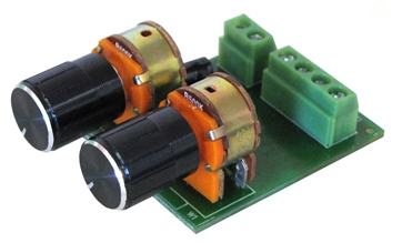

Earlier someone on the list asked about using these as LED dimmers:
http://www.aircraftspruce.com/catalog/elpages/pwmDimmer.php
Just to follow up, did anyone ever install them and have anything good
or bad to say about them? I noticed that some very similar looking
units are available here:
http://www.allelectronics.com/make-a-store/item/DMR-9/12VDC-18W-PWM-DIMMER/SPEED-CONTROL/1.html
and
http://www.allelectronics.com/make-a-store/item/DMR-10/DUAL-12-VDC-18W-PWM-DIMMER/SPEED-CONTROL/1.html
for a lower price. As Bob said before, it's cheap enough to buy and
try, (even cheaper now), but I thought I'd check first just in case.

I use one of these for my panel LED lights. It works ok. Occasionally
the lights blink on/off when the switch is completely off. Also, the
backing on the switch does not grip the panel well which tends to allow
it to spin in the hole.
It modulates the light perfectly and doesn't jump, spark or crackle when
adjusting. If you have LED lights you want to dim, you need one of these
(or a similar cousin). As indicated in the pictures it is easy to hook
up.

They will function as advertised. The only caveat goes
to the method for bringing wires onto and off the board.
[img]cid:.0[/img]

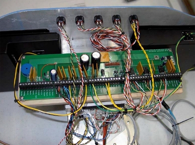

We discussed the "twist-n-squash" terminal boards
a few years back when Greg featured them on the BMA power
distribution board described on page 41 of
http://www.aeroelectric.com/articles/richter/response_1.pdf
[img]cid:.1[/img]
This tecnology for bringing wires off of etched circuit
board argues with the idea of gas-tight connections
favored with immediately adjacent insulation support
discussed in . . .
http://www.aeroelectric.com/articles/terminal.pdf

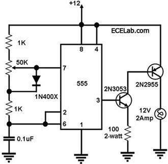

The technology for these dimmers is pretty simple. Here's
on example of a duty cycle controller suitable
for their LED or incandescent lamps.
[img]cid:.2[/img]
A dimmer of this genere could be crafted
with some really solid termination technology
(d-sub, fast-on, etc. etc). Bill of materials
is about $10.
