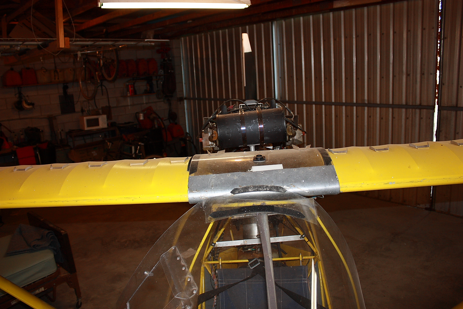

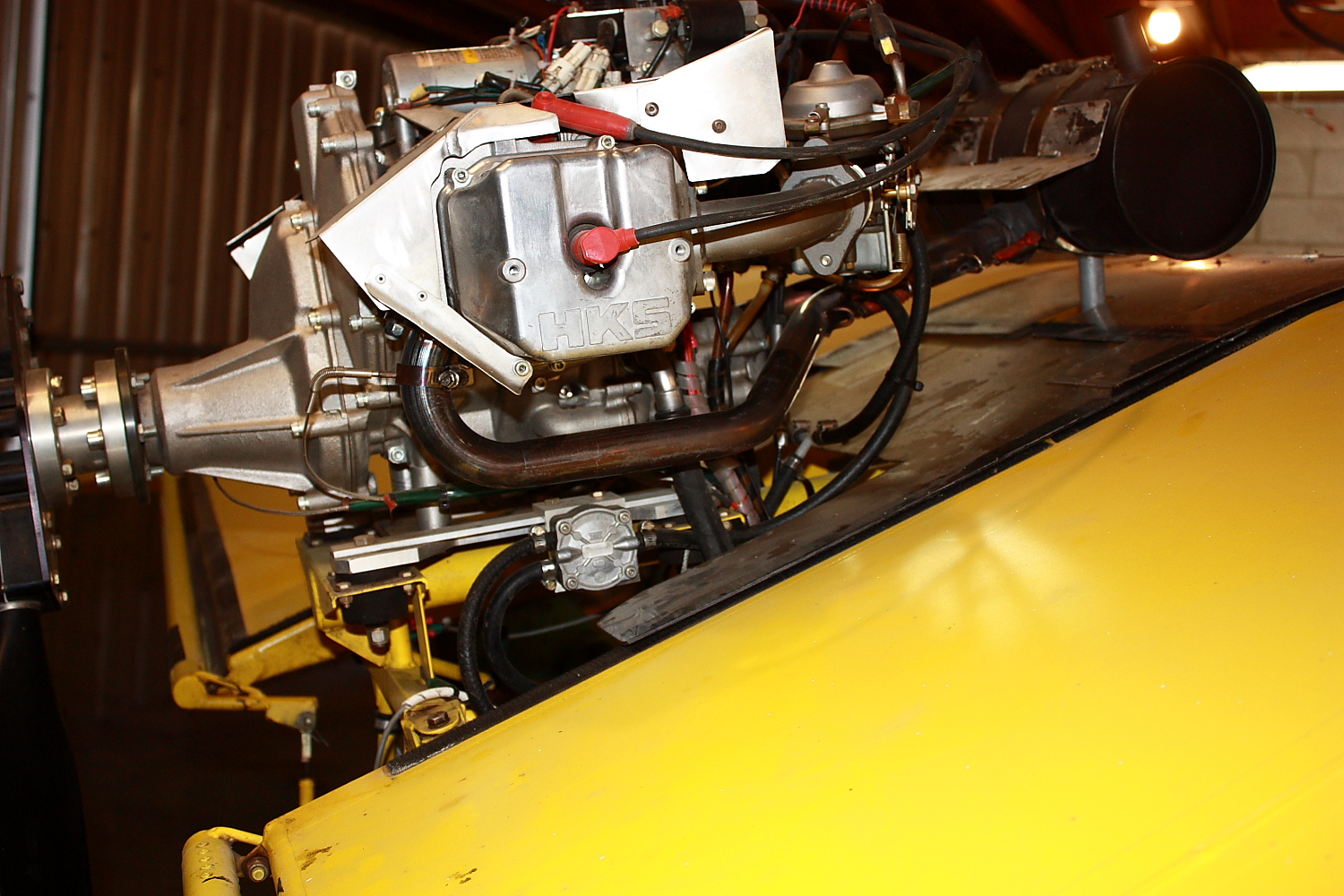

PostPosted: Thu Oct 05, 2017 7:35 am    Post subject: wing center gap seal Reply with quote
I have always used the lexan gap seal and attempted to cover and block as much of the gap area that I can. MIne has a section of alum. bent to go over the leading edge tubes. I use a small bungee cord to keep it up tight against the tubes. the sides are secured to the wings with velcro. Most of the Mark III's make up a "hard" section that slides in between the wings that consists of a couple of ribs that the lexan is secured to.
The installation of the HKS presented a problem because of the location of the muffler.
Larry

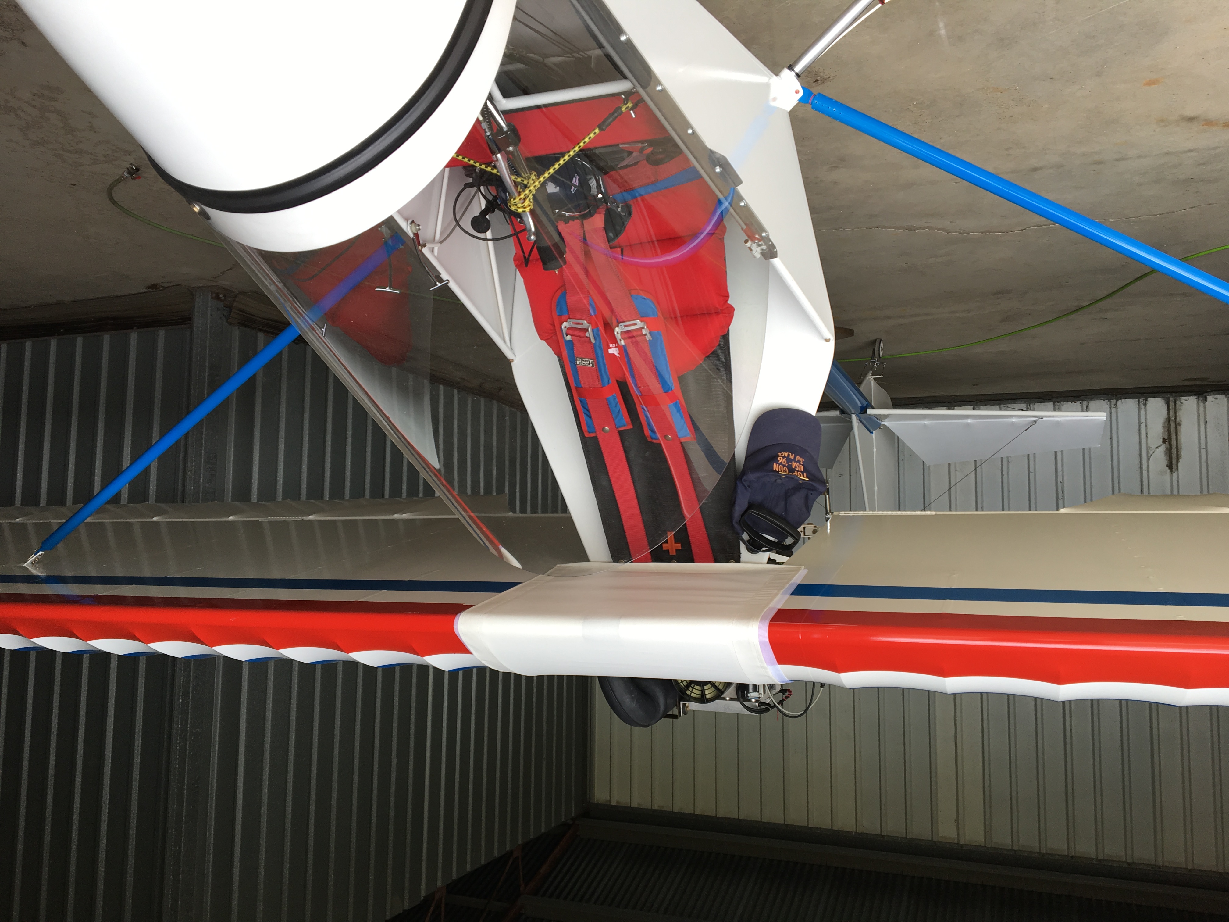

gdhelton(at)gmail.com
PostPosted: Thu Oct 05, 2017 4:39 pm    Post subject: wing center gap seal Reply with quote
I restored my original Firestar earlier this year which originally used the zipper in the middle type gap seal. I talked to Brian at Kolb and he assured me that their new Velcro on gap would work just fine. I took his advice and had Helen at Kolb make me one . It was extremely easy to install and works great. I also built a Twinstar many year ago. This new one would have great on it. That just my experience,  I like easy and availability. I’ll attach a picture
George H.
Firestar FS 100
14GDH
Mesick, Michigan
gdhelton(at)gmail.com[img]cid:15eef1d42a36e63c7bd1[/img]

ceengland7(at)gmail.com
PostPosted: Thu Oct 05, 2017 6:10 pm    Post subject: wing center gap seal Reply with quote
Well shucks; more to contemplate. Smile
Looks like either option requires velcro, so  I'll get a roll of wide stuff on order while I contemplate materials.
Thank you for the pic, and the ideas.
Charlie

On Thu, Oct 5, 2017 at 11:41 AM Larry Cottrell <lcottrell1020(at)gmail.com (lcottrell1020(at)gmail.com)> wrote:
Larry

PostPosted: Fri Oct 06, 2017 11:11 am    Post subject: Re: wing center gap seal Reply with quote
I went back to an aluminium gap seal after my cloth one shred it self. You can kind of see it coming apart in this screen grab form a video.
It was made of the same fabric as Quicksilver sail cloth. The Lexan would be nice as well.

Looks good, and relatively simple to do. The fabric just looks difficult to keep properly tensioned, so I think I'll try either the plastic or aluminum sheet.
Is your Lexan standing up ok to fuel exposure?
Thanks for both the info, and the pics.
Charlie

PostPosted: Fri Oct 06, 2017 12:03 pm    Post subject: wing center gap seal Reply with quote
If you get gas on it, it will be ugly. There is compensation in that my neck is so stiff that I can't see it when I am sitting down and I am old enough to forget that there is a problem quite soon after sitting.Larry
