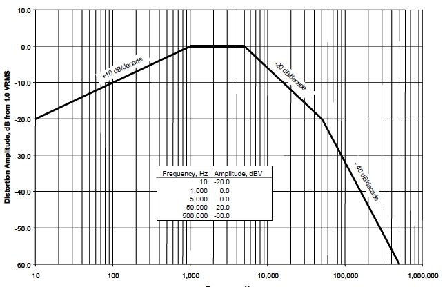

This is why Mil-Std-704 tells us to EXPECT bus voltage
excursions of 3v pk-pk over the range of
1000 to 5000 Hz on a 28v system (1/2 that
on a 14 volt system). The expected/permissible
levels drop off on either side of that band:
[img]cid:.0[/img]
Further, 704 is silent as to whether or not there is a battery
present. And it makes sense. A fully charge battery floating
on a normal bus is electrically 'transparent'.

I've never considered researching an "equivalency" . . .
It would depend heavily both on size of the battery
and its physical condition. Given that noise values
for battery-in versus battery-out are indistinguishable
from each other says that noise mitigation benefits,
if any, are insignificantly small.
