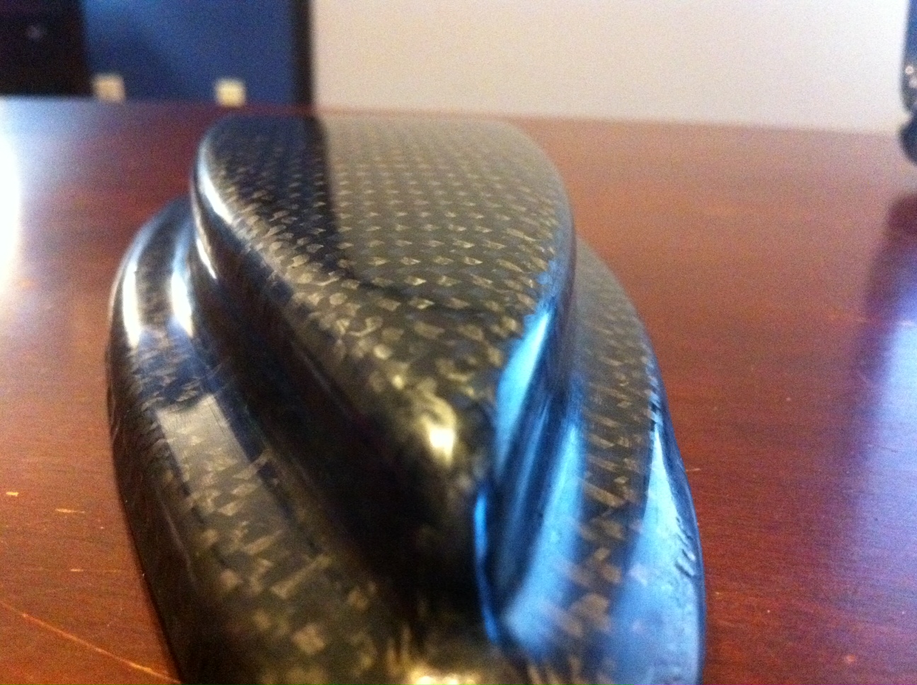

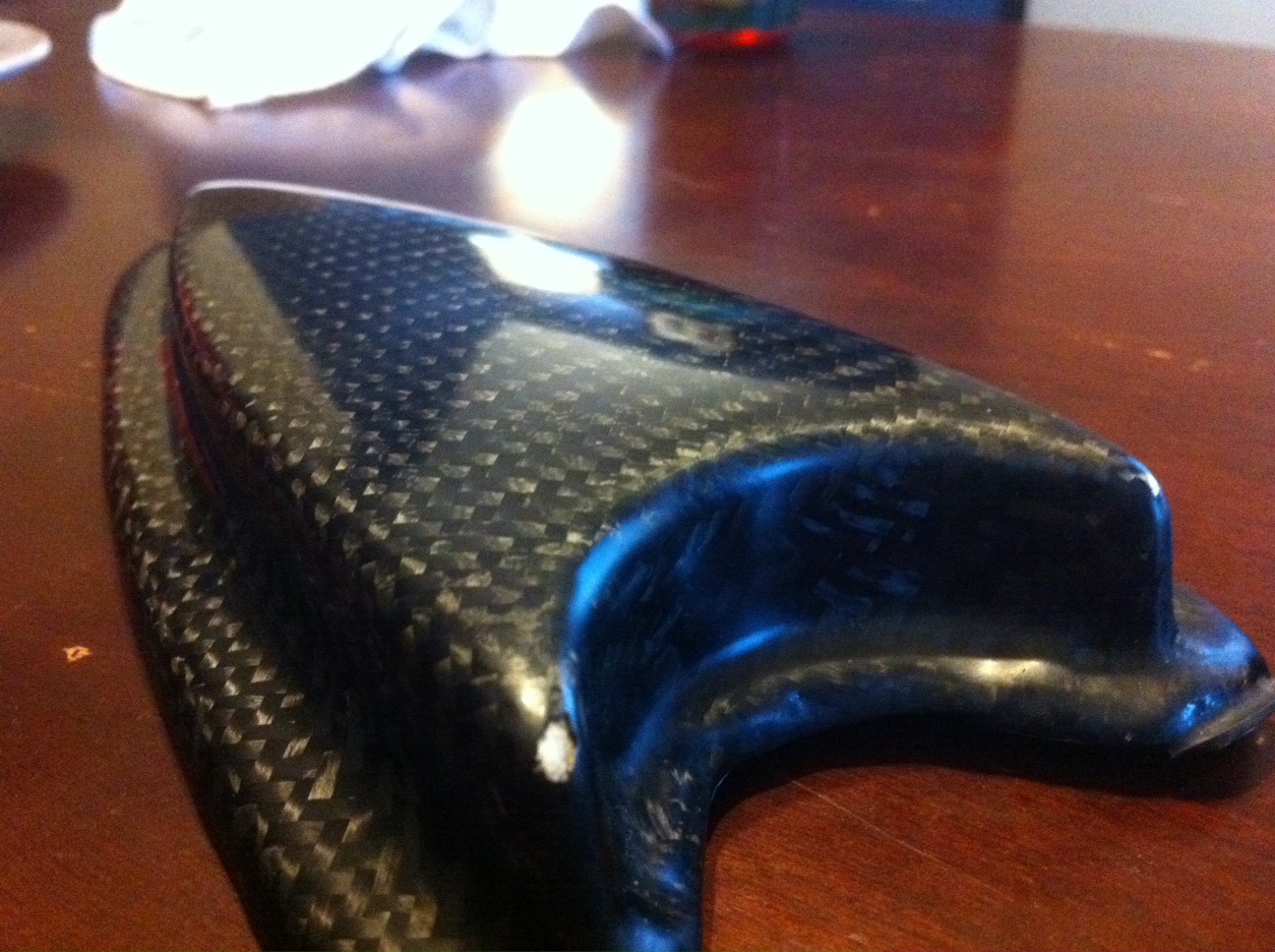

If you have seen some of my other posts you know I am trying to learn a thing or two about composites and how to use them. So here is one thing I wanted to attempt, carbon fiber coating an existing part. The unfortunate thing is that you end up with the original part plus the weight of the carbon and the resin but it should look really good when complete and it is pretty simple to do.
So here is what one of the McBeans gas cap fairings looks like coated in 2x2 twill 3k carbon. It is still raw and will look better once the resin is applied and sanded (3 thin coats). It was applied by using black gel coat as the adhesive which fills in any gaps with black. So far it has been fun to do and I will be applying the resin here shortly so maybe that will change. Just thought some of you might like the look. By the way, I may or may not use that part, I am still playing with options.
I'm guessing what you want is a carbon "looking" part as an end result.
Not sure what parts you'd do that for on a Kitfox, but it might be fun.
Now the normal process would be to take the KLLC part and stick it to a
piece of melamine and then lay-up a female tool out of gel-coat and
fiberglass. You'd then vacuum bag male carbon parts out of the tool.
This gives you a really nice finish on the outside, one that can be
lightly sanded and then clear-coated for a spectacular finish. The hard
part of doing it your way is getting a final product without bubbles.
It's really hard to get a "solid" layer of resin over weave, without
milkiness or bubbles. And you can't really keep a lot of resin in a male
part because the resin squeezes out the male corners and pools in the
female corners. One thing you might try is to put your part in a vacuum
chamber after laying on a coat or resin. This will help force out any
trapped air. Good luck!

Guy, I am experiencing what you are talking about with the pooling and thinning but I think with sanding and thin layers it will work out. This is really more an experiment then anything. As for what parts I am trying to figure that out myself. A new engine (HKS) means a new instrument panel and that is going to be carbon fiber, there is just no way around that. I feel that if there is one huge chunk of carbon right there in the middle there should also be bits of it here and there for aesthetics. I think that fairing will actually look better in a red kevlar/black carbon weave since my plane has a big ole red stripe on it. I also think that it represents me pretty well to take something as low tech as the Fox and dress it up a little with some ridiculously high tech materials that ultimately fill no function. Any suggestions on non structural parts that would look good in carbon or carbon/kevlar would be appreciated.
Question Question for the McBeans: Do you have any issues with me pulling a mold from one of the fairings I purchased from you and reproducing the part in carbon? The end result will be me having only one pair of fairings and I will destroy the mold. It is largely for practice with composites and I have no intention of having any more parts then I purchased from you, multiplying, modifying, or distributing these parts. It's just for me to play. Smile

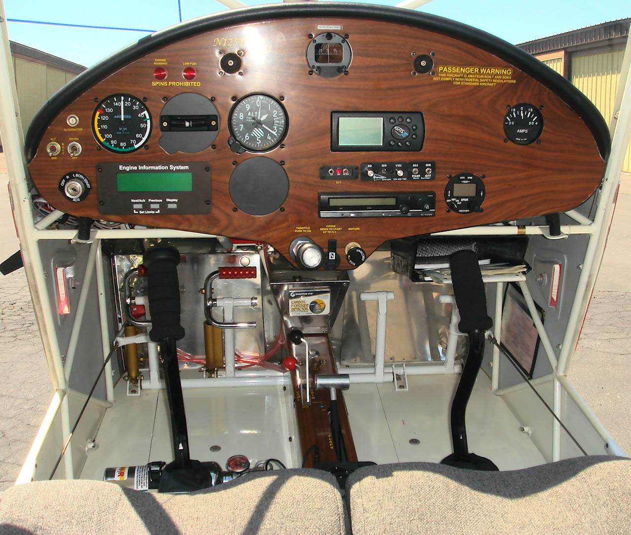

That sounds like a lot of fun projects Guy. Do you have any pictures of the molds and end products? I would love to see them. How many layers did you need to make the instrument panel rigid enough? Did you save any weight on the seat or was it primarily for the cool points?

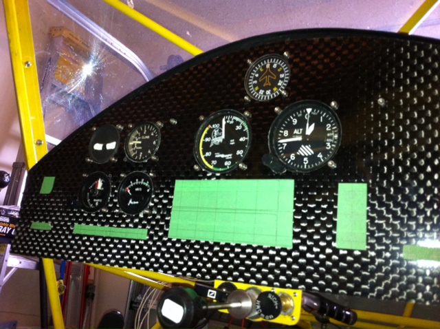

Sorry James, I'm going to be of no use to you whatsoever. The seat and
instrument panel were built by the first builder, though I know they
were made from satin, probably five harness, 300g, and probably two
layers. The seat has reinforcing bands at the tubes and under each butt
of about double thickness. The seat saved weight and eliminated the old
"seat failure" bugaboo from way back. The instrument panel and glare
shield were for stiffness and "cool points", particularly the glare
shield, since it is clear-coated. (You can't see any carbon on the
panel, it's covered with wood veneer and nauga.) I've attached a picture
of the panel and my builder's log entries for the glare shield. No good
pictures of the glare shield, though, they're all in deep storage. Sorry.

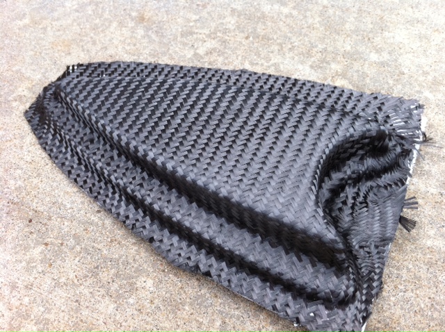

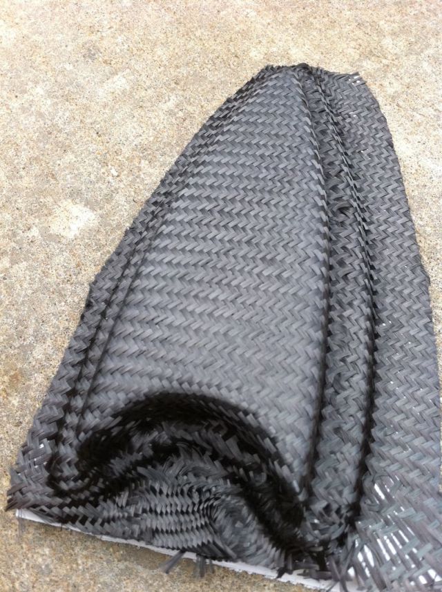

Well I am "finished" with the gas cap fairing in carbon but I can't get any good pictures right now. (here is a bad one) I will try tomorrow when the sun is out. It turned out pretty good although I sanded into the carbon a couple of times. In the end it looks good except for one nick which I will paint black. I also want to show one of the sheets I have laid up as a test panel, the weave is something else. It is a 1x1 weave made with 12k carbon so the TPI count is like 4. I plan on laying up an old piece of red carbon/kevlar tonight if it is not too mangled from a long storage and a couple moves.

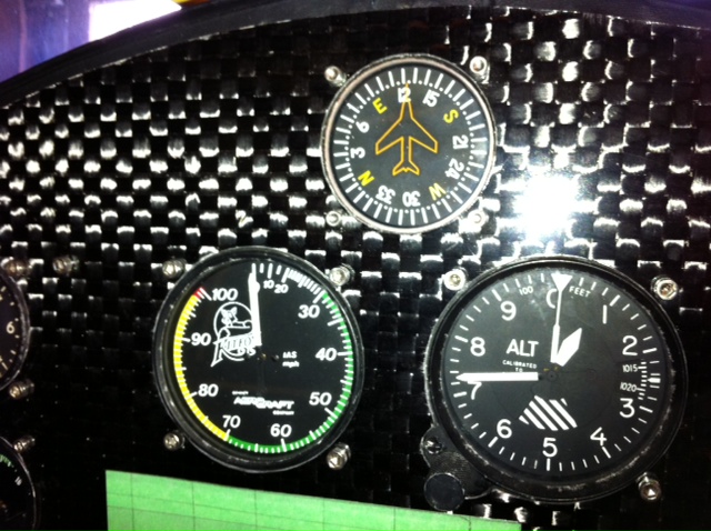

Guy, what are those two black circles on your panel on either side of your compass? I have seen those on a lot of Fox panels but mine does not have them.

WOW James,
I think they turned out pretty nice!

Unfortunately there is no THEY, there is only the one. As I mentioned this was largely an experiment so I only did one of them so I could try something else with the other. I am pleased with it but I do not thing that carbon fiber would look all that good on top of a yellow wing. Now the carbon with red kevlar weave that I have I think might look pretty good with the red stripe on the plane. We will see. I just laid up an instrument panel sized piece of the red/black. Can't wait to see how it looks.

PostPosted: Mon Apr 04, 2011 9:42 pm    Post subject: Carbon Kitfox Crafters Reply with quote
They are lord mounts that pick up the two standard Kitfox panel mounts
that drop back from the front window X-frame.

If I am not mistaken my panel is bolted directly to those mounts.

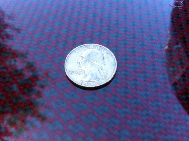

So in an attempt to make a blank for my panel I used a mirror as the mold and layed up a beefy panel of one sheet carbon/Kevlar and two sheets of carbon. I then made a kiln of sorts out of pink insulating foam sheet and powered by a heat gun. It worked great and the panel was 140-160* every time I checked it. Problem is the mirror broke from the heat. I will see whether it damaged the blank when I pull it all apart later. Here's hoping.

I finally got some time out in the garage to start pulling apart the panel so I decided to go ahead and make up a test panel with one of the blanks I made from carbon fiber. This piece was my first attempt at a full size panel lay up and was pretty full of imperfections. It is only two layers thick of carbon so it is pretty flimsy but it holds up well enough to get a good look at it. I still have green masking tape indicating where things will be installed such as switches, VHF, Xponder, fuses, and the EIS will go in the big blank spot on the right. I have spent a few weeks trying to lay out an aesthetic and functional panel and as many of you know that is not at all easy. I am happy with this layout and think I will only tweak it a little once I finalize what fabric I will be using. The first picture is the fabric I want to use if I can find more of it. I got this piece off Ebay about 7 years ago and I can not find it anywhere. And that is what I have been doing with composites lately.

James, Looks great. What resin are you using? Keep us posted on source you find for carbon fiber cloth.

I finally got some time out in the garage to start pulling apart the panel so I decided to go ahead and make up a test panel with one of the blanks I made from carbon fiber.  This piece was my first attempt at a full size panel lay up and was pretty full of imperfections.  It is only two layers thick of carbon so it is pretty flimsy but it holds up well enough to get a good look at it.  I still have green masking tape indicating where things will be installed such as switches, VHF, Xponder, fuses, and the EIS will go in the big blank spot on the right.  I have spent a few weeks trying to lay out an aesthetic and functional panel and as many of you know that is not at all easy.  I am happy with this layout and think I will only tweak it a little once I finalize what fabric I will be using.  The first picture is the fabric I want to use if I can find more of it.  I got this piece off Ebay about 7 years ago and I can not find it anywhere.  And that is what I have been doing wit!
I like it a lot. I particularly like your use of tooling cloth, it's
much more interesting than the usual plain weave or satin. I'd probably
tone down the gloss, though. (Man, that Kevlar is wild. I've never seen
anything like it.)
