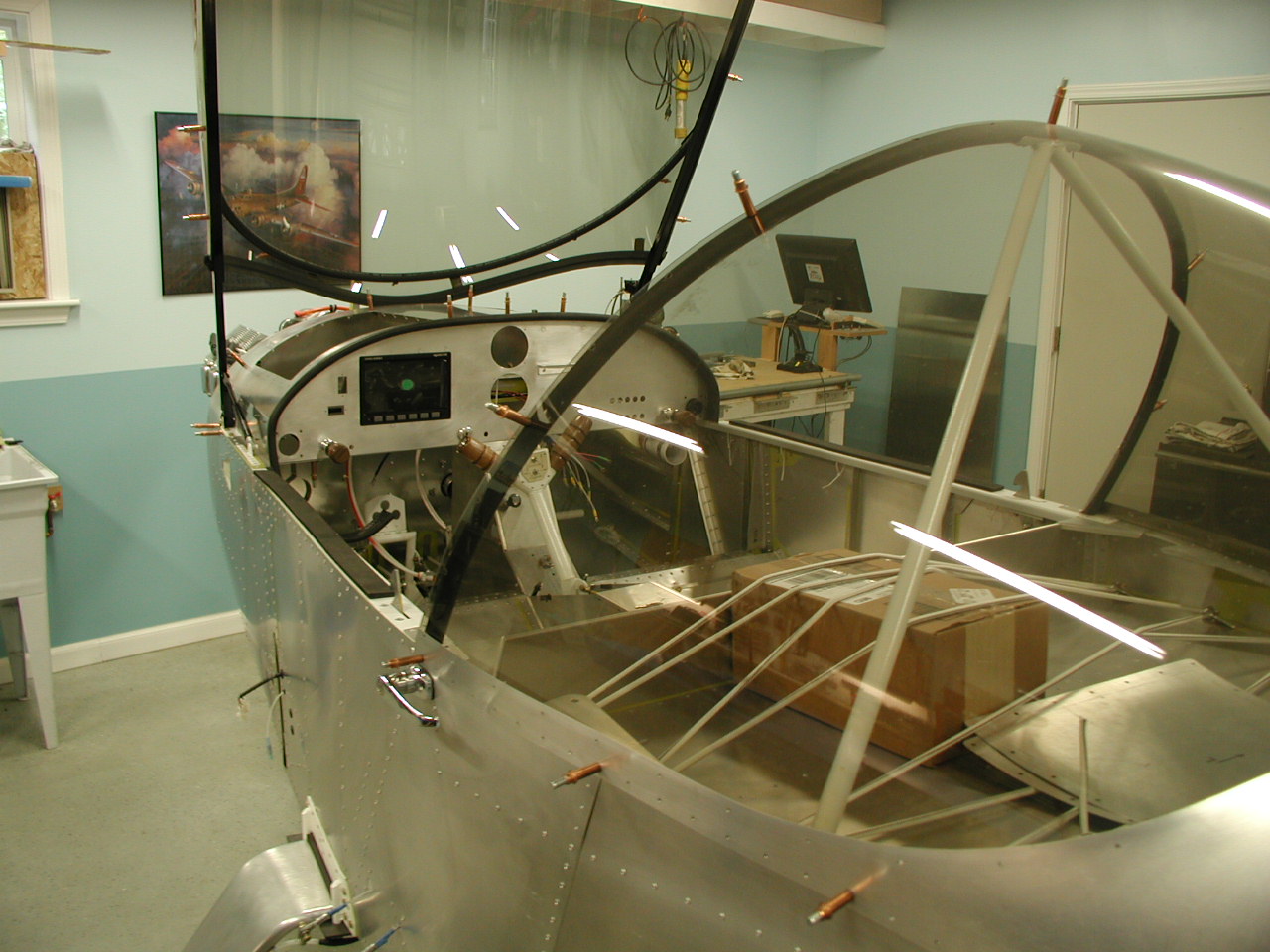

chuck960
Joined: 11 Mar 2009
Posts: 44
Location: PA
PostPosted: Mon Jan 03, 2011 10:40 pm    Post subject: Re: 650 Canopy/650 Canopy Upgrade Reply with quote
Whats wrong with you guys? My 650 canopy fits quite nicely. Looks good too.
Well actually it is the second plexy as I ruined the first one, (Expensive mistake) and I broke one of the hoops and had to bend a new one from scratch. And it's not really finished yet as it's clecoed together.
In hindsight I think the one piece of information I needed that may have enabled me to do it right the first time was this. THE HOOPS MUST BE BENT TO MATCH THE NATURAL SHAPE OF THE PLEXYGLASS. The hoops in my kit were not even close in my opinion and I thought the plastic would give a little. Not!!
Also there in only one way it fits. I mean you can't trim too much off one end and make it up on the other. But it does fit well if done correctly.
I was upset but maybe it's just that I needed a practice piece to figure out how to do it well.
I wonder how many hours ZAC spent on the phone over the years trying to explain how to do a canopy.
A few hours spent putting together some instructions would have been time well spent.
Chuck
