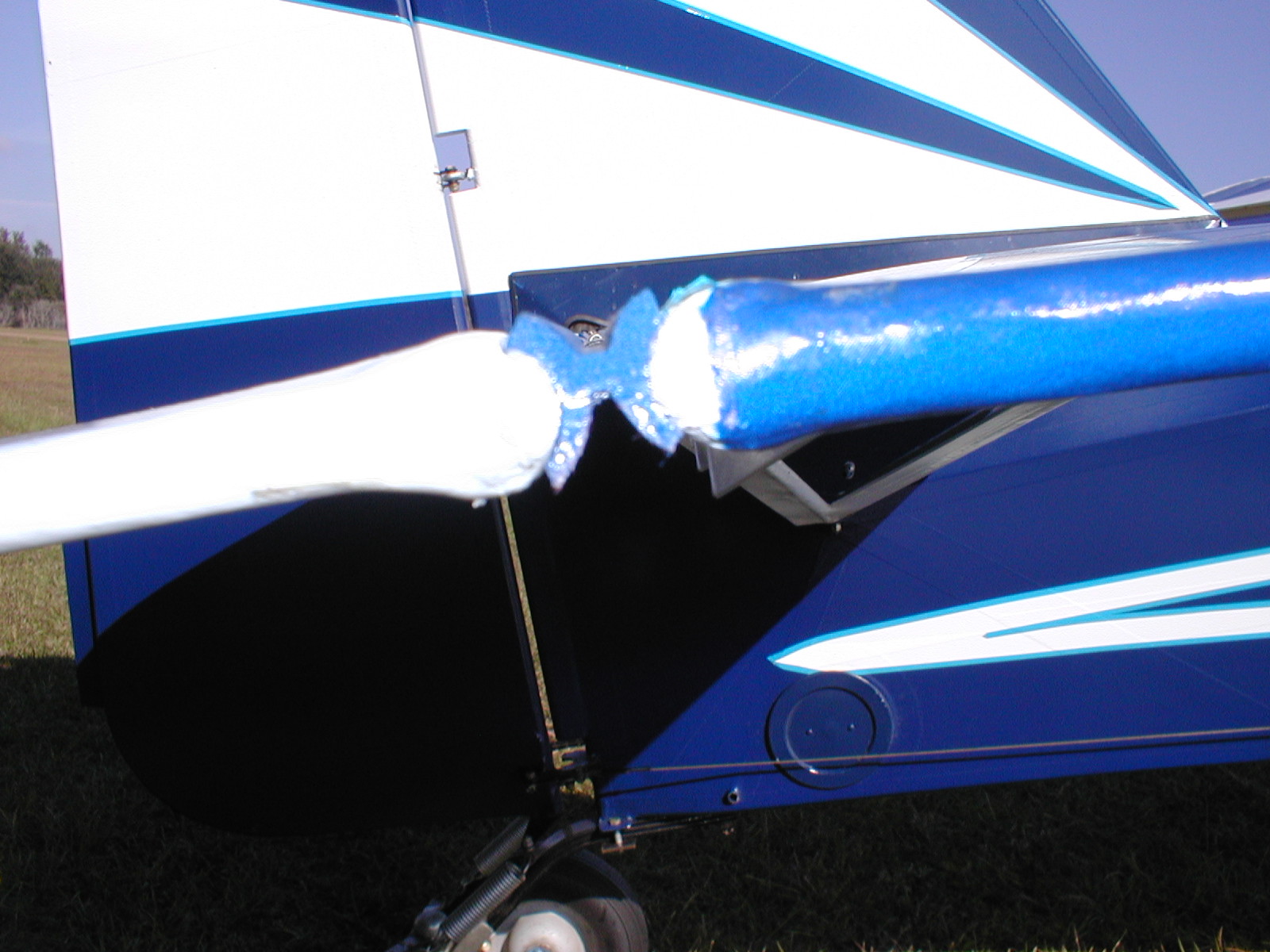

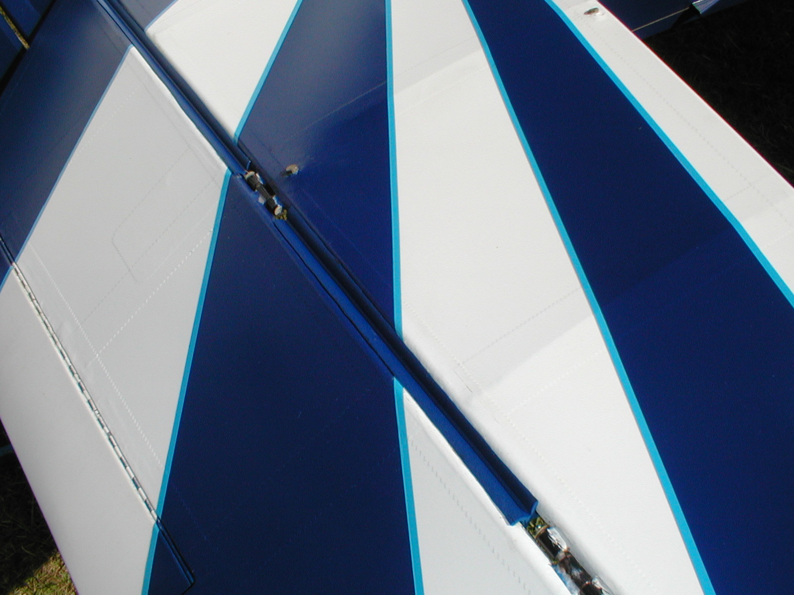

I have never been happy with using tape as a gap seal on my elevator as it invariably wants to shrink, glue gets hard,etc. I have used three types of tape including the ski tape recommended here. None of it lasts long and it looks bad (at least in my mind)
Well. while going thru a flea market I found a 5 ft piece of blue rubber stripping that turned on end looked like a dumbbell ( O-O ) I bought it for a buck not knowing what to do with it but then when I got back to Fl the idea hit me that I could cut the O's in half vertically and slide it in for a gap seal between the stabilizer trailing edge and elevator leading edge. The stuff was made of a foam type rubber and about 2 1/2 inches wide. The guy that sold it to me had no clue what it was used for. I only bought the one piece and the guy went back to Fl for the winter so I can't get anymore. When he returns in the summer and if he has more I will buy it all. The stuff is fantastic !!! It fills the gap perfectly and is a piece of cake to install and looks like it is made for the plane. My airplane is blue so a perfect match!
Maybe one of you guys might know what this stuff is and where to get it. I know once you see it installed you will want it.

How about photos of the material and installation?

Dick Maddux
Joined: 24 Jun 2008
Posts: 516
Location: Milton, Fl
PostPosted: Thu Nov 26, 2009 5:40 am    Post subject: Re: elevator gap seals Reply with quote
Here are a couple of photos of the gap seal material installed.

That does look perfect on your plane, doesn't it?
I wonder if it comes in YELLOW, hmm. . .
