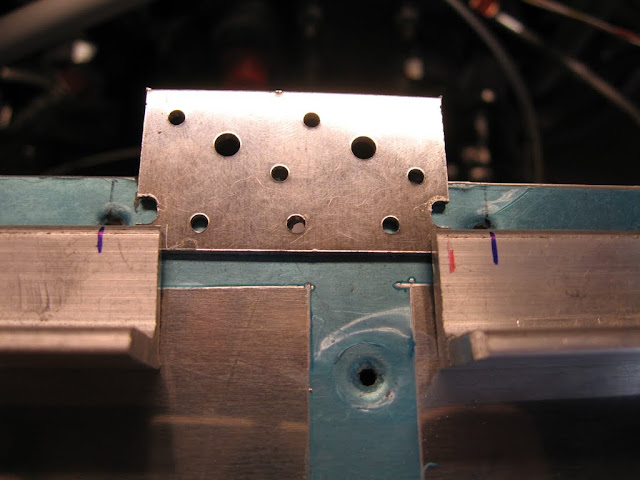

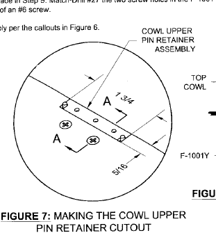

On page 47-7, (picture attached) the upper cowl pin retainer I have doesn't fit between the hinges. Thus, I need to trim a slight bit from each hinge, for the retainer to fit in between. Also, my pins will not fit in the pin cutout area, so i will be trimming that as well.
Thus, just curious if anyone else encountered the same issue? I double checked all measurements. Just seems odd for such an intricately designed part to actually not fit.
Jae

In this case, i don't think the cowl is the variable.
The plans have you drill a reference starter hole on the F-1001N left and right hinges, which match up to holes in the forward top skin right in the center.
If i measure everything out, the retainer doesn't fit between the angles which represent the hinges in this photo here: http://lh6.ggpht.com/_E3nI7J8M6Iw/TRlZt1ixKSI/AAAAAAAACLk/UFfV-fc9DhU/s640/IMG_0059.JPG The lines do line up with the holes, just a parallax issue.
It just seems odd, since the retainer could have been made narrower to fit, or the measurement on the reference hole could have been made to fit as well.
Just wanted to double check before i started cutting my cowl hinges, which i worked so hard to get to this point! Wink
Jae
40533

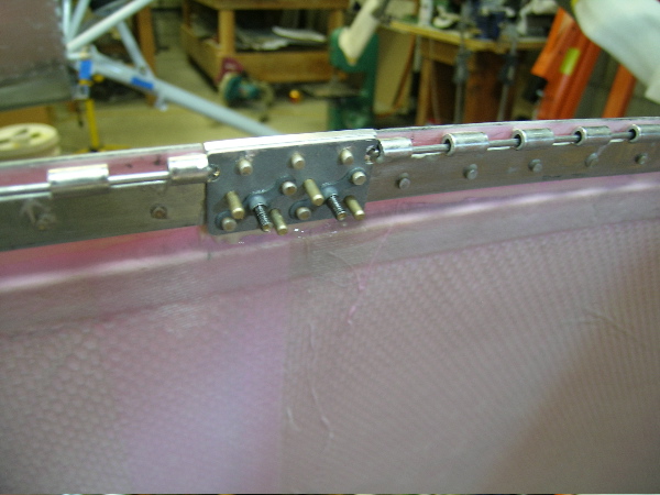

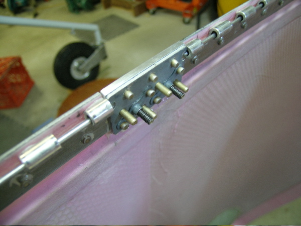

Also Know that the engine is also pointing toward the right so the left side of the cowl is longer than the right side.
I made some modification to my top cowl pin retainer mechanism so that it slides down very far out of the way on those lone rivets and when I rotating the screws the mechanism raises up and locks the pins in the cut out.
