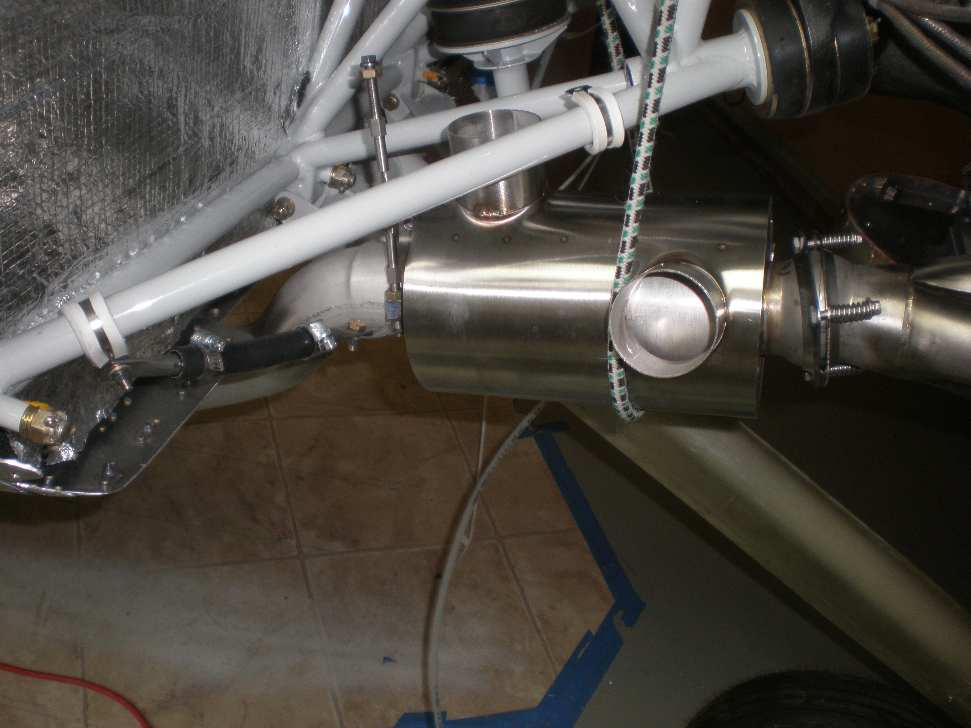

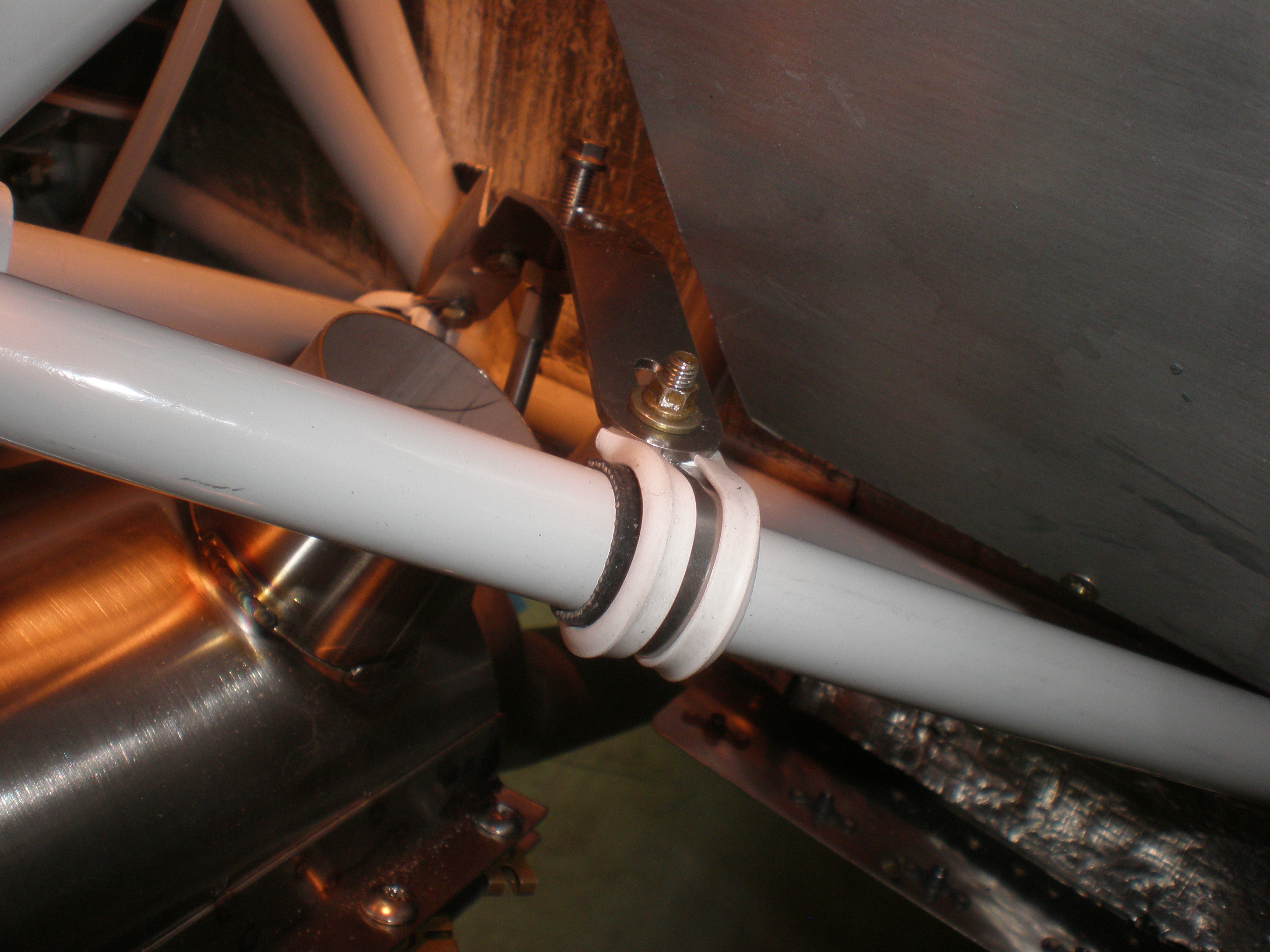

PostPosted: Wed Dec 29, 2010 4:41 am    Post subject: Where is the FF-1015 Muffler support bracket? Reply with quote
pics. If you need more pics - email me direct.
