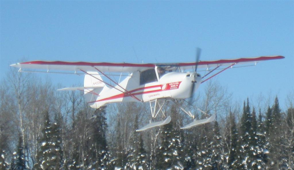

That is a great pic of your avid on skis. Would you mind if I post it on my website, www.SportFlight.net . Im still looking of some great light sport pics. If you have any other pictures of your plane you would like posted I would be more then happy to add them as well

Hi Kirk, feel free to use the picture, or if you like I can send you the original (not downsized) image.  Let me know what address to send it to if you want it.  Take care,  Jim Chuk   Avid MK IV flying  Kitfox 4 building,   northern Mn

Thanks Jim. I have added the picture to http://www.sportflight.net . I listed it as an Avid model A but I was guessing. Is that correct? By the was if you want to check it out you can search the site by N# or aircraft type

Hi Kirk,  Actually it is a MK IV.  It has a Jabiru engine.  I'll have to go take a look at your website.  Take care,  Jim

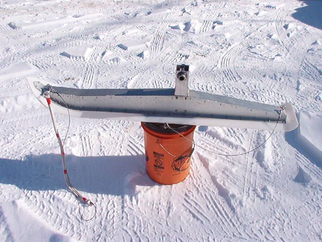

I'm curious about your skis....are they homebuilt? I just finished up
the "spats" for my HB skis, and they look similar to yours in that
they will allow for no (or minimal) snow buildup on the tops of the
skis. I'm reinstalling them today, minus paint or even a smooth
sanding of the fiberglas material that I built the tops from. I
figure this will be the worst case scenario, and when the 45-degree
temp hits us (Lower Michigan) next Friday, I'll have some time to
remove them, and smooth and paint the covers. It was a lot of work to
make the covers, which weigh 20 ounces each, but from past flight
with no covers, I'd be carrying around 3-4 pounds of snow on each
ski, so it was worth the effort. Also, this should preclude me having
to brush or blow the snow off the skis before putting it back in the
hangar.

Hi Lynn,  yes the skis are my own invention.  I've built 6 or 7 sets for myself and others using this design and it seems to work fine for me.  I fly from my home strip so I don't have to take off or land on blacktop so that's why I went with straight skis.  Here is a picture closer up.
Take care,  Jim Chuk  Avid MK IV flyng

Thanks, Jim....I just put mine back on today, but no flight due to
strong crosswind. Tomorrow, perhaps.
I was going to use aluminum like you did, but felt that 4130 tubing
was better suited for my skis that retain the wheels. It also makes
it easier to install...it took me just 11 minutes to attach the skis,
and safety the 8....yes, 8 cable connections, plus the 4 bungy cords.
Double everything on cables and bungy cords, per my flight
instructors' "instructions". He made a good case for redundant
