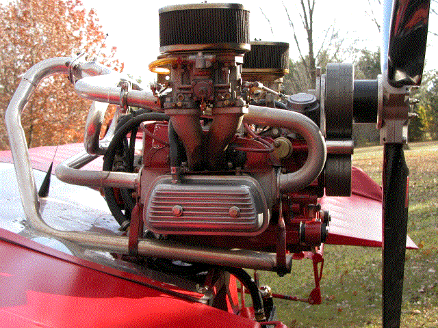

Rick I went to one of the prop sites where they have that Mach number calculator for the prop speed. It showed that the tips on the 68 inch blade will not go supersonic at full power I think it was 3400 rpm direct drive. Why wouldn't it work?
You have one on your Kolb with an RDU do you have a photo in Profile that I can look at? I want to see what your install looks like.

captainron1(at)cox.net
PostPosted: Sun Dec 26, 2010 9:13 pm    Post subject: Sonex or GP VW. Reply with quote
Printed out the photo. Is that a tuned exhaust?
neilsenrm(at)gmail.com
PostPosted: Mon Dec 27, 2010 7:56 am    Post subject: Sonex or GP VW. Reply with quote
Ron
Yes. I purchased a dune buggy tuned exhaust system, cheap and why reinvent anything. I then modified it to fit, trying to keep all the tube lengths the same. I removed the muffler and replaced it with a open pipe. I then sent it out to have it ceramic coated inside and out. I think the system gives me more power and is surprisingly quiet. The exhaust system was built for the engine on its high mount. When I later did the lower engine mount to lower the thrust line, the exhaust extended down into the gap seal a bit.
The system has almost 400 hours on it with no cracking so far. The standard VW joint between the J pipes and the tuned system got loose after a few hundred hours but is was a simple matter of buying a new joint kit and replacing them. My theory is the standard VW exhaust pipe joint allows some movement in the exhaust system to reduce stress on the system yet seal any leaks.
