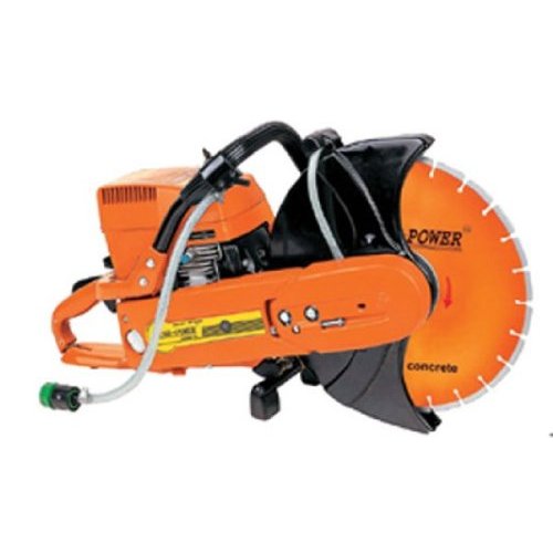

PostPosted: Tue Dec 21, 2010 9:07 am    Post subject: Trimming Fibreglass Cabin Top Reply with quote
Oh… Patrick is Australian…
That’s Australian for Fiberglass Trimming Mate!
Robin
