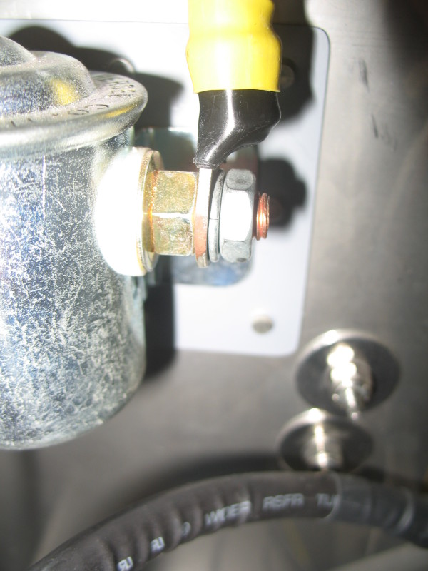

On the out going post of the master relay I feed the start relay and the main bus feed. In the attached photo you can see with just the fat wire going to the start relay it takes up most of the room on the post. I know most of the Z-diagrams show both connected to the master relay. How do you guys get another lug on there? I could leave off the lock washer but then how do you keep it from coming loose?
One guy told me I could remove the nut that snugs up against the relay, but to make sure the post does not turn, one could replace this with a shorter nut and get more room that way. Not sure I want to risk moving the internal part, might work for a while but this could cause unknown issues.
More weight and parts but I guess I could connect the relay to a fat buss bar (maybe ANLs), then connect the start relay wire and the main bus feed wire to each.
So please let me know how you others solved this issue.

PostPosted: Wed Dec 15, 2010 12:35 pm    Post subject: Battery Relay post too short Reply with quote
The nuts in that picture are reversed. The thicker nut should go on the
outside.

PostPosted: Wed Dec 15, 2010 2:17 pm    Post subject: Re: Battery Relay post too short Reply with quote
outside.
Bill B
Hmm, that is the way the relay shipped to me from Van's. Reversing the nut would not give me any more room on the post.

PostPosted: Wed Dec 15, 2010 3:48 pm    Post subject: Battery Relay post too short Reply with quote
> outside.
> Bill B
Yes it will, try it!
Roger
bicyclop(at)pacbell.net
PostPosted: Wed Dec 15, 2010 9:43 pm    Post subject: Battery Relay post too short Reply with quote
Two thin nuts would do it.

PostPosted: Thu Dec 16, 2010 7:57 am    Post subject: Re: Battery Relay post too short Reply with quote
The following links and for that matter, the entire website is very interesting. The information and data clearly demonstrates how ineffective split lockwashers are and in some cases the bolt/joint is better WITHOUT the lockwasher. (Look at the graph).
http://www.boltscience.com/pages/vibloose.htm
http://www.boltscience.com/pages/hel...ingwashers.htm
AND the video.....
http://www.boltscience.com/pages/jun...ringwasher.htm
The above is a quote from Marty S. that was posted on VansAirforce. Split ring lock washers are not frequently used on aircraft because they do not always work. Nord-Lock washers are a much better choice.
For the contactor post, you are better off using blue Loctite. Loctite will solve two problems: loosening and room for ring terminals.

PostPosted: Fri Dec 17, 2010 4:14 pm    Post subject: Battery Relay post too short Reply with quote
Lockwashers don't lock anything . . . especially when
you've got the overhang moments of the fat wires.
NO, NO, NO . . .
Correct.
Leave the lockwasher off. If you're confident of the
final positioning of wires, use a mild thread-locker
on the top nut. Otherwise wait until after your
fly-off. But risks for loosening are very low.
It would be really nice if they'd use a thin nut
against the case. It's not a big participant in
keeping things connected after all the nuts are on.
But taking that nut off event to replace it is to
risk mis-alignment of internal parts.
http://www.aeroelectric.com/Pictures/Contactors/S701-1a.jpg
In fact, it's REALLY a good idea to use a wrench
on the bottom nut to counter act torque for
final tightening of the top nut.

PostPosted: Sat Dec 18, 2010 3:01 pm    Post subject: Re: Battery Relay post too short Reply with quote
Thanks everyone for the inputs, I will try the Loctite idea.

PostPosted: Sat Dec 18, 2010 10:28 pm    Post subject: Re: Battery Relay post too short Reply with quote
I have the same issue. I am planning to chuck the washer and outer nut for a NAS 21042 self locking small profile nut. That should leave room for two connections and self lock, but I need to order some to be sure.

PostPosted: Sun Dec 19, 2010 3:48 am    Post subject: Battery Relay post too short Reply with quote
Be careful, I think Loctite comes in 3 grades. (You need to check!!)
Red, Forever, 600F to break it loose.
Blue, Not quite forever
Green, Pipe sealant
Richard Reynolds

PostPosted: Sun Dec 19, 2010 7:38 am    Post subject: Re: Battery Relay post too short Reply with quote
I believe that you have a series circuit of heavy wire between BATTERY to BATTERY RELAY to STARTER RELAY to STARTER. Electrically, there is NO difference between the output of the battery relay and the input of the starter relay. If the stud on your starter relay is slightly longer, simply move the extra cable over to the input side of the starter relay.
The stud on your present BATTERY RELAY (master relay) seems abnormally short. If it were mine, I would probably just spring for another $25 relay from Aircraft Spruce (after asking them to confirm length).
If you wish to use thin nuts, you can do so without damage by marking and closely observing a line placed on the stud tip with a felt tip pen to monitor any rotation. Double nut the stud at the tip and tighten, leaving small space between the double nuts and the inner (thick) nut. With a box wrench on the outer double nut, loosen the original inner nut next to the relay housing using an open end wrench WHILE WATCHING FOR ANY ROTATION by monitoring the ink line.
There is no reason that the inner (stud locking) nut needs to be thick. In fact, a thin brass nut might help for electrical conductivity.
I do not believe that the previously mentioned NAS21042 nuts are available in coarse (NC) thread. A light grade of threadlocker might work, but sure as heck if you use it, the connection will have to be undone TOMORROW and now residue is imbedded in the threads. Upon disassembly when using threadlocker or locknuts, you are much more likely to cause stud rotation, even with the inner jam nut in place. In any case, mark the stud end with a felt tip pen.
Lock washers don’t work only because they need to be replaced with new every time they are removed. If you are in the field and must reuse lock washers, at least check to see that they are not flattened. Split ring lock washers eat hell out of everything they touch. My preference is for MS353333 internal star lock washers with one AN960 light plain washer under the star (AC 43.13-1B, page 7-15). Besides, the star lock washers are thinner than split ring types.
