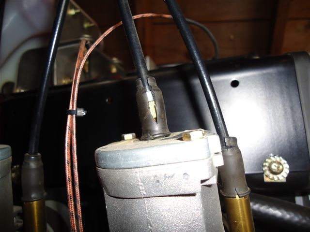

The grommets on my throttle/ choke cables are all cracking on my 2006 Kolb Firestar II. I'm the second owner of this aircraft, so my question is this ...can I replace these cable grommets myself or do I need an A&P to do this to make it legal?
If I'm able to do this, I would appreciate some expert advice.

Anyone can work on an experimental aircraft, you just can't do the annual conditional inspection without some kind of certificate.This is an easy job to do, after you do it the first time. Take a picture of the assembly before you take anything apart so you'll have something to refer to when reassembling.
The hardest thing on both is to compress the springs, especially the starting carburetor (choke), when reassembling. Once your fingers are trained it hold the springs in compression while you guide the cable stop into its pocket you're set.
While you're doing the carburetors be sure and check the condition of the needles and clips. The needle should not spin in the clip. If the clip is loose you can tweak it with a pair of pliers, if the needle land is worn, replace the needle and clip.
Get your new grommets from JBM, they're better than the Rotax. After everything is back together smear a little lithium grease around the grommets to keep them supple and make them last a little longer.

Wouldn't you want to come from the other direction to replace those (take the wire out of your splitter)?

Dana is correct as is Rick Girard. So anything you hear or read contrary to what is written in the actual current regulations is incorrect. You can find the following at
http://ecfr.gpoaccess.gov/cgi/t/text/text-idx?c=ecfr&sid=780339ea932f98232855a65df3d96916&rgn=div5&view=text&node=14:1.0.1.3.21&idno=14#14:1.0.1.3.21.0.363.1
or
http://tinyurl.com/24o4skl
Note in particular 43.1 (b) and (b)(1)

Cristal, I'm not sure how you could do this if your throttle and choke cables have terminations on both ends. The splitter has threaded plugs on both ends so the cables would get all twisted up as the threads are both right hand. It might work for cables that clamped by a set screw but if the cable slips up inside the housing, and the ends are frayed or splayed they get caught if the end cover. When you disassemble from the carb and starting carb ends you get the advantage of being able to inspect the the cable termination, the condition of the cable, the o-ring on top of the needle clip, the condition of the needle grooves and how the clip fits. For the starting carb you also get to inspect the rubber face of the plug to make sure it is sealing correctly.
