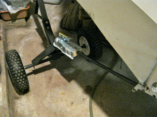

That should work provided the road is smooth. Remember humps will cause bumps in those wing leading edges.
The firefly and firestar don't have too much weight to contend with.
For security I stuck a trailer hitch on a steel rod to tow my MkIII by tractor. (wings off) That is a harbor freight tow dolly for pulling it into the
basement.
Never try to tow a MkIII with the wings folded. Good for pushing into and out of a hangar only.
For one you will be permanently crippled after you try to lift it. Secondly, the weight will bend the stock aluminum
tail rod after some jouncing.
