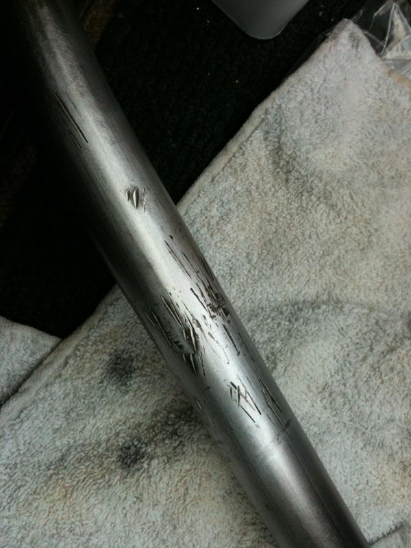

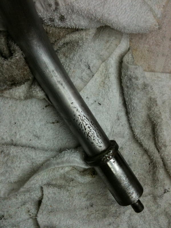

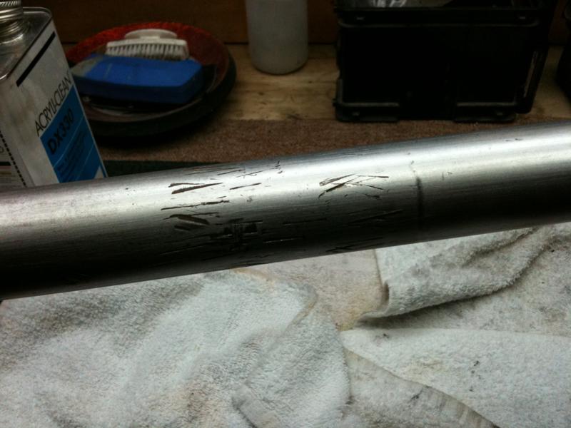

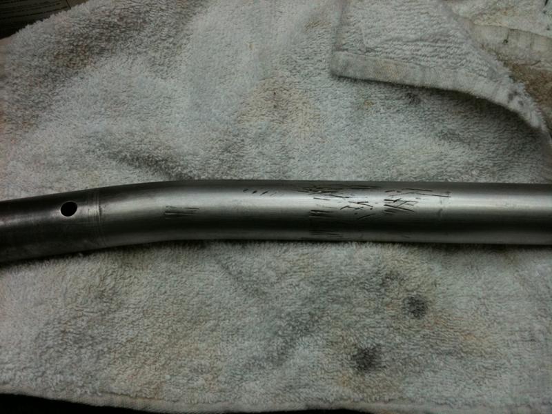

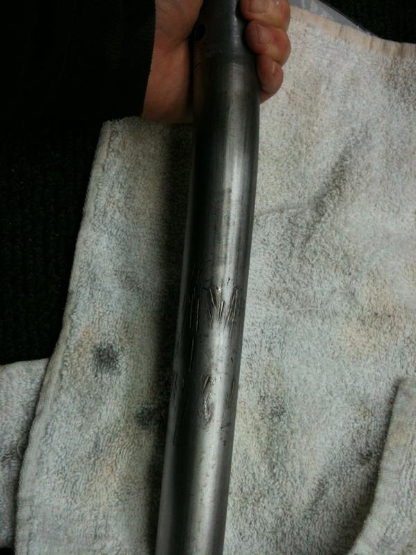

this is, without exception, the worst case of a mechanic not knowing a fucking thing about Grummans (I can say that here) that I've ever seen.
Strut had been removed using a hammer and chain and pipe wrench.
The pics were taken AFTER I had sanded it out the best I could.
The strut was covered with rust. It took a long time to get it this clean.
After sanding and cleaning, I acid etched it, primed it, and painted it. I'll see how it looks in a few hours.

I wouldn't waste any time on it. I'd call it unairworthy.
Cliff

Was the strut cavity deformed because he might have over tighten the bolt.
Barry

Now that's ridiculous. You should be able to bill a line item for recovery of part from hands of incompetent A&P. Actually, I really think the FAA should be advised. This level of professionalism could get somebody killed.
IMHO, of course.
Linn

good catch, Barry. I'll check.
