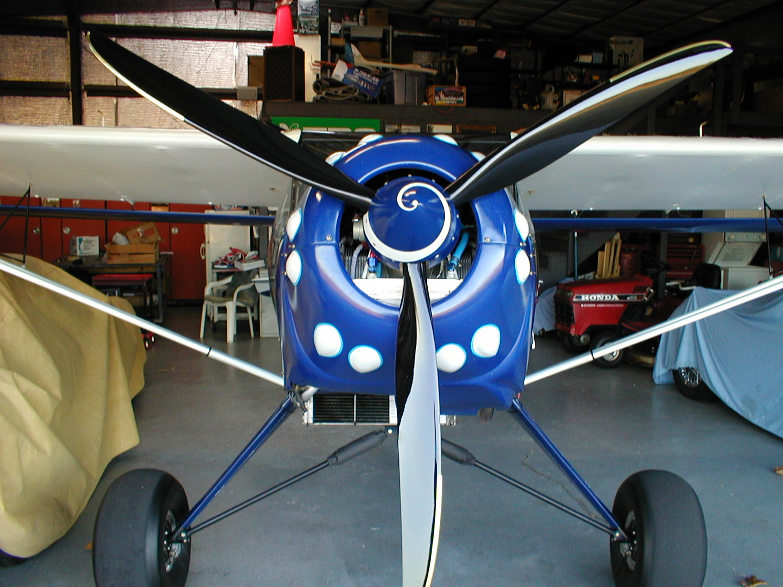

I too had the 72" Warp nickel edge prop (although mine was the tapered tip). I removed it and installed the lighter Kiev. That solved my engine run on problems I was sometimes having at shutdown (prop would turn backwards about three revolutions) I suspect the mass of the Warp was causing the prop to flip back at the top of the "dog gears" in the gearbox at shutdown. For whatever reason I now have a much smoother , quieter  propeller and NO kickback. But then, I am the only one in the country that has had the kickback problem.
      Dick Maddux
