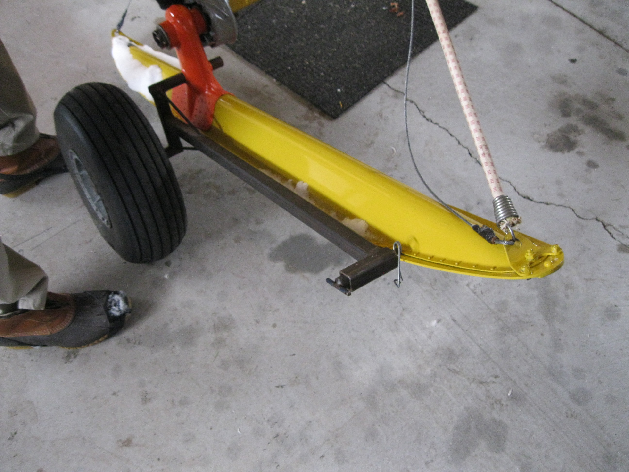

Hi all !
Well they're done ! I taxi tested yesterday and flew her today and they work great ! Can't wait for the the lake to get hard enough to start landing on ! Here is the YouTube link to watch it ! I will have another view will be up later.

Chris- Seems to work pretty well. How do you move it around on the bare spots? Dollys for the landing gear, or just drag it?

Thank you bill !
for right now I put a set of snowmobile dollies under the center of the skis...I'm going to make a set of wheeled jacks that will slide in the the brackets on the skis then lifts them up to move around.I will post a picture of what I'm going to make....

That is a nice arrangement. No effort, just step on it and slide in the pin.
