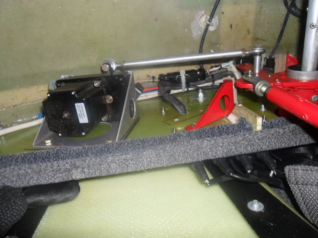

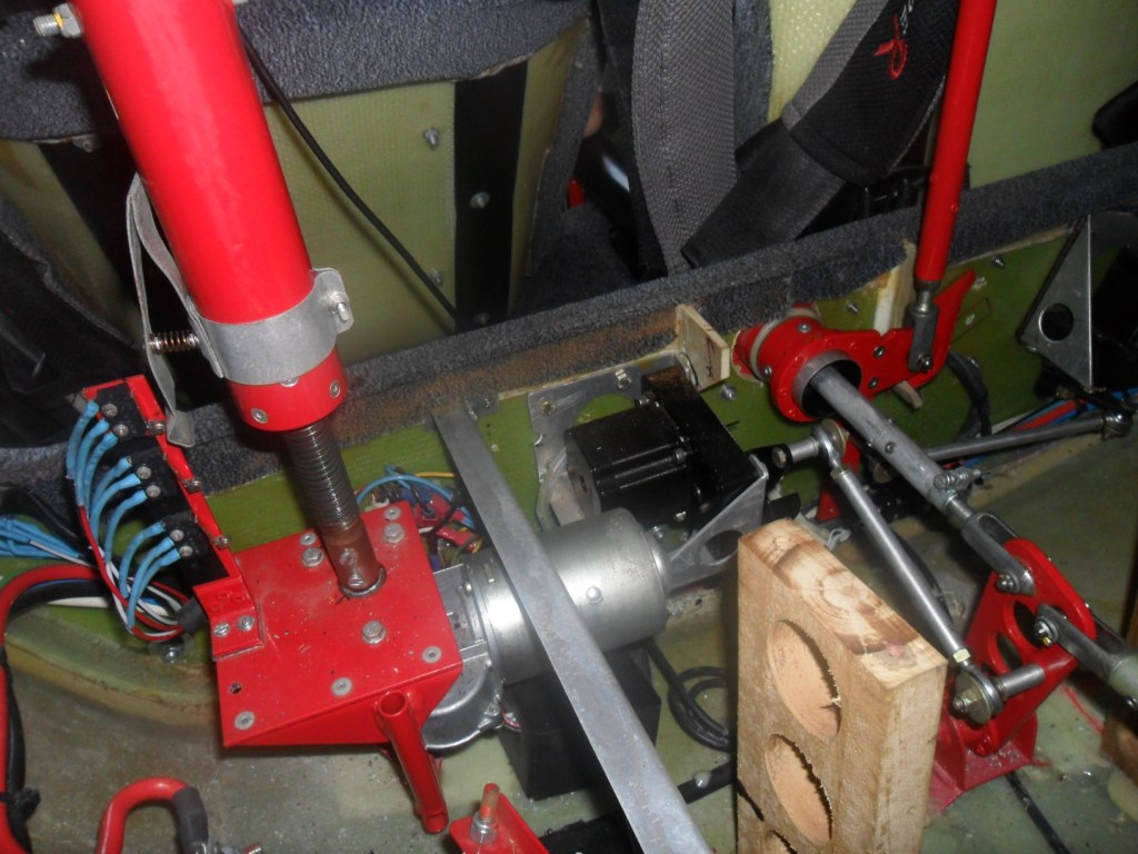

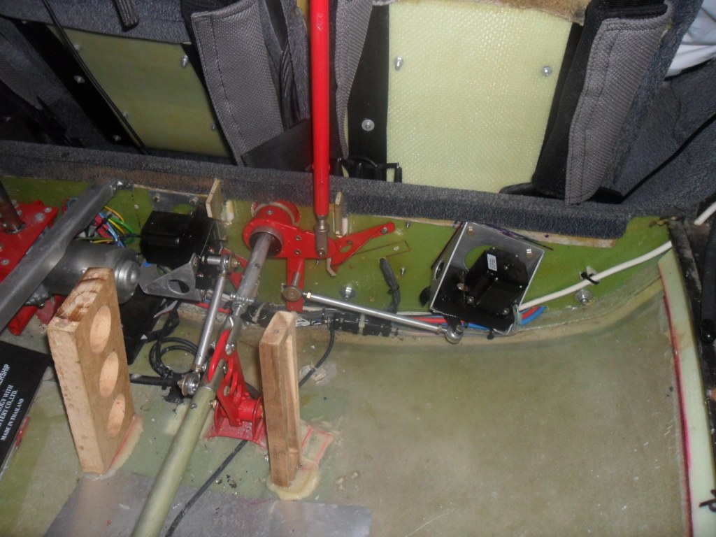

Someone asked me for photos of the servo installation in a previous post.
I have more photos from different angles if anyone wants them by email. The install is pretty simply but the black electrical box for the flap motor had to be re-sited. The standard Dynon install kit works fine.
I haven't used the autopilot much. It seems to 'hunt' for the heading. As it rolls onto the heading, the adverse yaw slews the nose around. It corrects and the process repeats.
There is a new Dynon 5.4 software with different roll algorithms which I haven't tried yet.
On another subject, the tiny baggage tray support tabs front and back always worried me with a long unsupported span directly over the elevator controls and the trays joined by nutserts. 20lb hitting a 3G bump in turbulence is suddenly 60lb.
I epoxied the 2 vertical wood supports which are screwed to both trays and then sat on the trays to load them to 160lb.
Paul

The first photo also shows the modification to the wires on the flap microswitches which I mentioned in an earlier post.
The factory used a computer ribbon which has extremely thin wires. Over time, several broke at the terminals possibly due to operating from a bumpy grass strip and the extra vibration from the 100hp.
We spliced 18 gage wire with a long heatshrink on the bend for stiffness then secured the original ribbon to the bulkhead.
