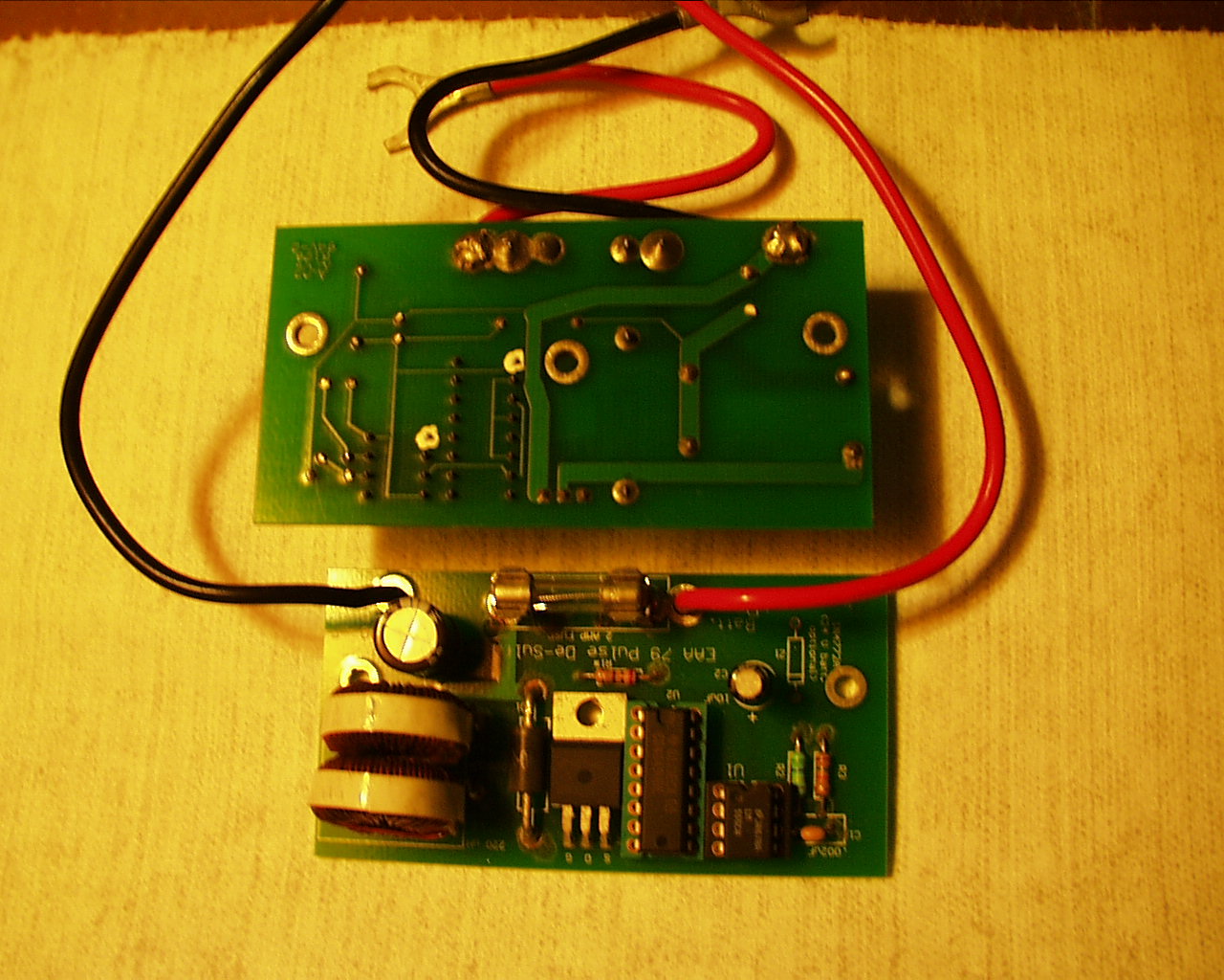

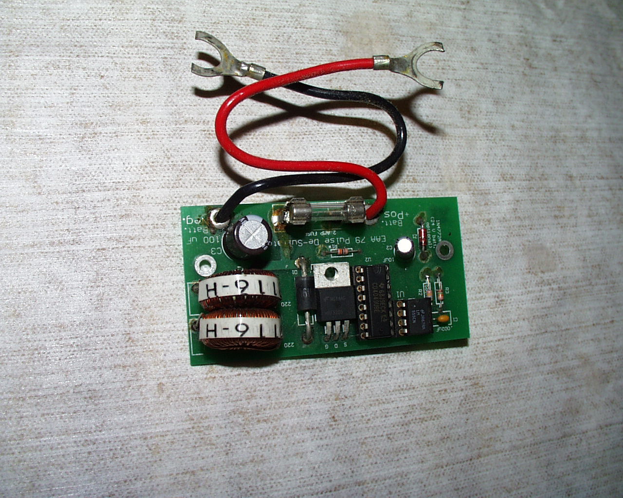

Sorry I couldn't find the schematic but I did attach a picture of what I have. As you can see my unit is different than the one on E-Bay. Maybe that one works but mine sure doesn't. It's cheap enough to get one and try, and if you do let us know how it works. I had always heard that once a battery sulfates, it's gone. At the same time I thought that there surely is a way to pulse the sulfate off the plates and regain use of the battery. I tried for weeks using this circuit but nothing. I tried battery's that still had some capacity, maybe half capacity, but could never see any improvement. Believe me I really wanted to see this thing work but maybe its true that once a battery sulfates it's gone.

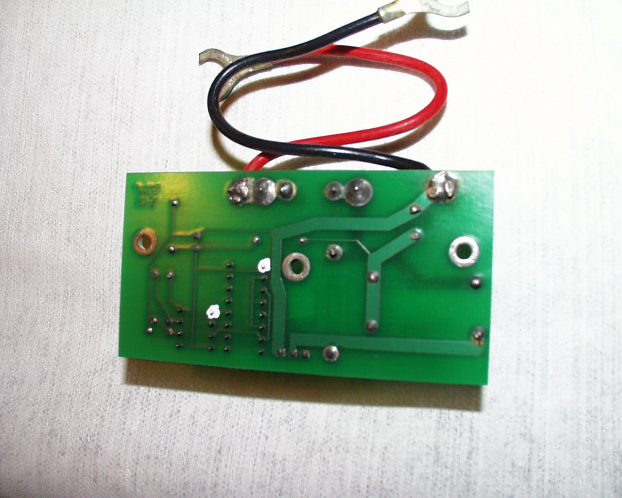

Take a pic of the etch side and I will try to draw the
schematic... I notice that most of the components have standard
numbers...The Timer is a 555 ic ...the other Ic is a hex inverter
. one Mosfet...two torroids in the voltage stepup circuit.. three
resistors...two electrolytic capacitors..one diode that looks to be 3
to 5 amps... The Zerner is to be used only in 24 volt service... by the way...

herbgh(at)nctc.com
PostPosted: Sun Dec 12, 2010 12:13 pm    Post subject: Kolb-List:battery rejuvenator forum... Reply with quote
Rick
Just realized...this device is designed to be powered by the
battery under test ...near as I can tell...? Herb

herbgh(at)nctc.com
PostPosted: Sun Dec 12, 2010 12:26 pm    Post subject: Kolb-List:battery rejuvenator forum... Reply with quote
Answer my own question....Guess the leads to the battery to be
rejuvenated are hidden? Here is a link to the site
http://www.barkeraircraft.com/eaa79parts.html
At 02:08 PM 12/12/2010, you wrote:
Rick

Here is the picture you wanted of the bottom of the circuit board. I have put two white dots on the board indicating pin 1 of the Ic's. The part number of the voltage regulator looking component is HRF 3205. The large diode looking device"s number is 0614G. The two toroids numbers are 2116-H. The red wire goes to the positive side of the battery and the black goes to negative. There is no other connection to be made. I was really disappointed with the EAA sponsoring something like this, but I'm over it. I've worked in electronics for 40 years. I don't remember how much these two circuits cost but they do nothing.

Herb:
    Here is the picture you wanted of the bottom of the circuit board.  I have put two white dots on the board indicating pin 1 of the Ic's.  The part number of the voltage regulator looking component is HRF 3205.  The large diode looking device"s number is 0614G.  The two toroids numbers are 2116-H.  I don't remember how much these two circuits cost but they do nothing.
Rick Lewis
(VW Watercooled Engine)
http://forums.matronics.com/viewtopic.php?p=323171#323171
http://forums.matronics.com//files/pic00009_185.jpg
http://forums.matronics.com//files/pic00005_127.jpg

herbgh(at)nctc.com
PostPosted: Mon Dec 13, 2010 9:48 am    Post subject: Kolb-List:battery rejuvenator forum... Reply with quote
Rick
His new version shows two leads coming from the battery charger
and two going to the battery.. It looks as if your unit hooks to the
battery under test along with the charger in parallel. Is that what
you surmise?
Check the web site... Herb
At 09:20 AM 12/13/2010, you wrote:
Herb:

Rick Lewis
Joined: 03 Jul 2007
Posts: 122
Location: Kingston, Tn.
PostPosted: Mon Dec 13, 2010 11:15 am    Post subject: Re: Kolb-List:battery rejuvenator forum... Reply with quote
Yes, that's exactly the way it's hooked up. The battery charger then parallels the red and black wires at the battery. I feel that if the new version works, he should replace mine. Really can't see that happening in this day and age.
Rick Lewis
herbgh(at)nctc.com
PostPosted: Mon Dec 13, 2010 11:45 am    Post subject: Kolb-List:battery rejuvenator forum... Reply with quote
Rick
The new revision isolates the battery charger using separate leads
into the de-sulfator... Herb
