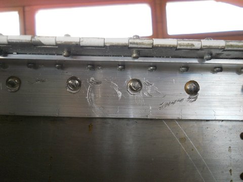

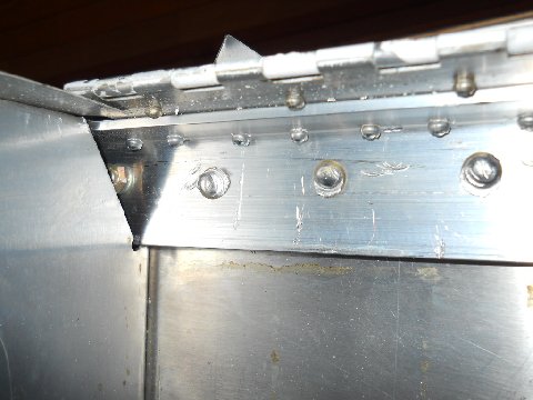

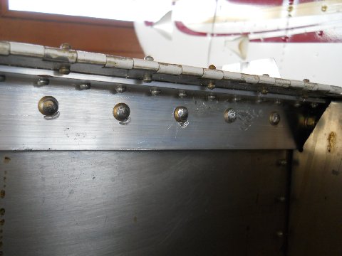

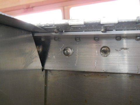

As many of you know I have been doing upgrades for the past year and have lost count at this point. But what is the point of doing the upgrade yourself if you are not skilled enough to do it?
After what I have seen between the aircraft that were brought in to the shop before the upgrade and one that was brought in after the upgrade I would venture to say the later would have been safer without the upgrade.
I will be posting photos each day with a caption of what is wrong and how to spot it for buyers of a flying upgraded 601 XL-B.
These photos aren't being posted to embarrass anyone but to merely show what could be the next wave of aircraft that should be safer only to be worse off with the upgrade being installed incorrectly.
The first photo is of the rivets that were bucked incorrectly and will need to be replaced. Not only were they done incorrectly but some of the old rivets are still in the holes that were drilled wrong.
Some of these rivet heads have a gap between them and the aluminum.

I had a little trouble interpreting the photos so I thought I would ask a question or two.
The rivets you are concerned about are the bottom row in the picture? I guess this is a picture of the new spar cap angle riveted to the main spar and viewed through the wing locker. Is this true? It seems like your concern is the shape of the shop heads. Is this true?
I am very concerned about your comments. So far, I only get the message you are concerned about the solid rivets. Are there other problems you have found?
Your comments make me feel good about my decision to use bolts instead of solid rivets on my upgrade. I would still like any comments you may have about any other areas of concern.

Every part of the upgrade is installed incorrectly..... I can send you the photo's off everything and you will see my concern. Smile
Jeff

Interesting, This level of workmanship is scary. One would expect that those who don't know how to do something on an airplane would ask for help, that was not done in this case.
I was fortunate enough to have a friendly fellow flier a few hangers away who was also a mechanic. I got some lessons in doing solid rivets before doing mine and then he looked at the finished job. It is hard to believe others would do less.
I also cheated and used a big (6000 lb rating) rivet squeezer to do all the -6 rivets. It make the job very professional looking. The right tools are always a great help.

   Are all the photos on Facebook of the same aircraft? Many of the photos show very poor workmanship to say the least. Most will requires many more hours/money to correct than the time/money/effort to do the upgrade. WOW
Afterfxllc(at)aol.com
PostPosted: Sat Dec 11, 2010 4:44 pm    Post subject: Upgrades or lack there of! Reply with quote
Walt,
Those are different airplanes I am working on or have finished this year.
I told the new owner I would do all the repairs and replace the left aileron for 2,000.00 and 500.00 for material and then he will have a bird he can be confident in.
The airplane itself is built very well but it all went sour because of the upgrade.
Jeff

I hope you are considering replacing the extruded spar cap angle as well as the rivets. I remember seeing some significant damage to the area around the poorly set rivets. I think the cost of material would be minimal and the results from trying to smooth out the damage might be questionable. In either case you will need to do a lot of work to make the holes line up properly to install new hard rivets.
I'm guessing you will see similar damage on the other end of the rivets. The same logic can apply there too. Aluminum bar and angle is not very expensive and easy to obtain.
Paul
