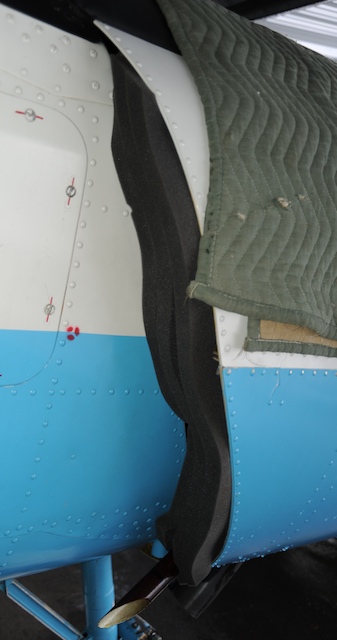

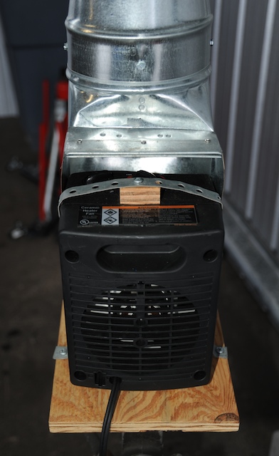

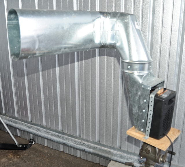

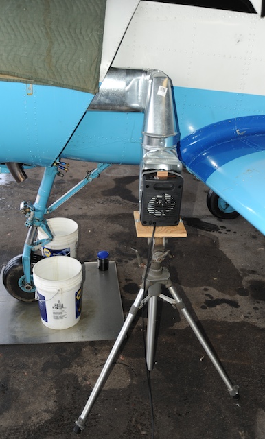

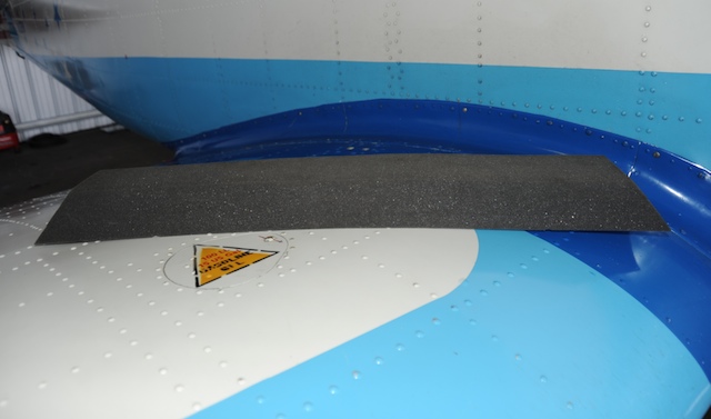

Didier:
It took a while, but here are some pics of the engine compartment heater I improvised. I think I'm going to make a similar one to blow on the oil cooler.
-Eric
[img]cid:1FA9365F-4952-4AA2-B29A-104744859777(at)home[/img][img]cid:E349A8E6-F417-44DF-B209-2E2FAB4E46DD(at)home[/img][img]cid:7AD6423E-42FE-4241-A400-0143A0B054CF(at)home[/img][img]cid:48D2FDA4-08A1-4093-994C-824A29E9EAD8(at)home[/img][img]cid:F1065B00-8E94-4E51-ADB5-C63673108EB0(at)home[/img]

Hey, I noticed that farm equipment places have heating pads in all shapes and sizes. Shockingly cheap, and apparently sourced the same as the aviation ones.
I use a Harbor Fright (Halloween coming up) fan driven disc heater with some HVAC items cobbled in such a way that it's funneled into the left side of the cowl. I close the gills and usually plug the left side with some foam. I have it mounted on an old tripod so it can be properly positioned. Heats everything except the oil cooler, which doesn't seem to b3 a problem with the Phillips 25-60. I live near Buffalo, NY. I'll try to post a picture sometime.
