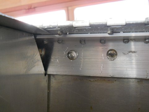

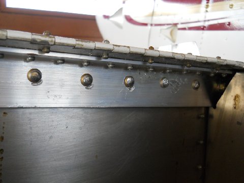

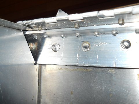

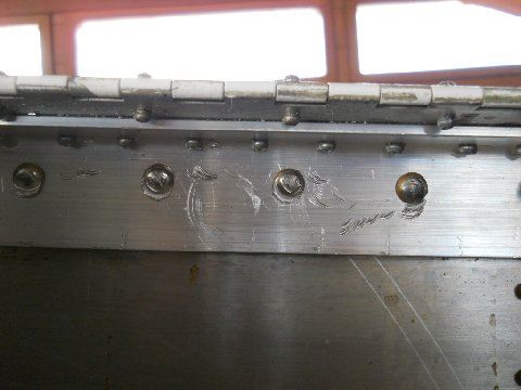

As many of you know I have been doing upgrades for the past year and have lost count at this point. But what is the point of doing the upgrade yourself if you are not skilled enough to do it?
After what I have seen between the aircraft that were brought in to the shop before the upgrade and one that was brought in after the upgrade I would venture to say the later would have been safer without the upgrade.
I will be posting photos each day with a caption of what is wrong and how to spot it for buyers of a flying upgraded 601 XL-B.
These photos aren't being posted to embarrass anyone but to merely show what could be the next wave of aircraft that should be safer only to be worse off with the upgrade being installed incorrectly.
The first photo is of the rivets that were bucked incorrectly and will need to be replaced. Not only were they done incorrectly but some of the old rivets are still in the holes that were drilled wrong.
Some of these rivet heads have a gap between them and the aluminum.

Quite the variety of issues there.
I particularly like the control system nicopress with just 1 crimp mark on it.
Even in today's economy, that's not the way to cut back.
There are parts misaligned, rivets of the wrong length, holes in the wrong places, jaggedly cut pieces, rivets missing, even rivets half way out the edge of some new reinforcement piece. Also all those dings in the spar cap angles.
Even for those errors that really don't make much significant difference in strength or fatigue life, it looks sloppy.
Some issues are a bit subtle though, if one doesn't know the 601 XL mods well. (Like me.) If you got around to it some time, a few brief comments added to the photos would help the less experienced understand those kinds of photos better.
Good stuff to learn from in any case.

Thanks for posting the pictures. I had no trouble accessing them, and I don't think I have a facebook account.
I'm sure I didn't get all the questionable workmanship from looking at the pictures. It is just too tricky to interpret them. I did notice a lot of really ugly work. However, I also noticed some stuff that was nicer than the work I did. One example is the new holes in the rear channel for the weight bar. My holes are much more ragged than the nice square ones in the pictures. Of course my holes have the required rounded corners instead of the sharp ones in the pictures.
I do have some sympathy for the owner of the plane with regard to the crease in the rear of the aileron. I have no idea how to fix such a problem and I suspect we all have, or will have, that sort of problem.
I don't know enough to inspect this plane from the pictures. Still, I'm sure you are correct when you say there are serious problems of workmanship.

If I get time I might add captions to the photo's but a new photo a day with a caption won't overwhelm everyone and it doesn't make the email too big to send.
As for the rear spar cut out. It had a patch piece over the huge hole that you see there and even the patch piece wasn't the greatest.
When I cut mine out I use a drimmel tool with a cutoff wheel and go slightly undersize then widen as needed with a file to clean everything up.
Jeff
