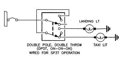

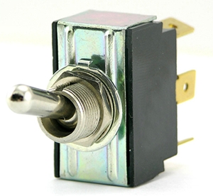

Don, the functionality you need can be configured
from a two-pole, three-position, progressive transfer
switch. An exemplar part is the B&C S700-2-10 switch
[img]cid:.0[/img]
Exemplar wiring for an off-on-on functionality
is illustrated in figures 11-1, and 11-16 through
11-18 of The 'Connection.
[img]cid:.1[/img]
