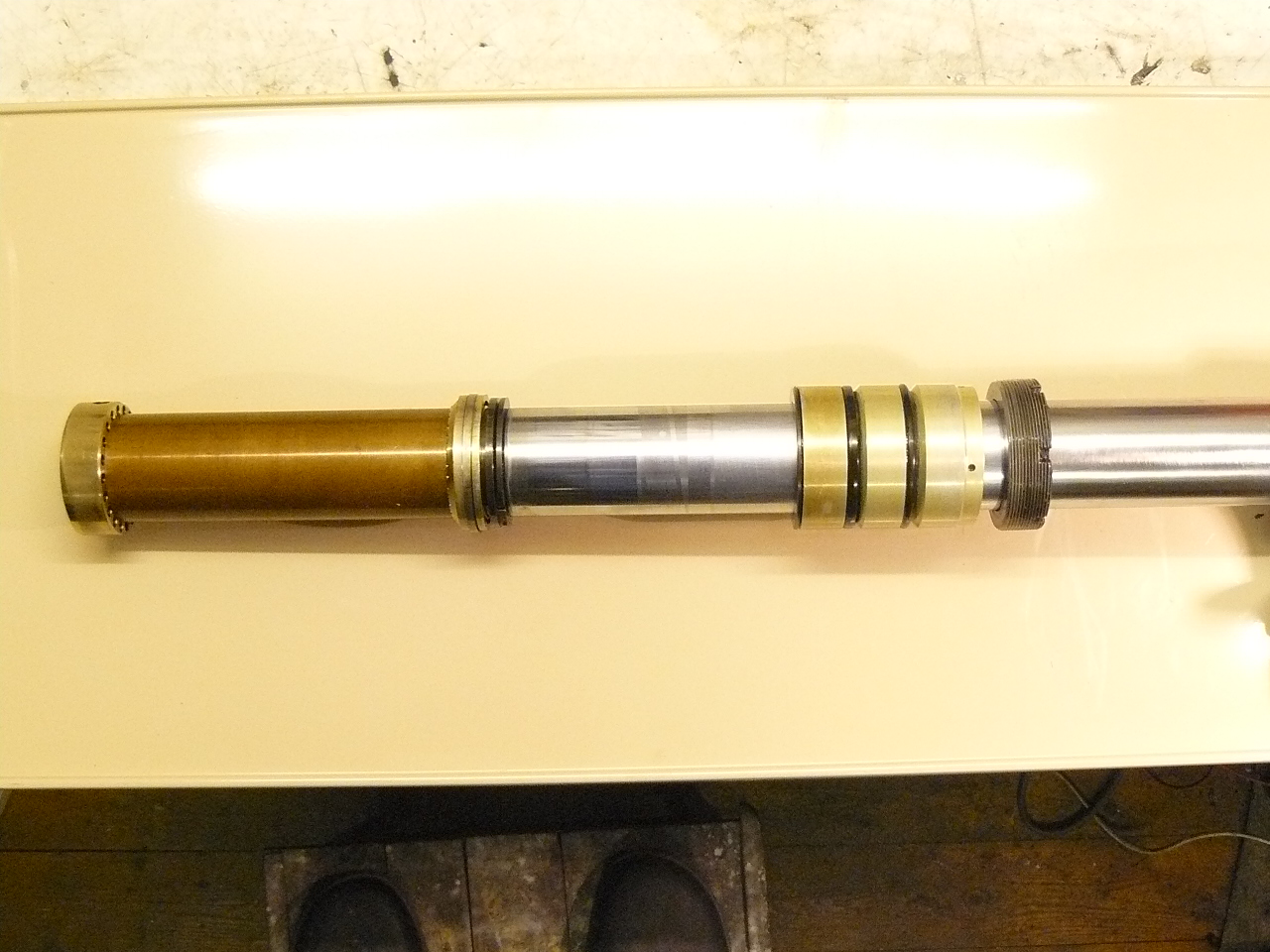

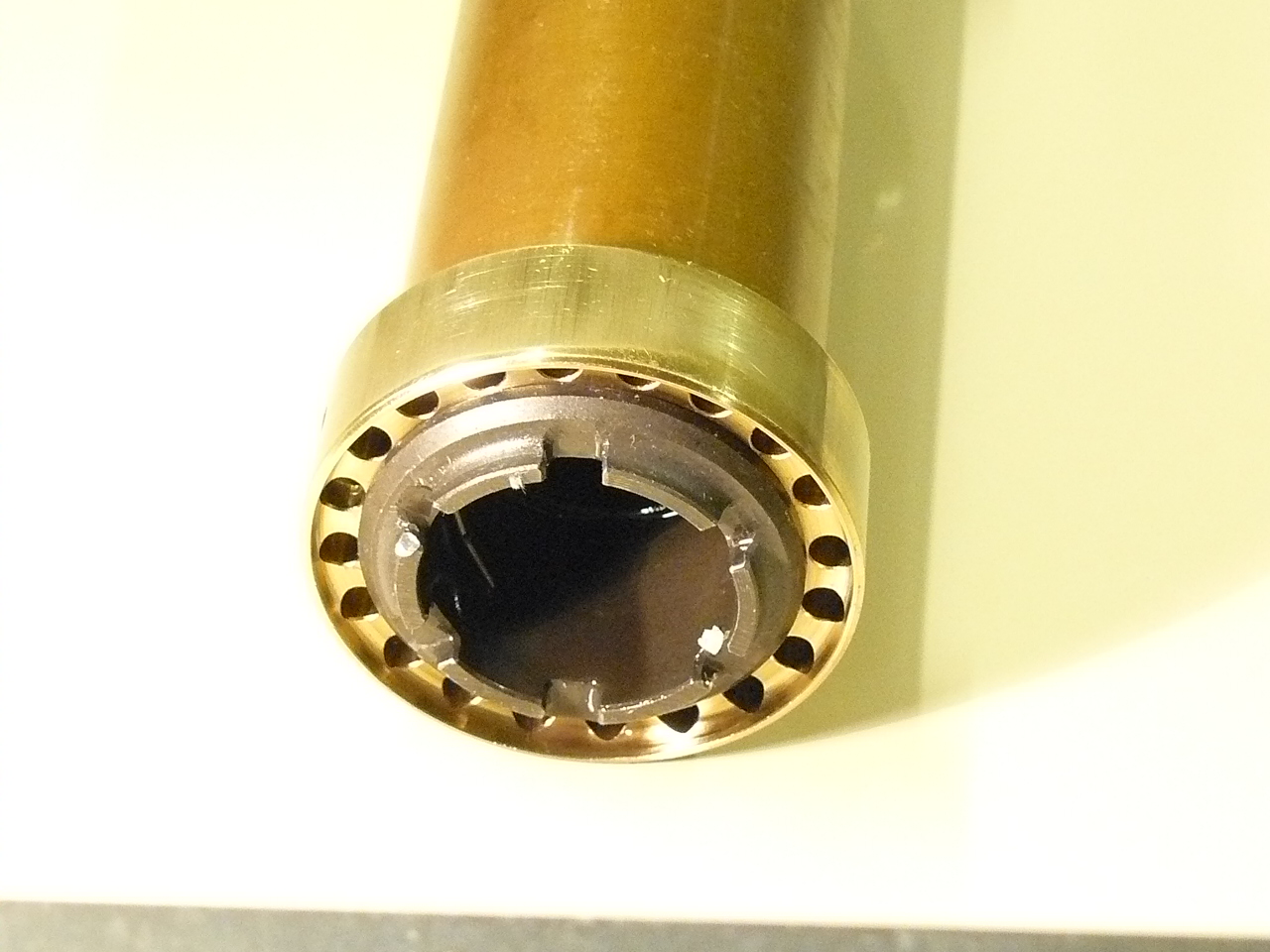

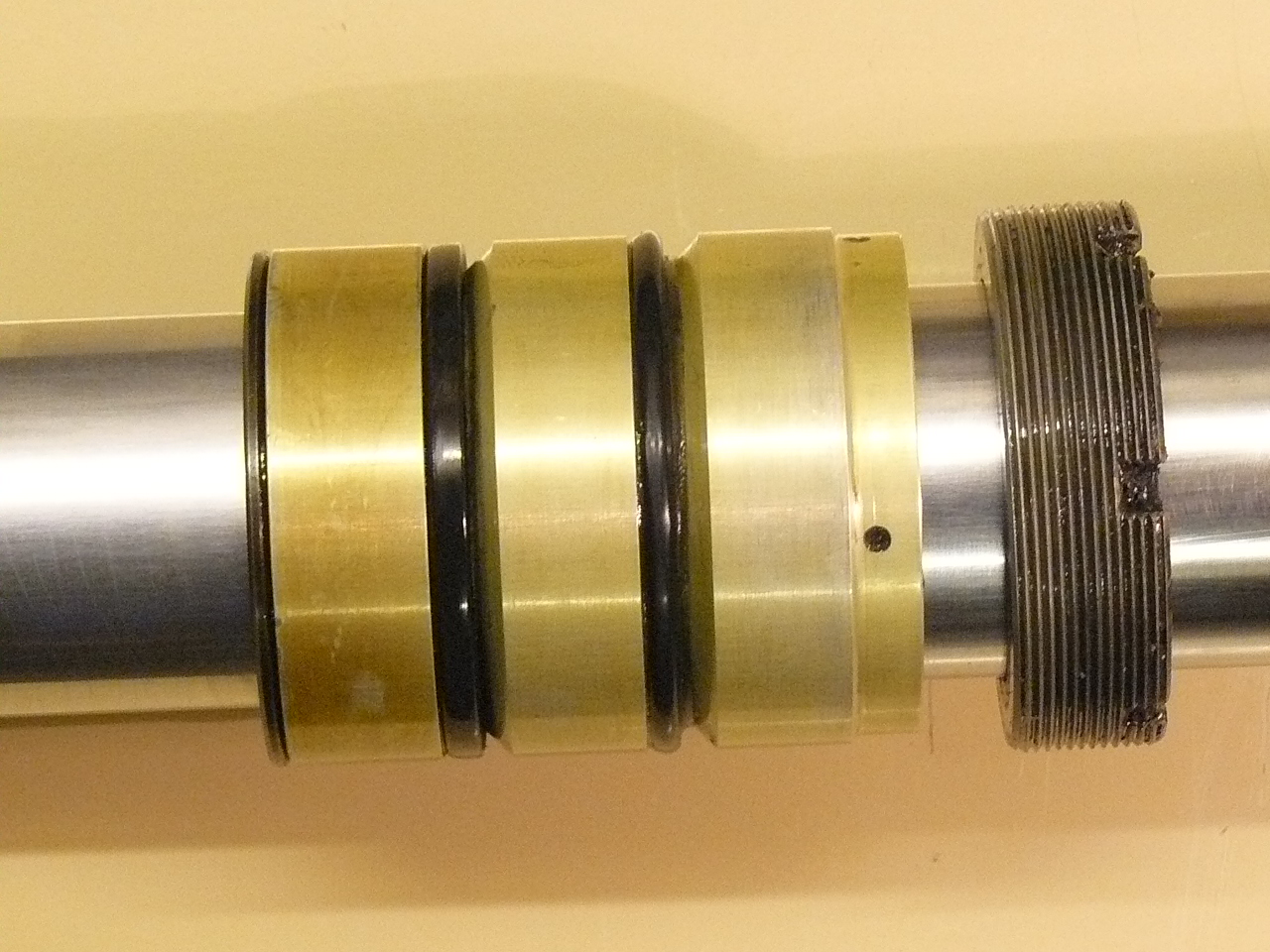

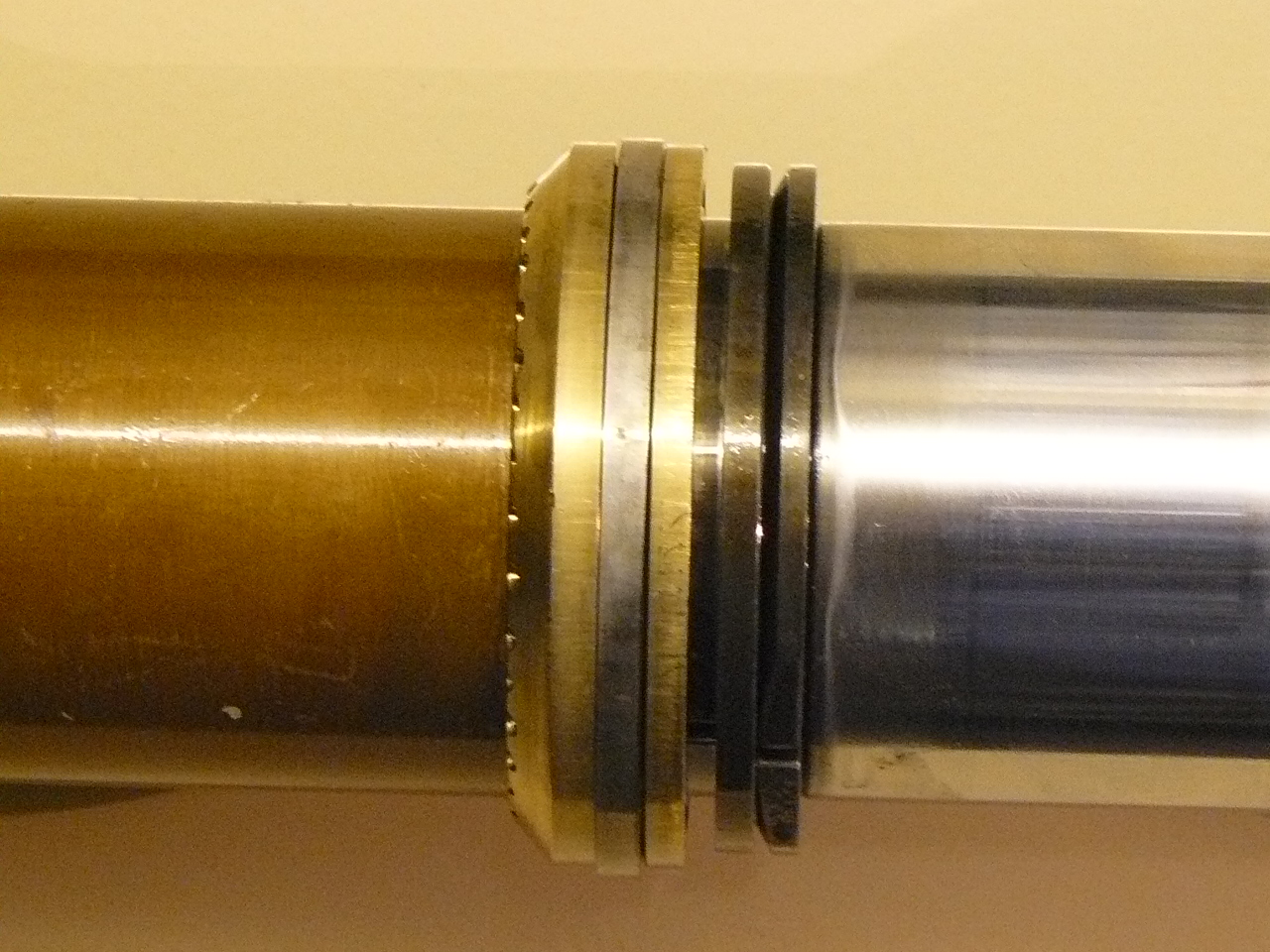

Hello Joe,
maybe some photos could help : For disassembling open top and bottom gas valves, drain the oil from the top valve. Unscrew the threaded ring at the bottom and pull the leg out. There are sets of o-rings for static and dynamic sealing, and a felt "seal" . The damping valve could do with some mod I believe. Watch this place for my findings.
Cheers
Vic
