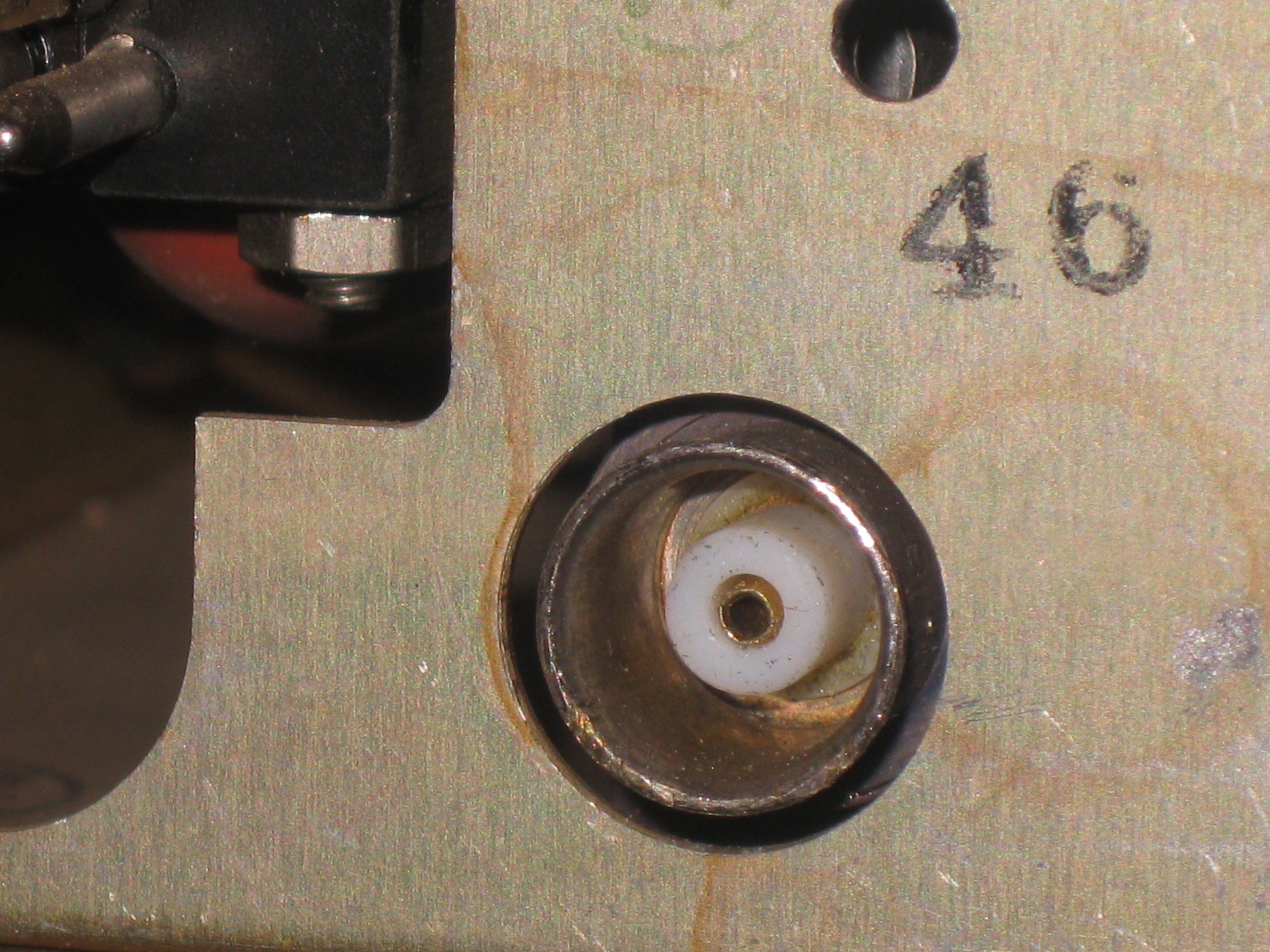

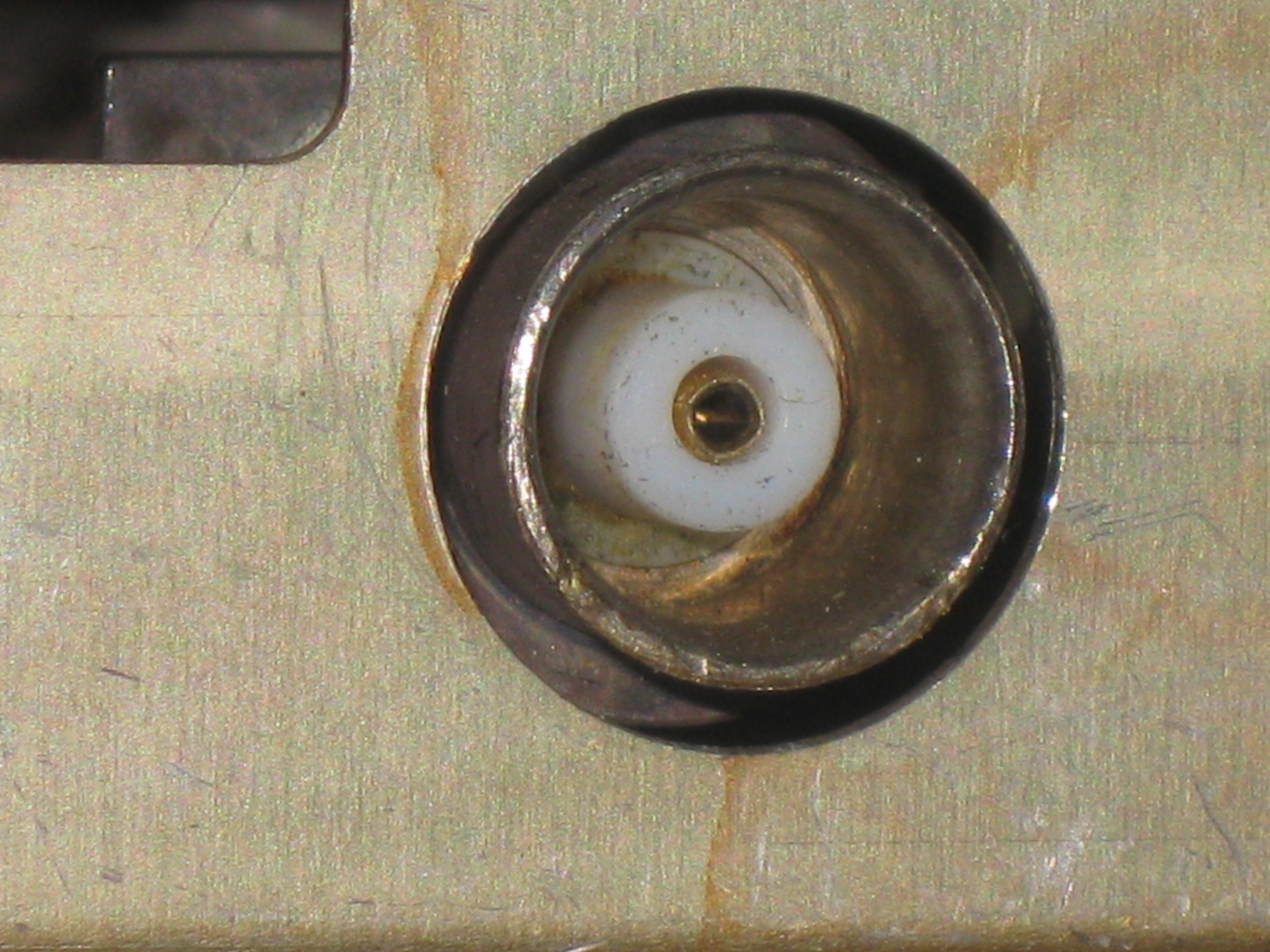

Bob,
Hard to tell, but here is a pic of what I have:
 Filesize:  2.46 MB
 Viewed:  7662 Time(s)
 Filesize:  2.93 MB

PostPosted: Mon Dec 06, 2010 3:03 pm    Post subject: Cessna ARC RT-459 antenna connector Reply with quote
At 12:53 PM 12/6/2010, you wrote:
Bob,
Hard to tell, but here is a pic of what I have:\
Yeah, I think the TED blind-mate connector
is the one you want.
