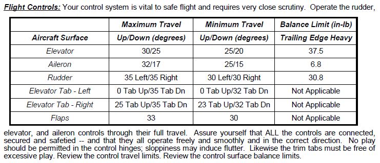

PostPosted: Sun Dec 12, 2010 7:42 pm    Post subject: Elevator Adjustment Reply with quote
Relevant section of the doc attached.  As an aside, I found out about this doc only a few weeks ago.  Apparently I didn't get it and the W&B doc in whatever kit they usually come in.
-Rob

kearney

kearney
Joined: 20 Sep 2008
Posts: 563
PostPosted: Sun Dec 12, 2010 8:26 pm    Post subject: Elevator Adjustment Reply with quote
Rob
Many thanks. I am well within the limts which is good to know. I will call Van's tomorrow and ask about the WB docs as well (as I didn't get them either).
Cheers

Hi Les, If you check section 5, you will find a max and min range for the travel. I don't have my plans with me but I think you are within the acceptable limits. I experienced the same issue until a friend told me to check section 5.
Dave Leikam.

W&B docs (and limits, etc) come with the finishing kit.
Bob Turner

Hi
Well, I spoke t Van's a few days ago and spoke to Joe who was most helpful. Today I was at the hanger and was able to "adjust" the problem away by moving the center push tube forward so the conical end does not contact the bell crank. IN doing so, the elevator horn now touches the forward stop. Problem solved!
Joe did give me a a "Plan B" in case this did not work. He suggested scabbing an extra piece of AL onto the forward stop so it contacts the elevator horn before the push tube / elevator problem came into play.
Merry Christmas to all.
