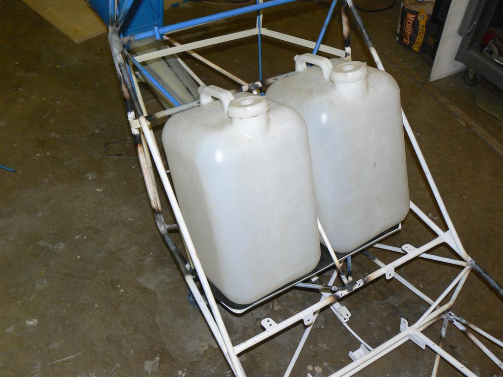

I think your weight and balance would probably come out better with the six gallon tanks where the jump seat used to be, and then put one five gallon tank just behind them where the original front tank was, that will give you 17 gallons, and with a 503, that is a lot of fuel.
Here's how the two six gallon tanks fit in N582EF. No current pictures, can get some if you want. (Tomorrow)

Hello Richard,
Thanks for your input and the picture posted.
I will surely take your suggestion and calculate the W and B and move the two 6 gallon tank accordingly.
Will appreciate if you can send me additional pictures info, if you have them. What is your present configuration of the tanks? Did you find the FS-2 flight characteristics change after adding the additional fuel tanks?? I do anticipate a longer roll during take off.

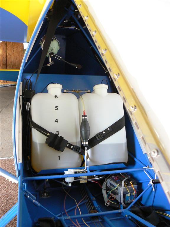

Richard Pike
Posts: 1671
PostPosted: Fri Dec 03, 2010 8:03 am    Post subject: Re: Adding additional fuel tanks – Jump Seat – FS-2 Reply with quote
Since FSDO has not yet returned the Airworthiness Certificate (which was collected after the crash, pending the rebuild) we haven't flown it yet, so no info to share.
But here is what it looks like, the only mods were a couple diagonals welded from what was the front sling seat mount/cross brace to the side vertical tubes, and a length of 3/8" tubing between the two tanks and up to the upper cross brace to help secure the tanks. The original gas tank tray now sits on those lower two diagonal tubes. Also added a cross piece to attach to the carrying handles on the top of the tanks. Works well, hardly any wiggles, very secure.
Since I wanted the fuel tank pickups to come out of the top of the tanks, the primer bulb was necessary. The Facet pump (visible below the tray, center) will not pull fuel without a prime, hence the primer bulb.
Downstream of the primer bulb is my "poor man's gascolator" (details here: http://www.bcchapel.org/pages/0003/pg13.html) and you can sort of see the line going to the quick drain valve off to the left of the fuselage.
The right tank in the picture has a JC Whitney gas gauge sender in it, after we take the film off the Lexan I take a picture of how it is installed.
The black thing on the front of the left tank is the battery box for the ANR headset.
More pictures later.
Richard Pike
MKIII N420P (420ldPoops)

PostPosted: Sat Dec 04, 2010 1:31 am    Post subject: Re: Adding additional fuel tanks – Jump Seat – FS-2 Reply with quote
Richard, Your photo shows your fuel tanks just above your battery/electronics box. Is that right ? Perhaps it might be wise to consider some sort of cover over the electronics such that if there was a leakage or spillage of fuel it doesn't go directly down onto those items but is drained off safely somewhere else. Just a thought. David.
Richard Pike
Posts: 1671
PostPosted: Sat Dec 04, 2010 11:27 am    Post subject: Re: Adding additional fuel tanks – Jump Seat – FS-2 Reply with quote
Something like cut the bottom off a plastic milk jug and drape over it? Sounds good to me!
