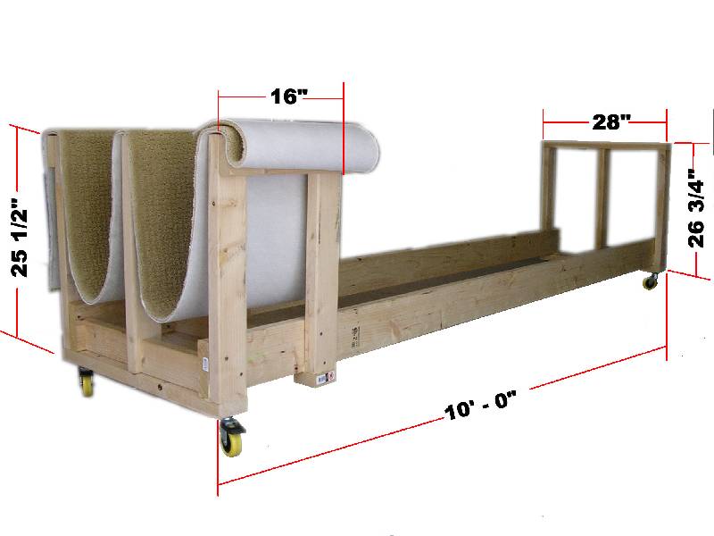

I think it's about time I get my wing cradle built. Anybody have any simple plans for a wing cradle or pictures of what you've built? How about a materials list?

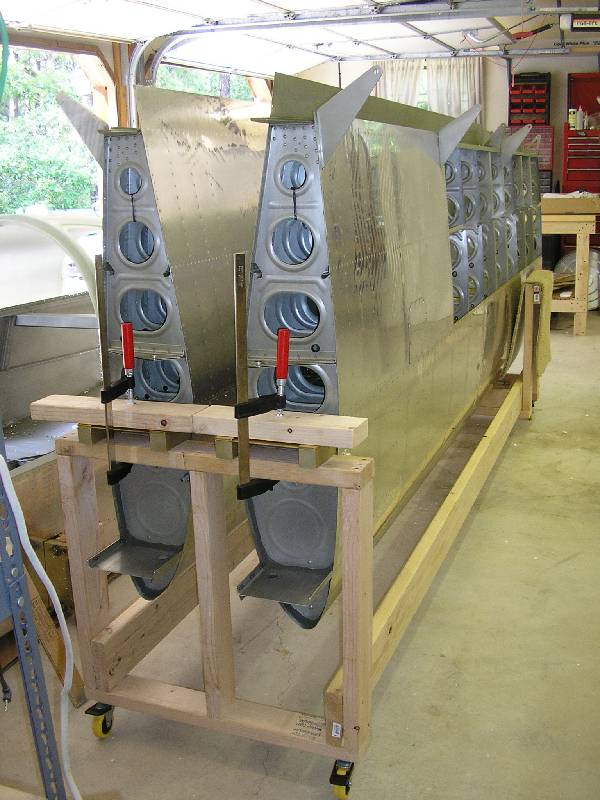

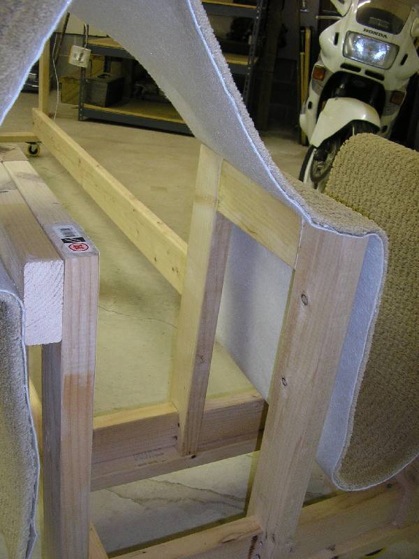

I don't remember whose photos these are, but I built mine off just these 3 photos and it works great.

I built the same ones and 4 years later have not complaints. I used
indoor/outdoor 'grass' type carpet for the slings. It looks like this
set used soft wheels of some sort. On concrete floor, soft should work
better than the steel, but I used what I had and they work fine too.
