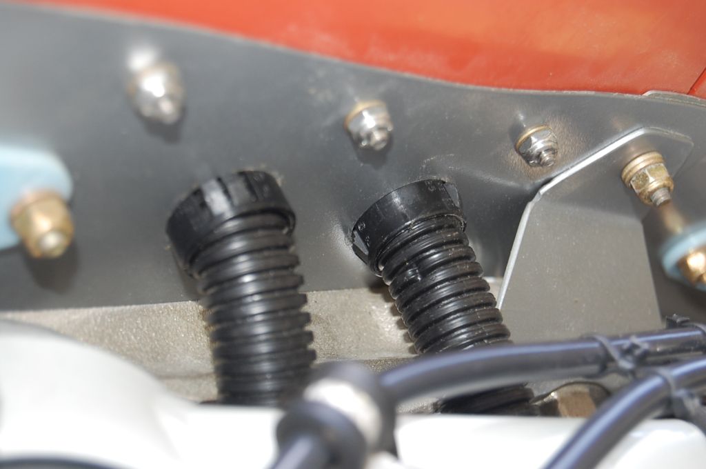

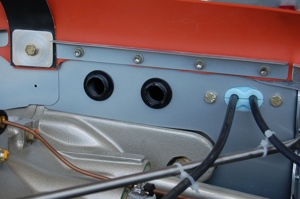

Avery for Tach covers and this is what I did on the blast tubes. I think it's a 1 inch hole, and then a 1 inch snap bushing which just happens to have a groove that snaps into the grooves in 3/4 blast tubing. Perfect and you can't pull it out!
Just one way?
Bill S

Thank you for the advice. That is the neatest job I have ever seen on the baffling. Love how you sealed it with angle and bolts. I wish I hadn't already placed 100 pop rivets per Van's plans. I would definitely copy you. I will use your advice on the snap bushings and again - my compliments on the neat baffling and seal.
Jim RV 10 728DD 300 hours # 2 under construction
