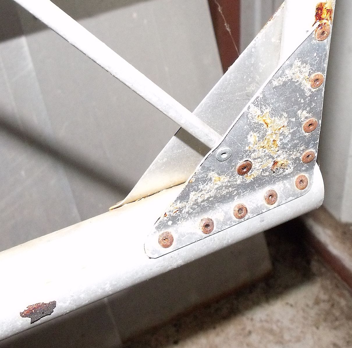

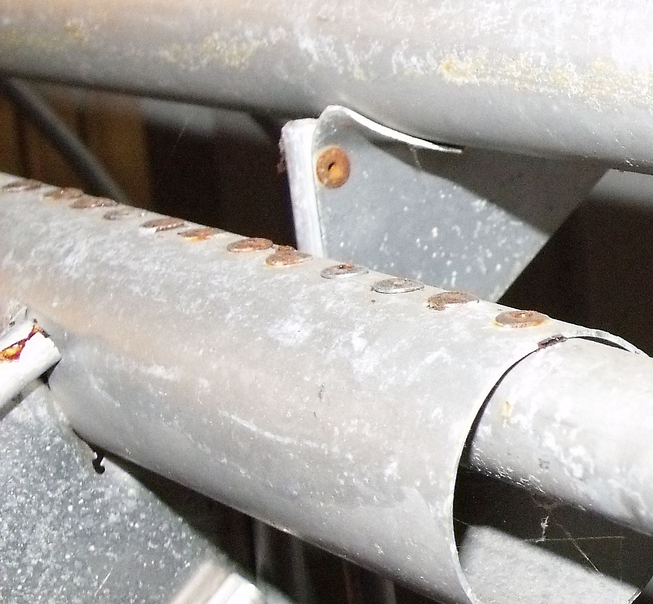

I realize that each Kolb built it the builder's experiment and you have the right to do as you wish, but you might want to consider this. The two things missing in the construction videos are: 1) No sign of any sort of corrosion protection on all that bare aluminum, and 2) no drain grommets or any way for water to get out of the covering.  I know there will be comments from those who've never seen corrosion, or who don't believe in it, but the pictures show what condensation inside the wing of a 15 year old Firestar did to the aluminum. As Poor Richard said, "an ounce of prevention is worth a pound of cure".
If you think alodining new aluminum and painting with epoxy before covering is a PITA, add hours and hours of drilling out rivets, sanding and inspecting with a magnifying glass to the point of eyestrain, THEN acid etching, alodining, painting and reassembling for which you get more pains than just those in the posterior.
I didn't invent this, it's all right there in the Poly Fiber manual, so do as you think best.

Rick, was this Firestar stored in a trailer?
I've heard that corrosion like this can happen
when the aircraft is stored in a trailer. I have
a 24-year-old Firestar and I'm sure there isn't
any corrosion on it and I store it in a garage. I
don't have any drain holes in the wing and I fly
during the winter and sometimes get salt on the
outside of the plane trailering it on those salted
Minnesota roads.

Ralph, I've only owned it for four years so I can't say. The fellow I bought it from had it stored in a workshop when I picked it up.
Rick

The climate you have it in has a lot to do with it. I doubt owners in northern VT have a lot of corrosion problems.Dry in the summer and zero corrosion in the bitter cold due to retarded chemical activity.
Personally I'm happy my wings have no access holes. there are no moving parts to inspect and no problems with
bees, mice, chipmunks and hickory nuts within.

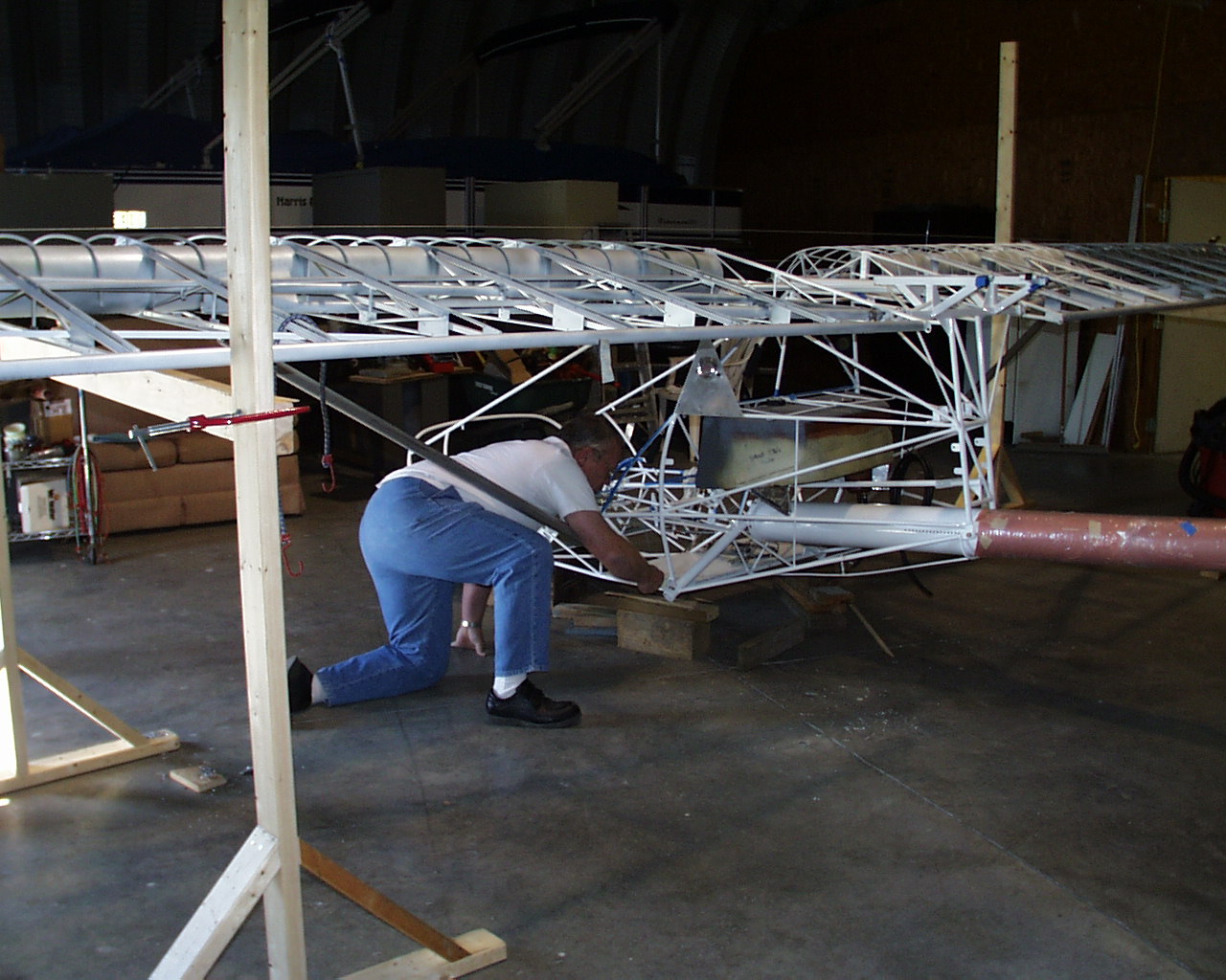

I absolutely agree with you on this. Every piece of aluminum in my plane has been corrosion proofed with the epoxy paint recommended in the poly fiber manual. Its easy to think everything is alright when you can't see it.
Rick Lewis

6061-T6 does not need corrosion protection in most applications..It
has its own oxidized layer that protects over time.. I would only be
concerned if I were flying near salt water...
I rebuilt an Ultrastar that had steel rivets and found everything
to be in good order...20 some odd years later...it had been on floats
at one time.. Herb

Herb, No offense, but that's an old wives tale. 6061-T6's silicon alloy base makes it more resistant to corrosion than a copper based alloy like 2024-T3, but it doesn't give any magical powers. All aluminum gets an oxide layer the second it's exposed to oxygen and it does slow corrosion after that, but inside a sealed wing with a condensation cycle every day, unless of course you're Kolb is somewhere near Davis-Monthan AFB, provides all that's necessary for corrosion to continue. My Firestar came from mid Pennsylvania and now it's in Kansas. Not a lot of salt water around here.
Rick
Still, that seemed like _really_ bad corrosion! I have what's left of a project that started out as an ultralight in 1980, then a trailer some years later, that's sat outside my house for 23 years, laying on the ground, getting rained on. All 6061 tubing and AN bolts; it's still nowhere near as bad as that.
-Dana

My other point was that I have rebuilt an Ultrastar and a MkIII ..91 MkIII and an older Us. No Corrosion...Herb
At 09:22 AM 12/1/2010, you wrote:
[quote]Herb, No offense, but that's an old wives tale. 6061-T6's silicon alloy base makes it more resistant to corrosion than a copper based alloy like 2024-T3, but it doesn't give any magical powers. All aluminum gets an oxide layer the second it's exposed to oxygen and it does slow corrosion after that, but inside a sealed wing with a condensation cycle every day, unless of course you're Kolb is somewhere near Davis-Monthan AFB, provides all that's necessary for corrosion to continue.
Rick

What is the procedure you used for corrosion proofing the inside of the aluminum tubing used on a Kolb?

Gang:
Back in the old days, Kolb used carbon steel rivets with carbon steel
mandrels. They loved to rust.
I built my Ultrastar with carbon rivets and learned soon how quickly they
developed rust.
When I built my FS, I got Little Mike, Old Kolb Part Man, to get me SS pop
rivets to build the FS Kit. They worked much better, but they still used
carbon steel mandrels. I used to put a blob of Stitts 2 part expoxy on the
heads, but could do nothing with the tails of the rivets. However, this has
never been a problem. I am flying a MKIII I built in 1991, and has been
flying since 1992. That's a lot of hanger time, and a lot of time out under
the stars and rain/dew when I am flying overnight or longer cross country
flights.
I haven't had a problem with corrosion. My understanding was most aircraft
aluminum is "alclad". That is a thin coat of pure aluminum. If you get
aluminum that is not "alclad", it is more prone to corrode.
Based on the photos Rick G sent to the List of his Kolb project he picked up
in PA, I would have left it right where I found it. Never seen anything in
the junk pile out side that looked that bad, except when rodents peed on the
aluminum.
Rodent urine is highly corrosive, and they love Kolbs, especially the
tailboom. Occasionally I shoot some anticorrosion spray into my tailboom to
counteract rodent urine and water that gets in there from condensation, and
also from occasionally washing the airplane.
I am more concerned with the 4130 chromoly tubing. I have used tube seal in
all three Kolbs I have built.
aluminum.
