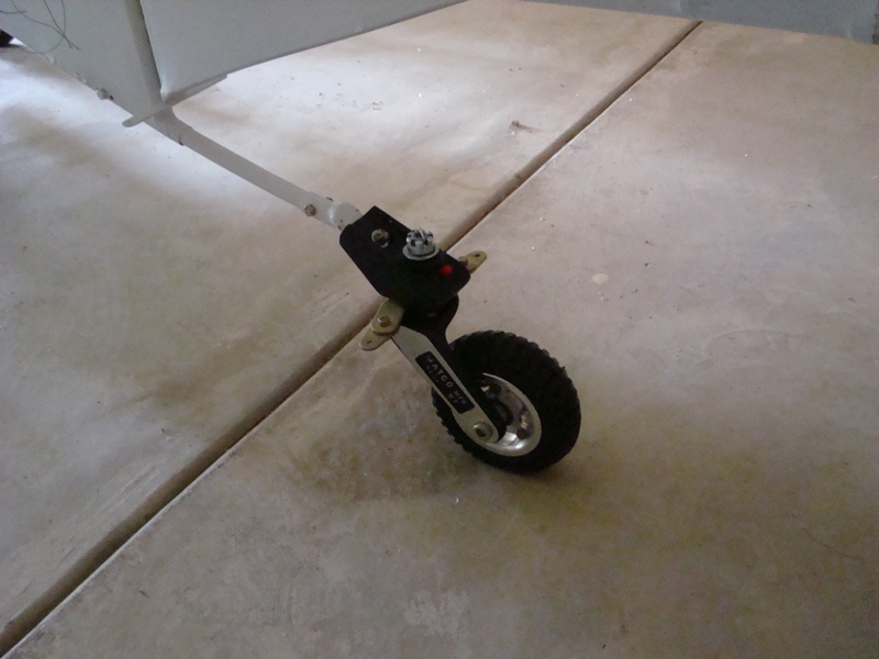

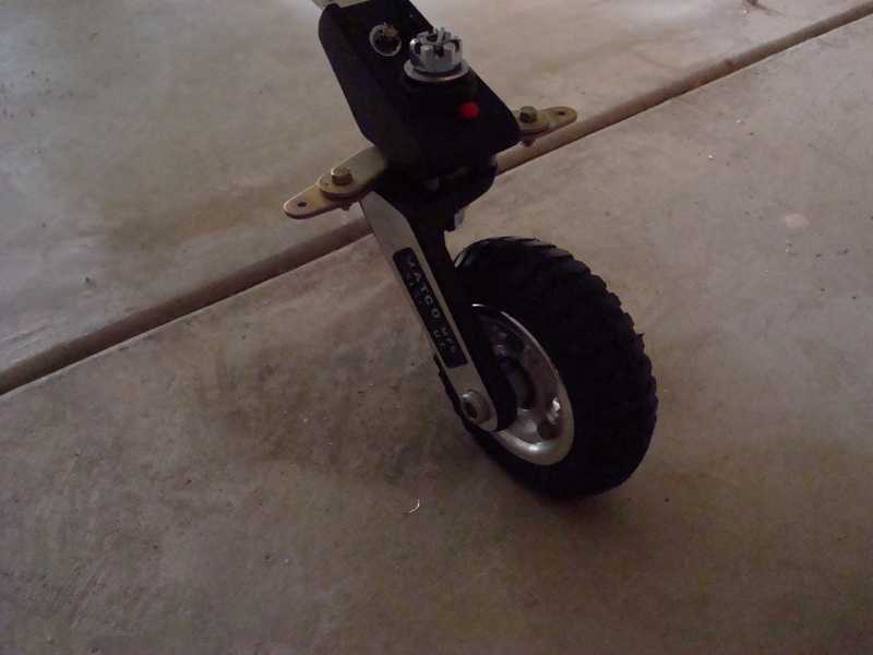

  I recently installed the Matco 6" pneumatic tailwheel (from Aircraft Spruce) you mentioned.  I like it a lot, and the
proportions look perfect for a MkIII.  I'd imagine it would look great on a Firestar, too.  It has the full pivot "break away"
feature, for extremely hard turning.

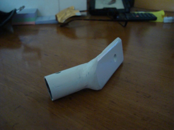

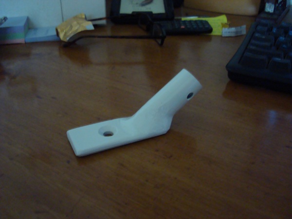

  Regarding the "non fit" you talked about, I made an adapter to go from the stock 3/4" aluminum rod to the
1 1/4" flat spring mount.  If you decide to go this route, send me a private message, and I'll give the material
list & the proceedure I used to make the adapter.  (see attached photos)
  The Matco instrunction say to mount the taliwheel so that the swiveling part is as vertical as possible.  I used
templates that I scribed along the aluminum rod....determined the angle of the rod, compared to the floor, cut
the chromoly tubing to fit my template, tack the parts with my MIG, checked for the angle....all was good, then
welded it up nice and solid.  I think the entire process of making the adapter took just over two hours, plus paint
time.

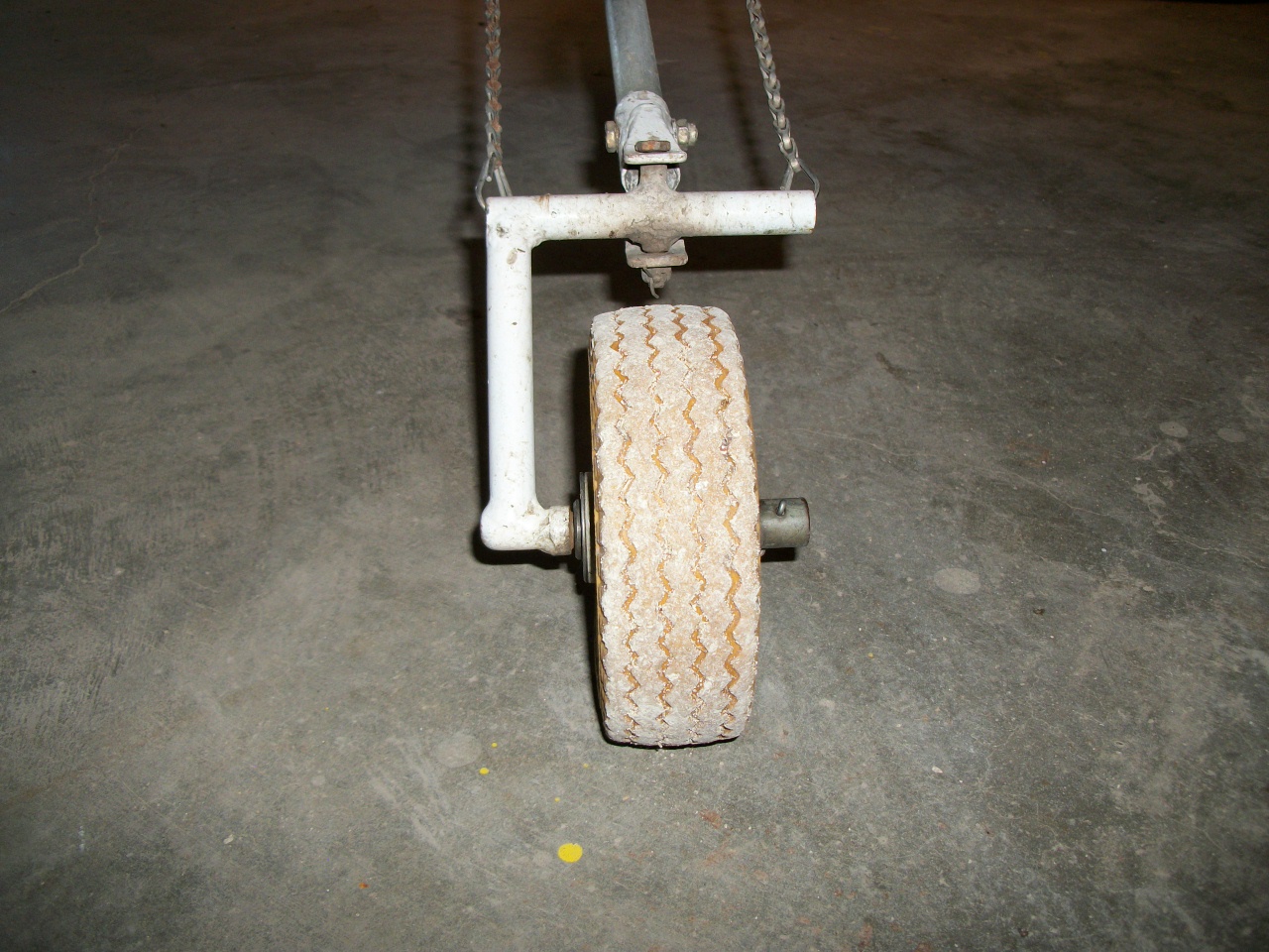

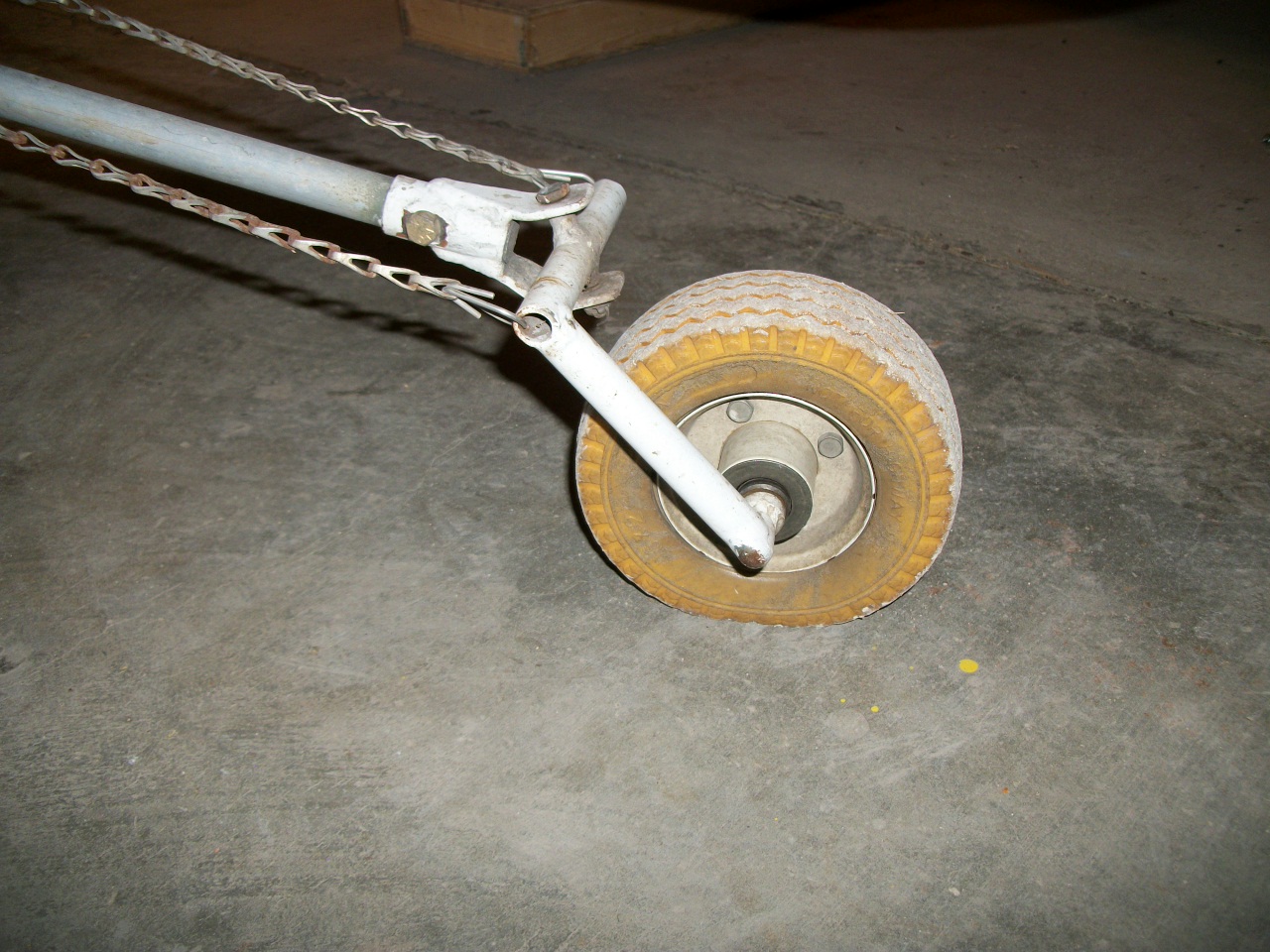

I wanted to check if any of you have modified your standard Kolb tail wheel to a pneumatic wheel/ tire.
Mahesh,
I did this on my Firestar. I bought a wheel at Tractor Supply that is soft rubber, about 5" dia., cost maybe $10, and had a guy weld up a wheel attach bracket that duplicated the original. I used to get stuck in pavement joints with the old "pie cutter" wheel when at an airport. This one has worked well for about 3 years now.
