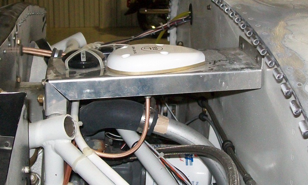

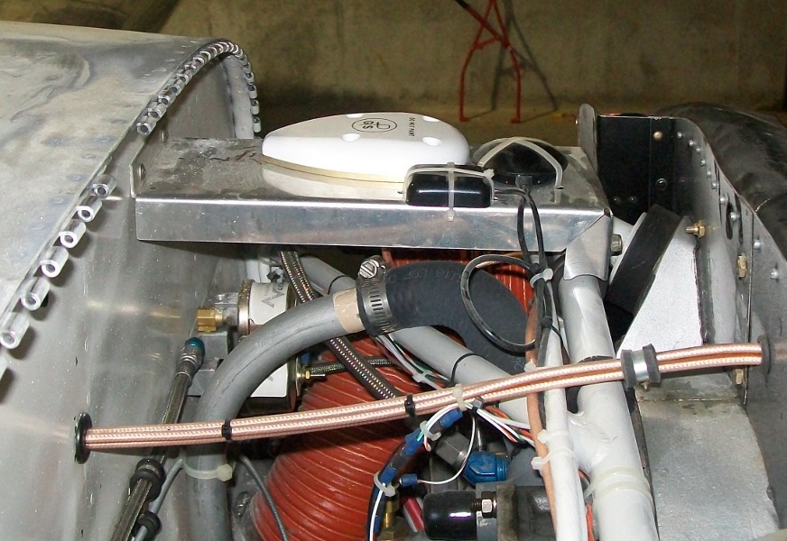

I see you all are determined to embed / mount the GPS antenna into the cabin.
Here is another solution.
I have mine under the cowl on a mounted plate attached to the firewall and the top of the engine mount.
Flying now with 200 hours and no issues.  I have access to them, they are easily inspected and
serviced if ever needed, and it a ton easier to do (no fiberglass or routing of cables up to the
cabin top).
I have the 430W GPS antenna, an XM weather antenna, and a stand-alone GPS receiver (49$ driving co-pilot
EFIS and AP).
Food for thought.
Jim Combs
N312F - Flying (again!)

> SparkChasers, KJNX). My thinking was 1) every source of advice has a
> bias 2) the performance of the 430W WAAS GPS being most important to
> me, 3) follow the avionics invested parties advice. So it's mounted
> on top of the cabin, right in the middle, far away from any possible
> interference, holes thru the cabin top, stuck out in the airstream.
> The are 3 or 4 other GPS antenna involved. Here I just tried to
> find good locations that should perform satisfactorily, provide easy
> installation/maintenance and be aesthetically pleasing. So 2 are
> mounted along upper rim of the windshield - a location that's worked
> well on my Maule. 1 or 2 are going to be velcroed to the glare
> shield. No holes, nothing sticking out, nothing being visually
> unpleasant.
Mauledriver(at)nc.rr.com
PostPosted: Fri Nov 26, 2010 3:31 pm    Post subject: GPS antenna location Reply with quote
No reason than just to get them up and out of the way. I didn't think
they would interfere with visibility (?).
As I recall, the question I answered with the one antenna on the glare
shield is "why did they use such a plug so big I couldn't string it thru
the center strut"?
On 11/26/2010 2:16 PM, Linn Walters wrote:
Bill, thanks for the pics. But they posed the question why you
mounted the small GPS antennas under the upper windscreen rather than
down on the glareshield??? Inquiring minds want to know.
Linn
On 11/26/2010 2:08 PM, Bill Watson wrote:
> I added some pics in my building log here:
> http://www.mykitlog.com/users/display_log.php?user=MauleDriver&project=224&category=4053&log=117562&row=2
> On 11/24/2010 2:35 PM, Bill Watson wrote:
>> I decided to optimize the mounting of the 430W antenna according to
>> the best avionics advice I could find. The installation manual
>> being first and and avionics shop owner second (Bill Betts,
>> a bias 2) the performance of the 430W WAAS GPS being most important
>> to me, 3) follow the avionics invested parties advice. So it's
>> mounted on top of the cabin, right in the middle, far away from any
>> possible interference, holes thru the cabin top, stuck out in the
>> airstream.
>> unpleasant.
