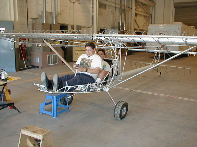

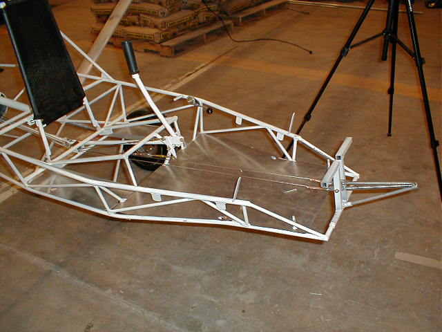

PostPosted: Thu Nov 25, 2010 8:04 am    Post subject: Kolb FS1 fuse floor Reply with quote
Greetings George,
The floor installed on each side of the pilot is used on the FireStar II, it is used for the rear passenger to put his/her feet.
[img]cid:tie_8CD5AD051C1BF1C_6C8_12EB8[/img]
[img]cid:tie_8CD5AD051C1BF1C_6C8_12EB9[/img]
