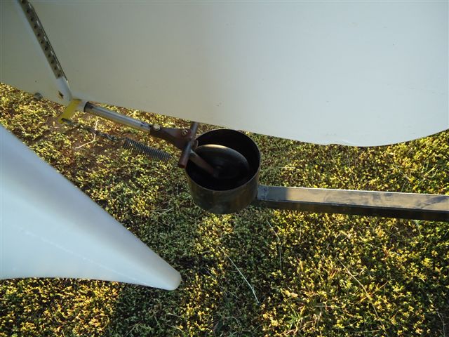

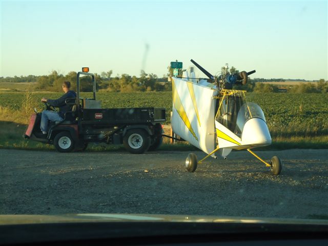

I'm looking into different ways of towing my Firestar a short distance to my local airport, about 6 miles, for its first test flight. Does anyone here see a downside to this technique ?

Dennis T/Folks:
I used similar method to haul my US and FS from home to my airstrip, 3
miles.
Major difference was a positive mechanical connection, rather than a
tailwheel sitting in a cup. At least that is how the photo looks to me.
I removed the tailwheel, used the tailwheel strut end fitting to attach to a
home made draw bar on my tractor. A 1/4 aircraft bolt and nut, used as a
pin, secured it to the draw bar.
Never had a problem.

PostPosted: Wed Dec 15, 2010 4:31 pm    Post subject: Kolb Firefly/ Firestar tug Reply with quote
I use to haul my Firestar about 6 miles 45/50 MPH all the time behind my pickup on its main gear I just secured the tail wheel so it couldnt get out of the mount I fabricated
Ellery Batchelder Jr.

PostPosted: Wed Dec 15, 2010 6:08 pm    Post subject: Re: Kolb Firefly/ Firestar tug Reply with quote
Painting the tailwheel assembly wouldn't hurt any.

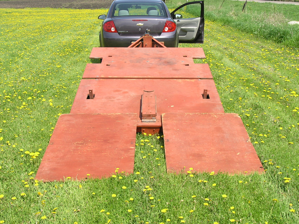

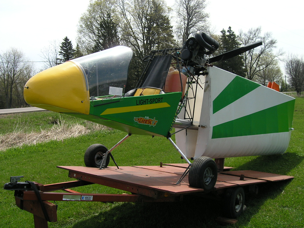

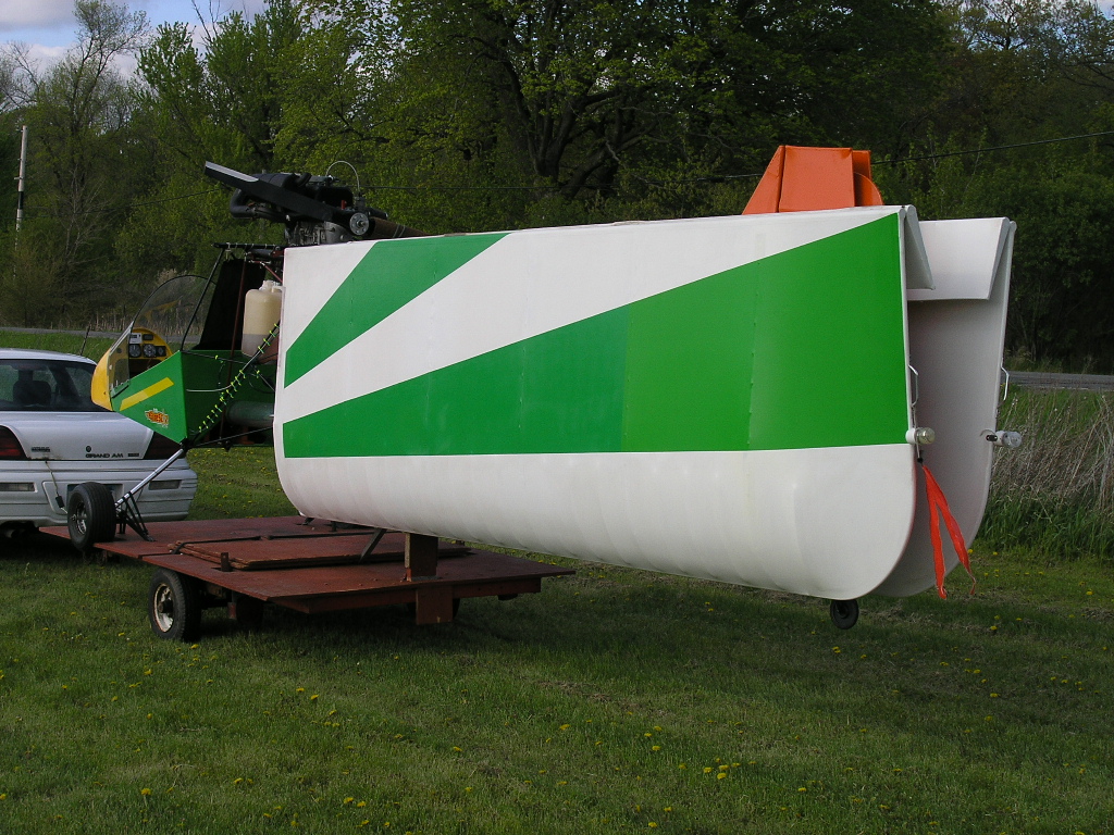

Another cheap way to haul the Firefly or Firestar ...
Ralph B
