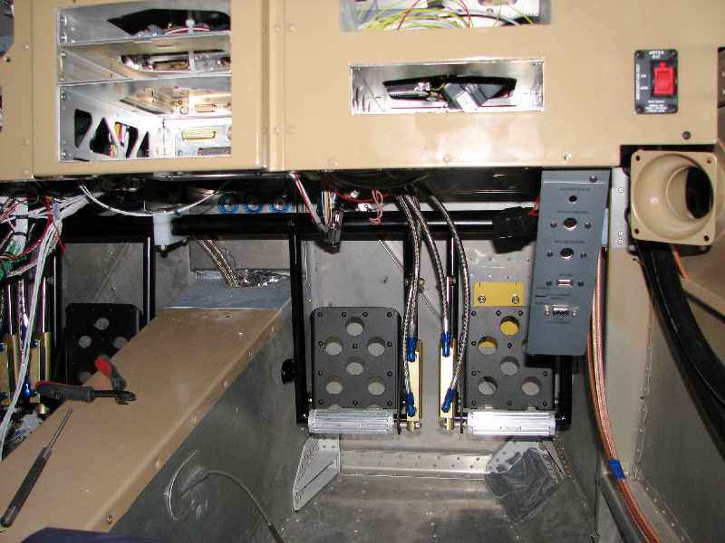

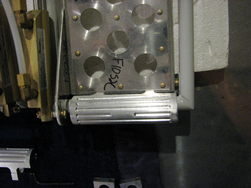

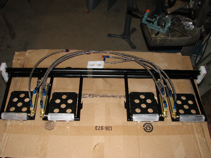

I've had the opportunity to fly RV-10's with and without rudder pedal extensions. I believe the rudder pedal extensions make staying off the brakes a whole lot easier. The angle of the pedals make it pretty hard to do without the extensions. This seems to be more true for taller pilots with bigger feet. I gave some transition training to a gentleman who purchased a flying RV-10 a couple of weeks ago. He was a big guy and had a real problem keeping his feet off the brakes. I am not sure, but suspect the rudder pedals were in the aft position on his airplane and that probably aggravated the problem. I installed the rudder pedal extensions from http://www.mlblueskunk.com/Rudder_pedal_Extensions.html and they are working great for me. There are other vendors selling similar extensions as well. I planned to change brake linings at my last condition inspection in December, but they were only about half worn at 300+ hours. I am going to take another look at them this week. Now that I am using my airplane for a little bit of Transition Training, I am sure the wear will accelerate.

I think those extensions probably aren't a bad idea if for
nothing else than as a training crutch to help prevent
someone from riding the brakes. You're right that especially
for tall people, and especially with the pedals in the aft
position, you can picture your foot that is always bent
back more than 90 degrees, just to make your foot sole
match the angle of the pedal. So having a little extra
bump out on the bottom bar is probably a good thing to help
keep your toes from hitting while your feet first touch.
If you notice on my rudder pedal blocks I made for andrea,
I added a piece of trim wood to put the bottoms out an
extra 1/4" or more too, just for that purpose.
I may actually give these pedal extensions a try. It's a bit
