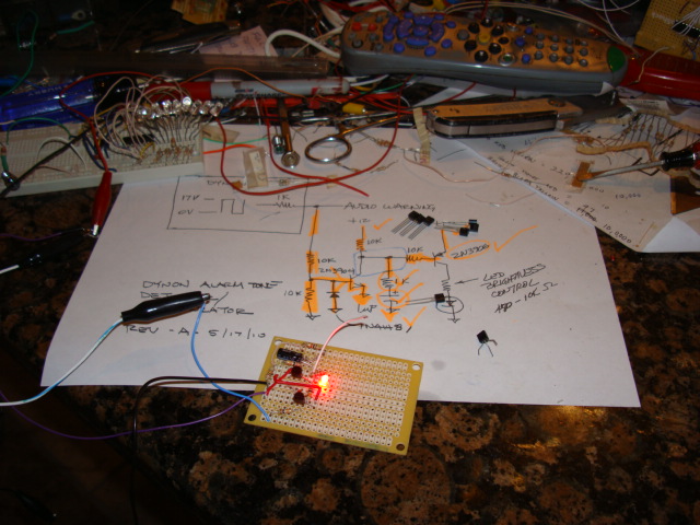

  Regarding the Dynon alarm detector circuit you designed, I have a
very easy question;  (your circuit is attached, to save you the trouble of
looking it up)
  First, some background.  As I mentioned awhile back, I intended to use
your circuit to power a "cascading LED circuit".  (this is a 10 LED
flashing circuit based on the 555 timer and the 4017 decade counter)
This would give a visual alarm, in addition to the standard Dynon audio
alarm.
  I built the entire combo circuit, where the Dynon alarm detector powers
the cascading LEDs upon activation.  Works great, look nice.  Exactly what
I had in mind.  However, I would like to verify during preflight inspection that
the alarm detector is "working" properly (waiting for a signal), although I
wouldn't know while on the ground .
  Here's the question;  Can I install an SPST switch between the "alarm signal
wire" and the +12V 'always hot' wire to the detector circuit?  On the breadboard,
this works just fine...but there is no Dynon hooked up to it, either.  I don't want to
assume I can start applying +12V to the Dynon alarm signal wire (while it is NOT
in alarm mode) and everything will be okay.  Do I need to protect the Dynon EFIS
in order to check the alarm circuit is operable?
  Would a diode be necessary upstream from the switch?  If so, which one.
What do you think?
  BTW, after building the Dynon alarm detector, I found out not just ANY NPN
transistors will do.  Evidently the PNP & NPN transistors are somewhat 'matched'.
It matters!!  I had a package of RShack "NPN" transistors.  For the record, BC546's
don't work!  (You can see it off to the right in the picture of my project)
  Here is a picture of the fully finished Dynon alarm detector circuit.  I installed
the single 3mm LED, and will leave it in.  The short white wire sends power to the
'yet to be built' LED circuit.  The completed and operable LED circuit is on the
breadboard, top left in the picture.  I salvaged some of the Dynon circuit parts
off the breadboard to build the finished circuit.  The purple wire is the +12V lead.
The light blue wire is the alarm signal.  Black is ground.  The black aligator clip
is providing power (artificial alarm signal) to the purple wire charged with +12V.
Works like a champ!!       I just need to allow for proper checking....
Thanks for your time,     Mike Welch
