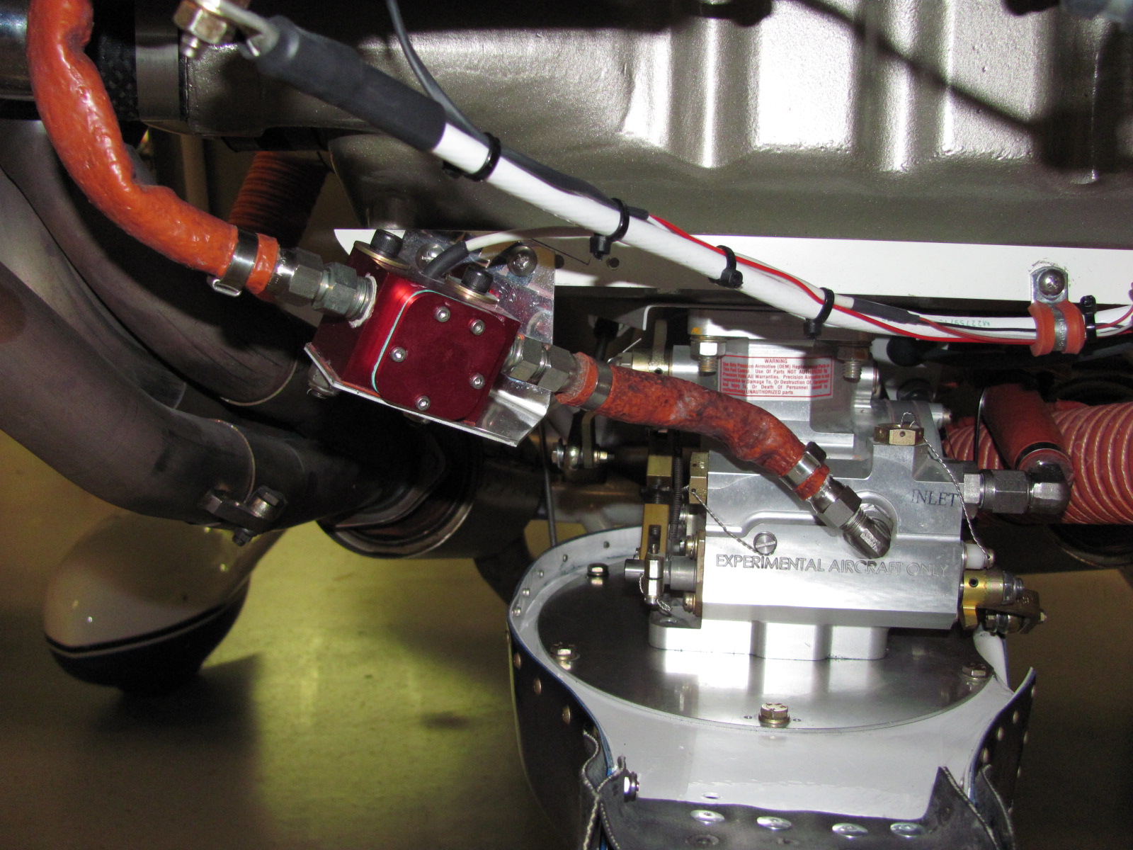

PostPosted: Sat Nov 20, 2010 8:09 am    Post subject: fuel flow transducer location Reply with quote
Here is were I mounted mine. 170 HRS and so far so good. I know other people have it here as well.
Geoff Combs

Just my thoughts.
Patrick Thyssen
--- On Sat, 11/20/10, Robin Marks <Robin(at)PaintTheWeb.com> wrote:
From: Robin Marks <Robin(at)PaintTheWeb.com>
Subject: RE: fuel flow transducer location
Date: Saturday, November 20, 2010, 8:48 AM
I mounted mine (not the red cube) in the tunnel with a nice long smooth lead in and out of the transducer and my readings were basically useless. Boost pump on added 3-5 gph with some bouncing. Boost pump off had 1-3 gph bouncing including low reading bouncing into the yellow that gave me low fuel flow warnings both in climb out and randomly in cruse flight. BTW this also threw off my fuel consumption/remaining fuel calculations. Not good! Furthermore the bouncing makes it impossible to balance ones fuel injectors as you cannot get accurate FF readings.
Finally fed up with the issue we relocated the transducer between the fuel servo and flow divider. Since then my readings have been rock solid and all low fuel pressure warnings + bouncing is gone. If building I would not waste my time placing the transducer in the tunnel again.
Sorry no photos.
Robin
From: [url=/mc/compose?to=owner-rv10-list-server(at)matronics.com]owner-rv10-list-server(at)matronics.com[/url] [mailto:[url=/mc/compose?to=owner-rv10-list-server(at)matronics.com]owner-rv10-list-server(at)matronics.com[/url]] On Behalf Of [url=/mc/compose?to=davidsoutpost(at)comcast.net]davidsoutpost(at)comcast.net[/url]
Sent: Saturday, November 20, 2010 5:26 AM
To: [url=/mc/compose?to=rv10-list(at)matronics.com]rv10-list(at)matronics.com[/url]
Subject: Re: fuel flow transducer location
I just finished mounting mine yesterday and used the EI red cube FT-60. I mounted it in the tunnel and have 6" straight line before and after the cube. I know it is between the electrical Andair pump and the mechanical pump but it is the recommendation location by Vans and I want less fuel fittings and lines in the engine compartment. I will move it if needed after the plane is flying. I will make up a new bypass fuel line while the tunnel is easily accessible just in case it needs to be moved.
David Clifford
