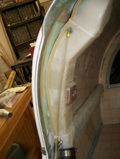

I reinforced fuse where the Cobra (fuel filler tube) is located.
I used Balsa under the Cobra with some thin foam wrapped with BID, it will be Reduxed to the fuse.
I think if the large fuel filler hose is loading the Cobra it is likely the cause of problems.
See:
http://www.europaowners.org/forums/gallery2.php?g2_itemId=27522
http://www.europaowners.org/forums/gallery2.php?g2_itemId=27346
http://www.europaowners.org/forums/gallery2.php?g2_itemId=27386
Ron Parigoris

I think there is a bit of information lacking here.
If you fix the filler to the fuselage as per the book there is a chance that
the skin of the aircraft will distort over time (it has on G-IANI and
G-IRON). This is very slight but can be seen in a glancing light. . Andy
Draper's recommended solution is to put at least one layer of BID on the
inner skin to spread the attachment loads over a wider area. Then attach
the filler as per the manual.
I have not tried it yet but I will do this on the repairs now being done on
G-IRON. Unfortunately I will not be able to say if it works for a year or
two as it takes this long for the distortion to appear.
Ian Rickard G-IANI XS Trigear, 300hours

I added a layer of carbon fiber to the filler area.
after a couple years now,I can see the attachment area from the outside in
the right light. I recall Bud Yerley posted a method that looked like it
would solve the problem...
Kevin N211KA

For the benefit of those who did not file it, Bud Yerly's method is copied below, together with his response to Graham Singleton's concern regarding protection from the build-up of static electricity when fuelling.
