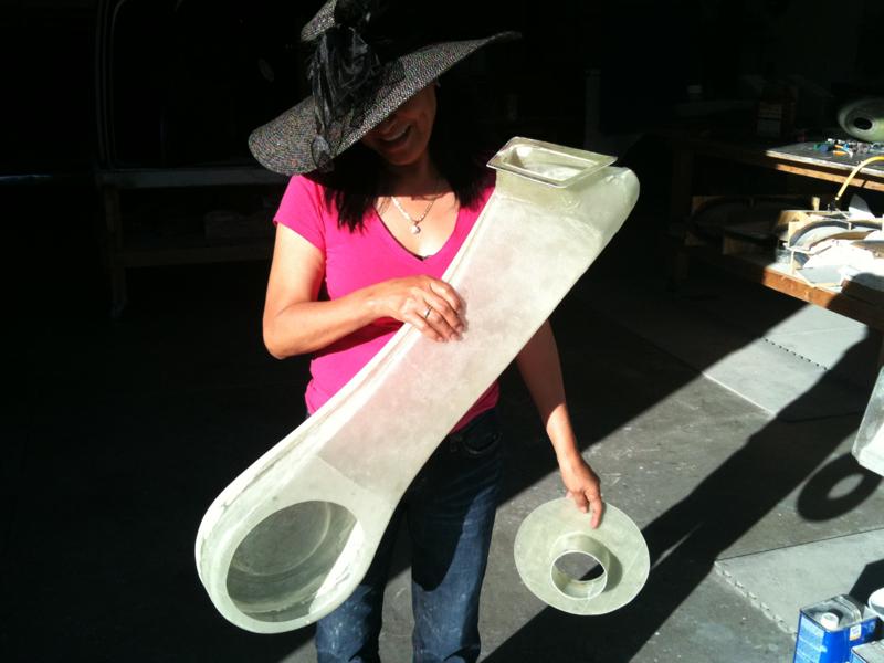

Hey Larry, heads up. This is for you .
I got the inlet installed today. Pretty easy actually. The air filter portion sits a bit lower than the airbox on the carb. Not a big deal. I'll be using the same black duct that goes on a real Tiger.
I ran into a clearance problem with the #2 exhaust riser. I thought about making the new air box only for planes with a Power Flow but didn't bare listening to all the whining. More to come.

Gary, do you have a photo of the duct installed on the plane?
teamgrumman(at)yahoo.com
PostPosted: Thu Nov 18, 2010 11:23 am    Post subject: New inlet on AG5B Reply with quote
I do. But, I had to cut a notch in it to get it to fit around #2 riser and I'd rather not send out the notched picture.

Hey Gary
I'd be interested to see what had to be done to the front baffle. As we discussed when I looked into doing this I think my #2 PF exhaust (the AG5B prototype) makes it even tighter than the newer ones....just added to the reasons I went for the Jag....
