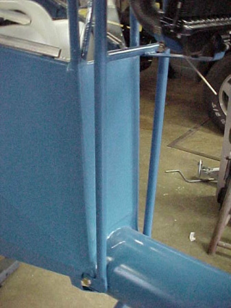

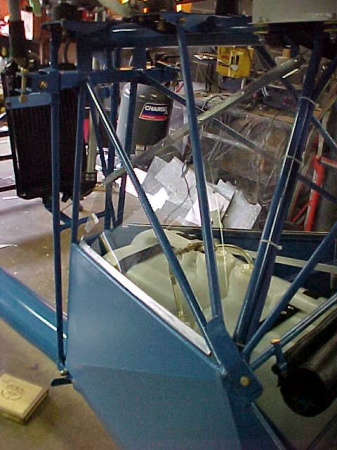

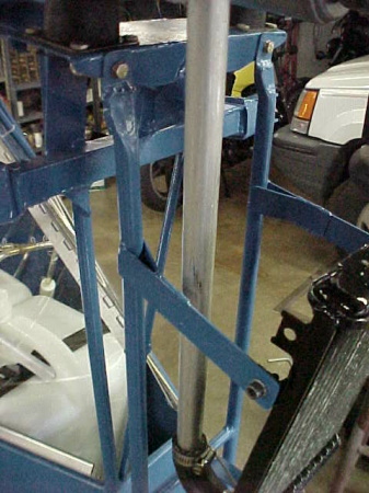

PostPosted: Wed Nov 17, 2010 1:56 pm    Post subject: Re: cracked rear spar tube firestar Reply with quote
I agree that the factory wil probably come up with the best solution for the HKS installation. When we put the 582 on the FSII, the factory felt that it was too much torque for the FSII upper fuselage structure, so we added some external reinforcements to take the torque loads.
This is probably overkill, but on the other hand, this was one of the few portions of the fuselage structure that did not get distorted in the crash...
More info here: http://www.bcchapel.org/pages/0003/582%20Mods.html
