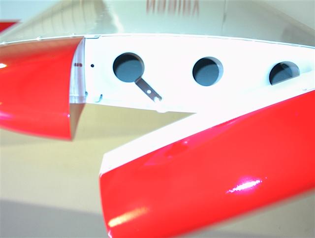

Over the weekend I found that the RV10 rudder stop on the right side has broken, the rivets had been sheared. The rudder stop was laying in the bottom of the rudder. When this has happened to others, have you simply riveted it back on, or replaced rivets with #8 or #6 bolts, or is there an after market replacement???

You can use screws to hold the stops in position.  They'll hold up much better in shear.
Van's even made that change on their demo planes.  If you look closely you'll see they've changed them all to screws.

I've heard of people doing it both ways...some have used
Rivets and some have used screws. My only thought is
that if you do indeed replace the rivets with something,
you may actually not want to replace it with something
too strong. If you make it too strong, the forces may
be transferred to other parts, and you may end up
breaking something else. Ultimately, the way to
prevent the problem is to make sure to always use a
rudder gust lock, and make sure that the one you use
is strong enough to withstand whatever is thrown at it.

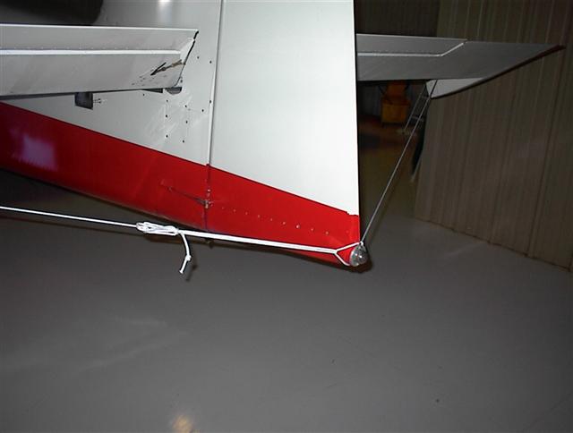

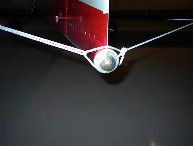

PostPosted: Mon Nov 15, 2010 9:17 pm    Post subject: rudder stop Reply with quote
This one is cheap and effective. Easy to install and store away.
Albert Gardner
N991RV
Yuma, AZ

On Nov 16, 2010, at 3:53 PM, Dave Saylor <dave.saylor.aircrafters(at)gmail.com> wrote:
I been using this one for a while (scroll down to the tow bar pictures):
http://forums.matronics.com/viewtopic.php?p=300884#300884
It's nice to be able to put the gust lock in while standing outside on
the ground. Plus no other gizmos to haul around.
Dave Saylor
AirCrafters
140 Aviation Way
Watsonville, CA 95076
831-722-9141 Shop
831-750-0284 Cell
On Mon, Nov 15, 2010 at 7:47 PM, Jim Berry <jimberry(at)qwest.net> wrote:
> Does anyone have a bomb-proof rudder lock that they are really happy with?
> Jim Berry
> N15JB
> Phase 1
> http://forums.matronics.com/viewtopic.php?p=319535#319535

PostPosted: Tue Nov 16, 2010 4:20 pm    Post subject: rudder stop Reply with quote
>use the seatbelt on the other side to hold it back<<
Yep, that's basically what I did before the bungee. Now I can lock
all the controls in one motion. Probably not a big deal but it does
seem easier now and that makes it a little more likely that I'll
actually use it.
Dave Saylor
AirCrafters
140 Aviation Way
831-722-9141 Shop
831-750-0284 Cell
On Tue, Nov 16, 2010 at 1:17 PM, Jesse Saint <jesse(at)saintaviation.com> wrote:
That's very similar to my mod.  I just use a tube that will fit in a hole on the pedals.  I also usually put the stick through the hole in the towbar then use the seatbelt on the other side to hold it back, which locks the elevator & ailerons.
Jesse Saint
I-TEC, Inc.
jesse(at)itecusa.org
www.itecusa.org
www.mavericklsa.com
C: 352-427-0285
O: 352-465-4545
F: 815-377-3694
> Dave Saylor
> AirCrafters
> 140 Aviation Way
> 831-722-9141 Shop
> 831-750-0284 Cell
>> Jim Berry
>> N15JB
>> Phase 1
