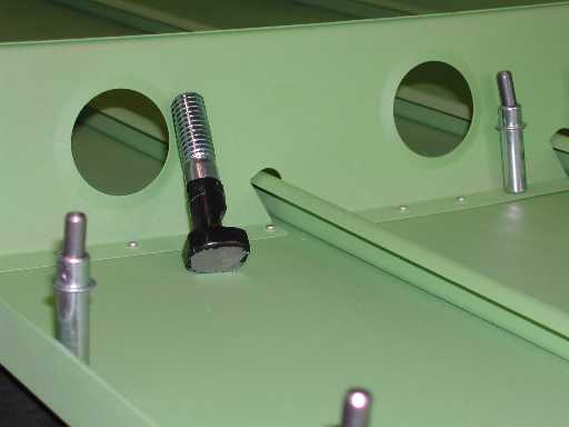

There is no rocket science to building the TC.  I back rivetted all the bottom and side skins solo.  Careful positioning of the back rivet plate and judicious use of some wooden wedges to position the TC is all I used.  It obviously took much longer solo than with a partner - but it can be done.  I only used a partner to help with the top skin and I am delighted with the way the whole thing came out.
The only gotchas I can think of:
a.      some rivets will require an offset back rivet set as John G. has pointed out.
b.      check that the bulkhead flanges lay flat against the skin - back riveting helps this automatically (if you use the spring/collar back rivet set).  Otherwise use the eraser trick I posted the other day to snug the flange to the skin
c.      it is possible to backrivet those rivets that sit under the J Channel.  I used a hardware store hex head bolt with the head polished and part of the bolt shaft ground out.  With the rivet backed on the plate, hit the bolt firmly with a solid hammer a few times for a perfect rivet.  Picture attached.
good luck
Ron

What a great idea for driving those specific rivets!  Innovation at its best.  Thanks, Ron and John G.

Some of the innovation ($time$) may have been used elsewhere.  Unless my backrivet set is directly on the rivet, the rivet will slide to one side of the nylon insert and only set half the diameter of the rivet, which looks kinda weird!  I just began using my non-swivel mushroom set for my back riveting.  With the larger surface area it’s not really any harder to keep the set on the rivet, and it fits wonderfully under J channels.
Rob
