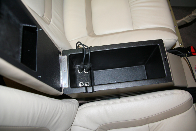

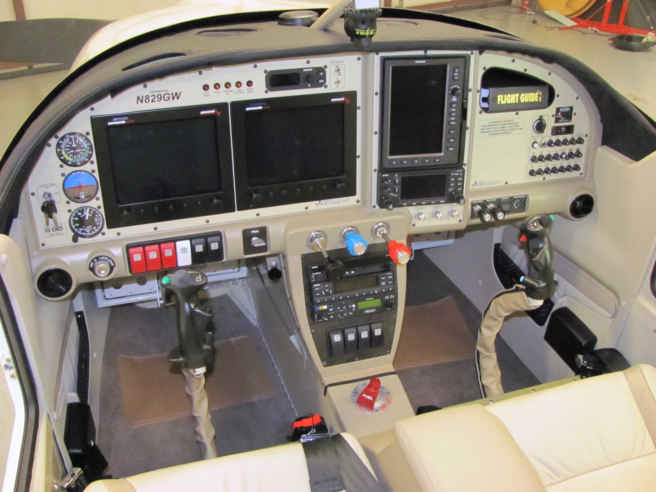

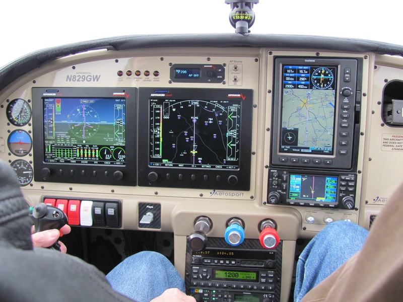

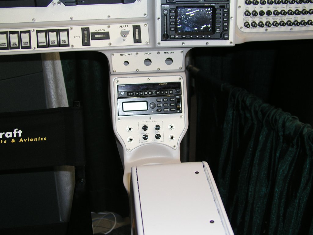

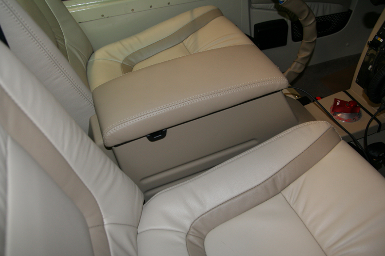

I have to chime in here on the lower center console and center arm rest people are talking about. Some older center consoles were not as ergonomic or
pilot friendly as what Aerosport's lower console is. We did many prototypes to get as little intrusion as possible in the pilot and copilot side. I think we changed
the shape 4-5 times before we were happy with the comfort and able to get 6.25" wide radio stack items installed. I have attached a couple pictures of older
center consoles that were very intrusive and maybe a little uncomfortable for some. Also my aircraft. That being said I have flown 9 hrs days in my 10 and have never once thought that
this was in the way. I have plenty of room to move my legs and not feel pinned in. That being said everyone is different in body size and build. Some
people who are much taller or use up more useful load might be more uncomfortable than others. That being said I have had 6'6" people in my airplane and they
have had no problems with the center console. As for the difficulty of removing for annual inspection that is more a lack of proper planning than it is the center consoles
fault. If you are going to put one in, plan accordingly and make it so you can remove and get to you fuel filter. That thing in a big pain in the butt with or without
a lower center console. You must make it removable. I just finished my annual and I had no problems getting to my filter. I did remove the center console.
I did put a door on the side of the tunnel which is a must in my opinion.
As for the center arm rest that is a personal choice. I love having it and would not remove it. I have flown in 10's without it and I always thought it would be nice to
have that arm rest. That is my opinion. I love having the storage space to put glasses and phone in and what ever else might fit. The console is maybe 1/4" wider the the
tunnel. As said earlier people with a larger body sizes might have a problem with this center arm rest and they should not install them. You must build your airplane
to suit your needs. That is why you are building and not buying.
If you like it put it in. It will still be better than any other certified aircraft because you built it for you.
