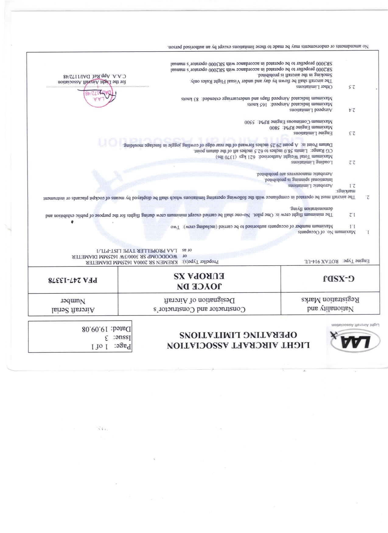

PostPosted: Fri Nov 05, 2010 1:37 am    Post subject: Woodcomp SR2000 Reply with quote
Alain, I attach a copy of my LAA Permit on which you will see that a
Woodcomp SR2000 or SR 3000 is approved, which may be enough for your
purposes. Regards, David Joyce

alainchabert(at)wanadoo.f
PostPosted: Sat Nov 06, 2010 10:54 am    Post subject: Woodcomp SR2000 Reply with quote
Ian and David
Thank you for your prompt reply.
I sent my application with a copy of the LAA permit, and I expect feedback.
I would not fail to keep you informed
