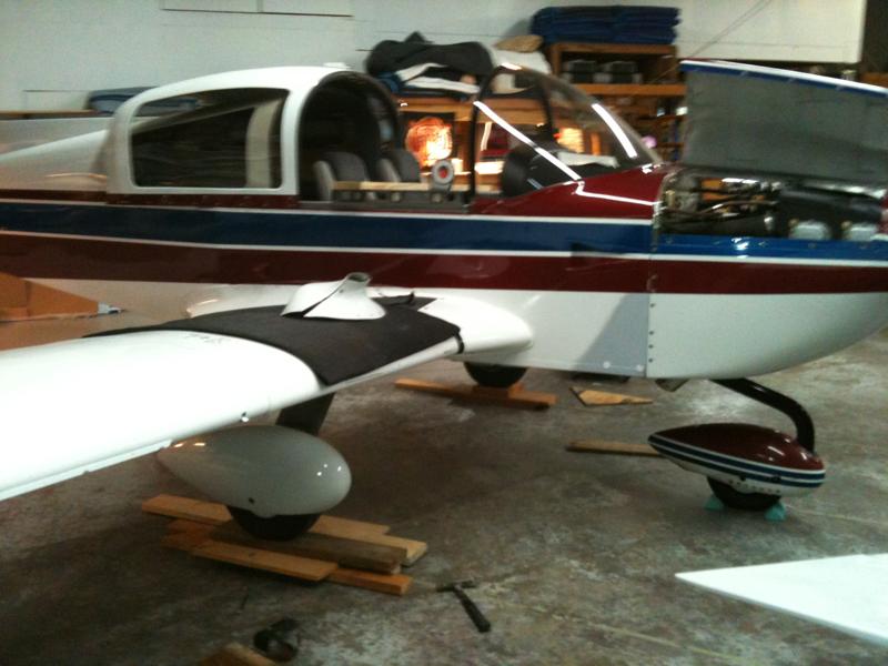

PostPosted: Fri Nov 05, 2010 8:29 pm    Post subject: Engine Thrust Angle: Page two. Leveling the plane Reply with quote

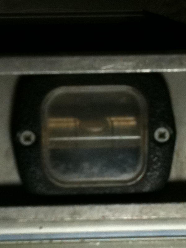

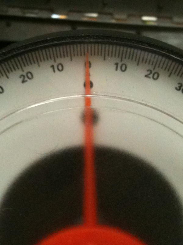

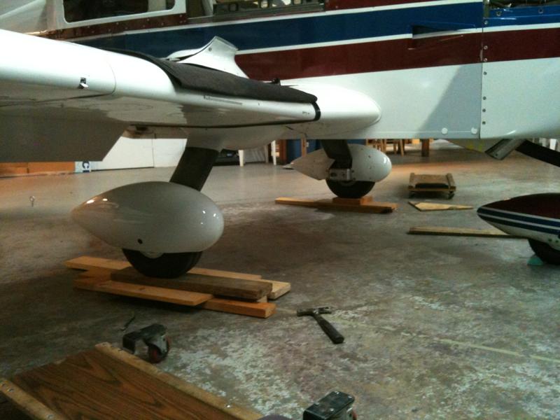

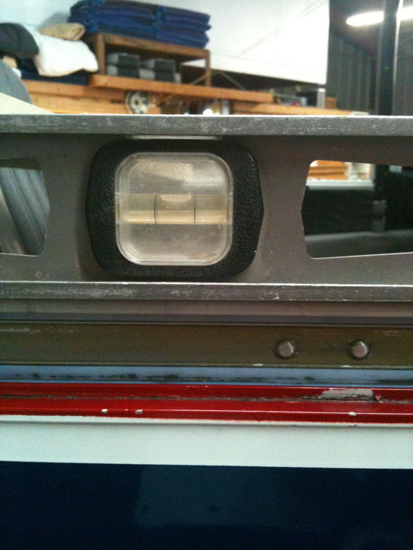

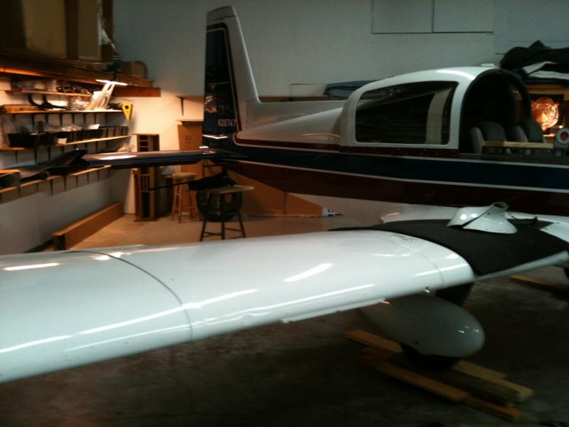

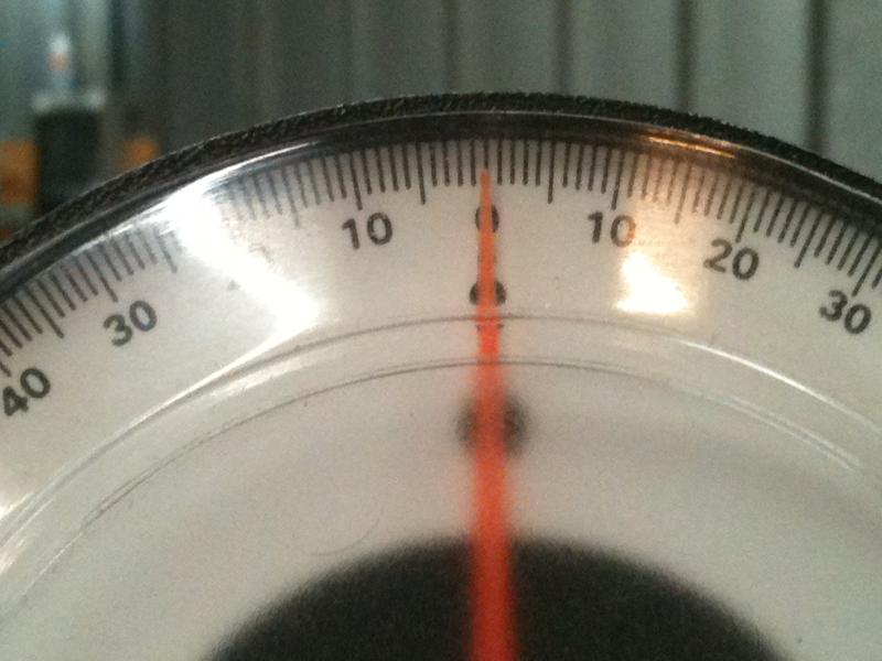

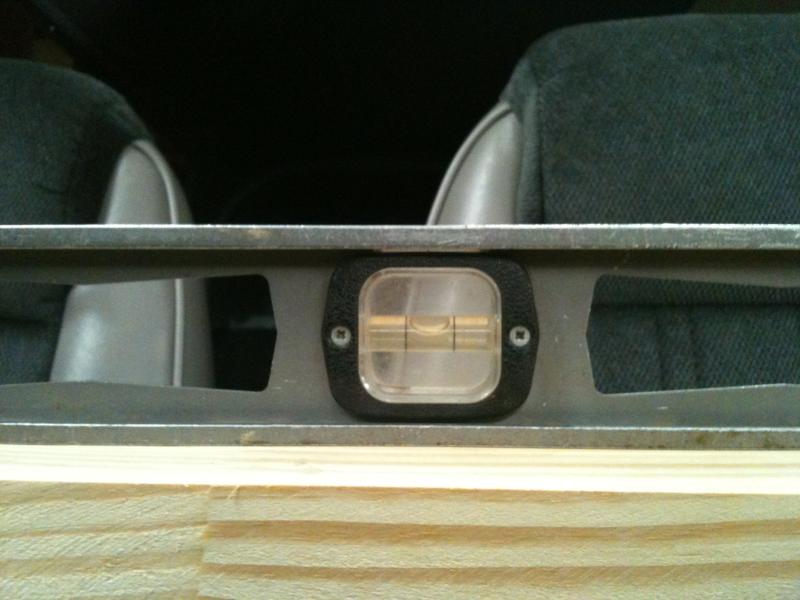

I leveled my plane today. Not a simple feat. Turns out, I needed about 4 inches under the main gear plus a jack under the tail tie down to lift it an additional 3 inches. Then, I removed air from the right tire to level it side-to-side.
