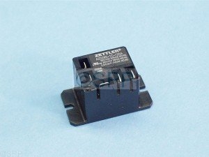

The "S704" is a catalog number for a "T91" style
SPDT relay first defined by Potter-Brumfield as
I recall . . . and later 'cloned' by many others
as popularity of this device soared.

But it's nothing special. Any 12v, 30A, DPDT
relay will do the same job . . . including

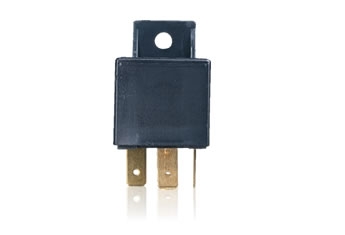

this device from Radio Shack
[img]cid:.1[/img]
Catalog #275-226. Many of the BigBox auto parts
stores sell similar devices in peg-racked blister-
paks. It might be called a "headlight relay".

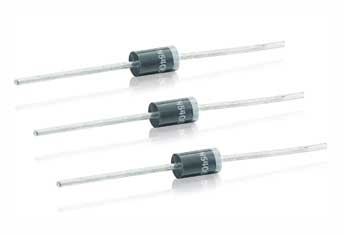

Whew!!!! just noted that this part sells for
about $10. Go get your own 1N5402, 75-cent
critters from R-S . . .
